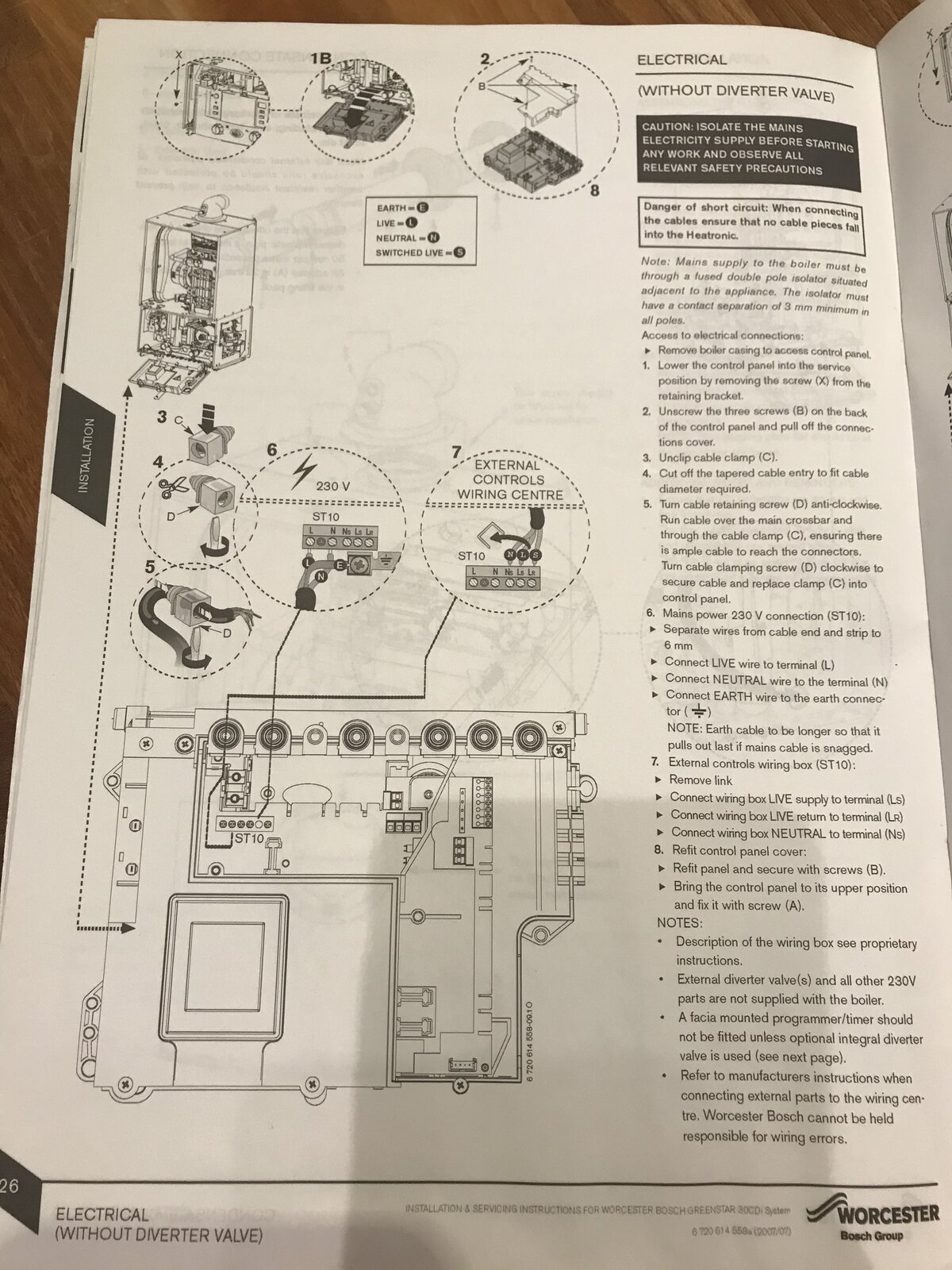

I will need to open up the boiler later to check but attached is the diagram in the manual which I’m basing my understanding on

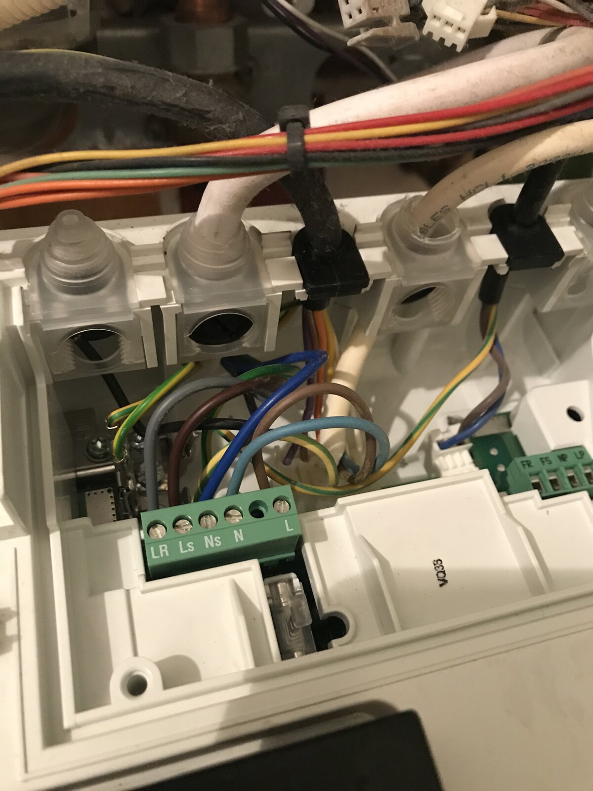

Ok attached.
Mains supply goes into a 3amp socket in the wall next to the boiler.
The LR, LS and NR go into the wall, with the LR and NR forming live and neutral in the controller and the LS joining the red wire up to the circuit box.

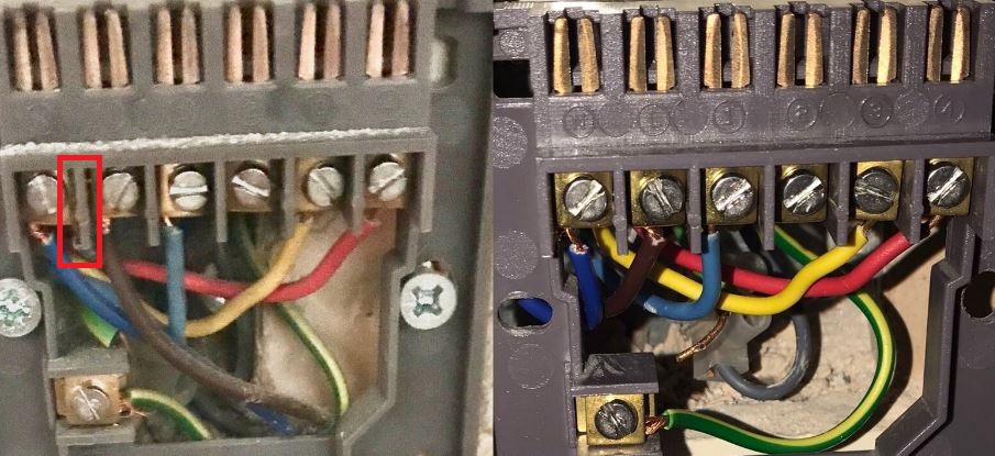

So as I see it:
1. You have tested with a multimeter between the motorised valve's white and blue wires when the Nest has the central heating switched 'on' and is calling for heat. The result is 0V
2. You have tested with a multimeter between the motorised valve's white and earth wires when the Nest has the central heating switched 'on' and is calling for heat. The result is 230V
As @ianmcd pointed out, that shows that the Nest is providing a live supply to the motorised valve, so the Nest is good. However the neutral is missing. Therefore you need to trace the neutral wire from the motorised valve back and find out where the connection has failed.
If the 'spare' blue wire behind the Altech was not connected to anything before when the system was working it won't be the neutral. The fact that it is 'live' worries me and should be investigated. For now at least insulate it and tuck it safely out of the way.
There are several blue wires at the Altech, two connected to it and one not. Is there any possibility that you have got them mixed up when you transferred them to the Nest? That 'spare' wire certainly looks as if it has been connected to something at sometime.
Would you be able to tell us what is actually connected to the other end of each of the 3 blue wires?
Edit.
@ianmcd replied whilst I was typing.
In fact. On closer inspection.....Spot the difference in your before and after photographs. To make it easier, I've highlighted it for you. If you look carefully, there appears to be a second blue wire in the N terminal in the first photo.....
......so before reconnecting it anywhere, you just have to sort out which blue is which. But don't guess, get it wrong and it could cause problems. You are probably going to have to trace them back to their origin.

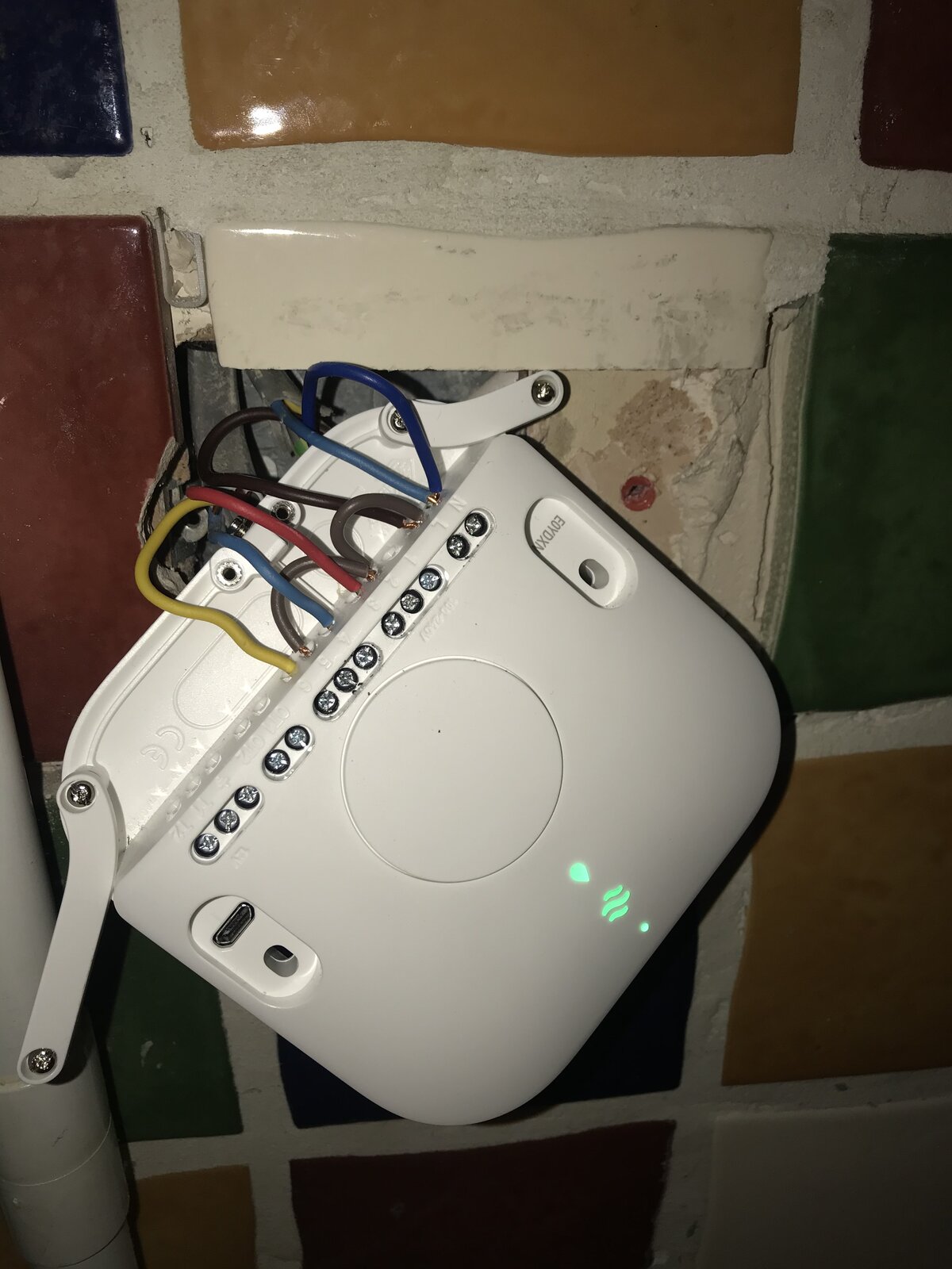

Well blow me down this seems to have worked... loose wire seems to be the missing neutral and needed to join the neutral going into the nest...
Just going to test it a few times and will report back.

Both - thanks very much for your help pleased to say all now operating correctly. I will buy you a virtual pint
needs a fair bit of tidy up and link off the old thermostat in the circuit box - will post in a few days once I’ve sorted.
