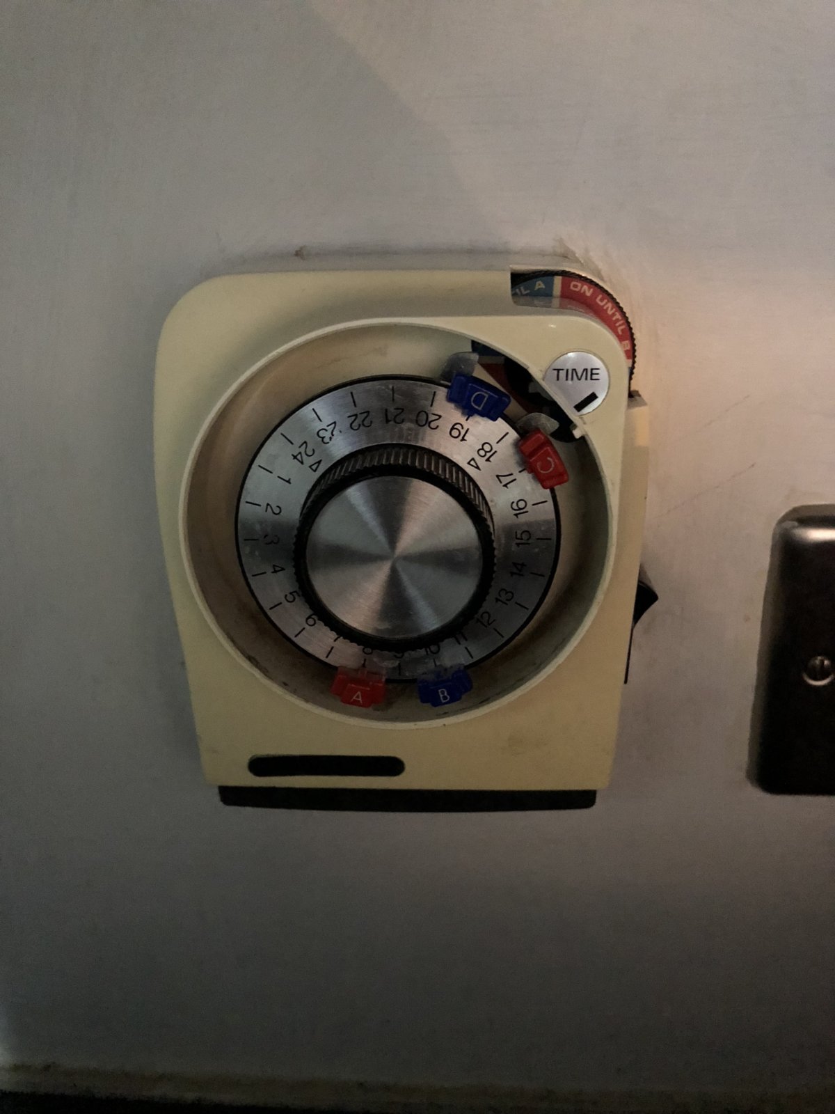

Absolute and utter amateur here, pretty clueless when comes to plumbing and heating, need to learn! Moved in to my house about a year ago and at the moment we don't have a thermostat at all, we have a late 90s Glow Worm boiler and a immersion tank in the airing cupboard and only an old crude analog controller for turning on the heating and hot water - see attached image.

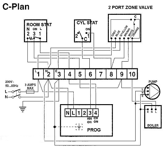

Below is a wiring diagram for a C-Plan heating system. As you will see there are room and cylinder thermostats plus a motorised valve to control the hot water. With a C -Plan, the 2-port valve is controlled by a thermostat on the hot water cylinder to allow the facility to have the heating 'on' without the hot water being 'on'. The valve is not the cause of the restriction as you suggest, in fact just the opposite, it's there to allow independent control of the central heating, without the hot water operating at the same time.

If you do have a genuine 'C-Plan' with a cylinder thermostat and a suitable 2-port motorised valve, wired as above, then Nest will work with it OK.

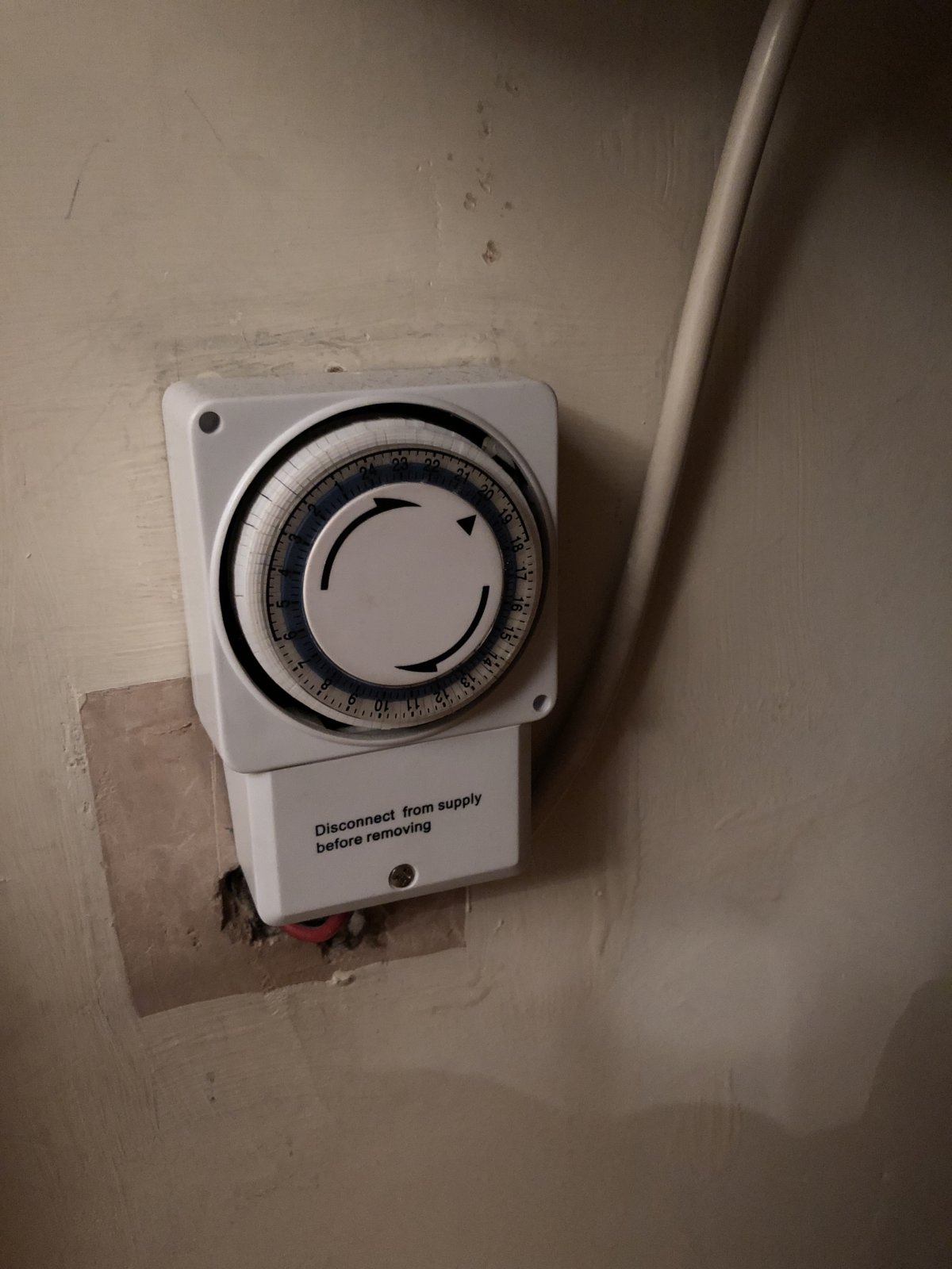

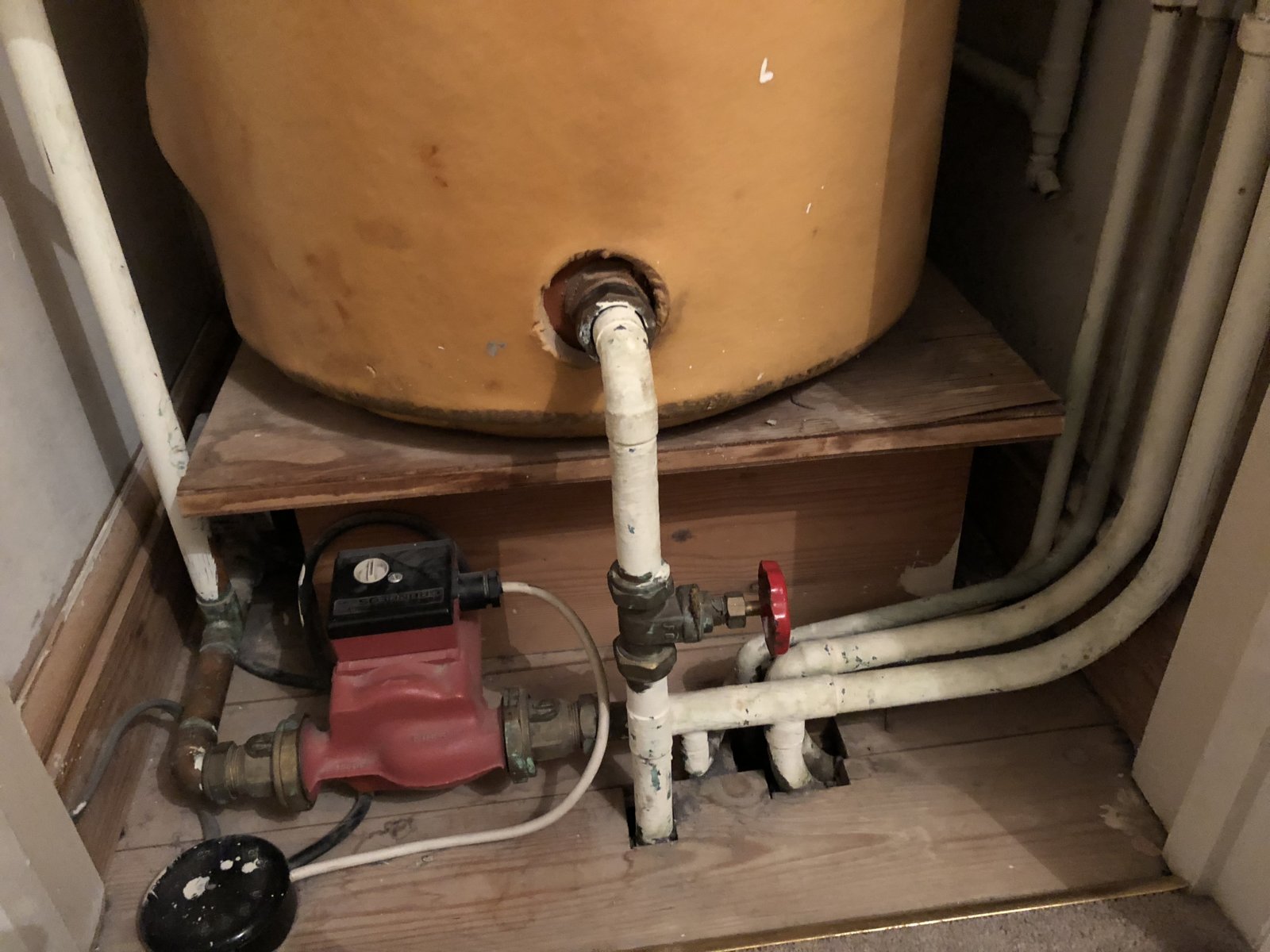

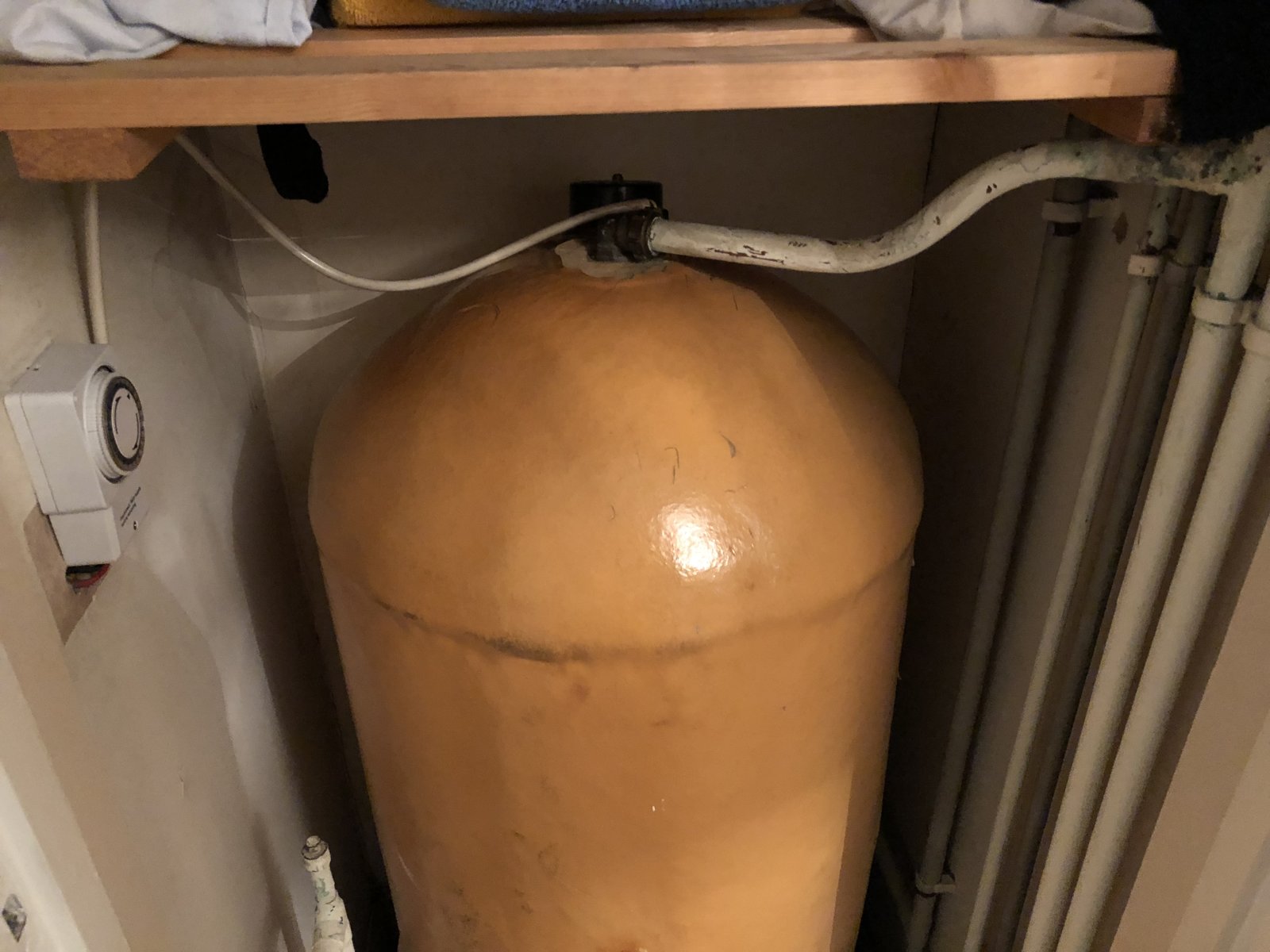

I think we do have have a hot water cylinder thermostat - this is it right next to the cylinder in the airing cupboard? See attached. If this is the case, why have I been told that the nest thermostat won’t work?

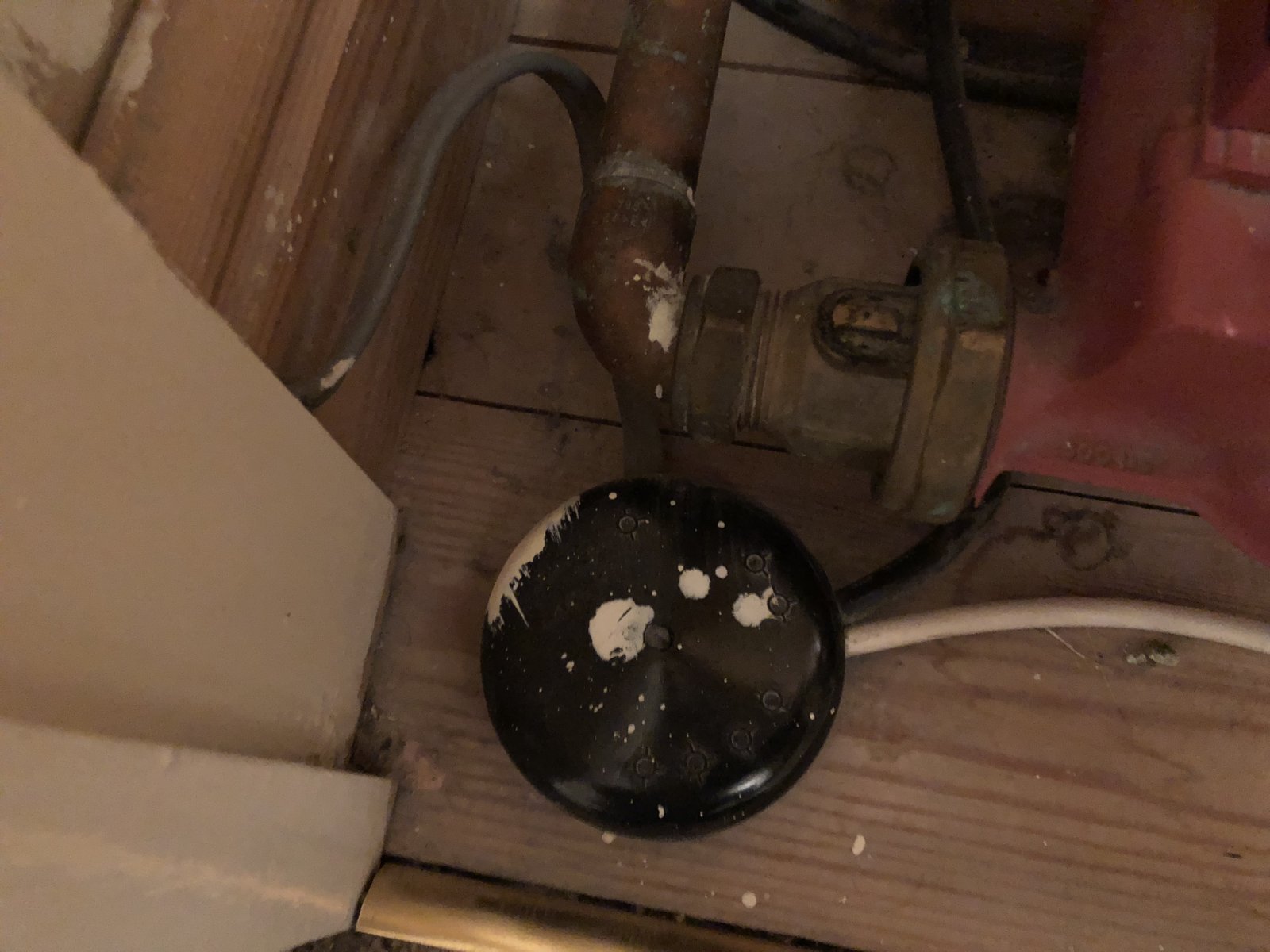

See pic of valve attached also (at least I think it’s the valve!)
64EE9691-48DF-4533-8A84-2B4114078C88.jpeg 68961A70-0AE1-4BCB-BF91-069CE9FD2259.jpeg
The photos shows a timeswitch that is connected to an electric immersion heating element fitted inside the hot water cylinder, these are not connected in anyway to the boiler.
As an illustration, in your lounge, there will likely be a radiator connected to the central heating to heat the room. If you were to bring in an electric fire and plug it in, it would also heat the room, but it is in no way connected to the central heating. It is totally separate.
The same is true with the hot water cylinder, it is connected to the boiler and the boiler will heat the hot water inside it, but the electric immersion heater, whilst it will also heat the hot water, like the electric fire, it is not connected to the boiler in anyway, it is totally separate.

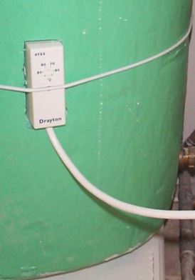

A hot water cylinder thermostat of the type used in conjunction with a boiler looks like this. It is strapped to the cylinder about one third of the way up from the bottom. I don't see one in your photo.

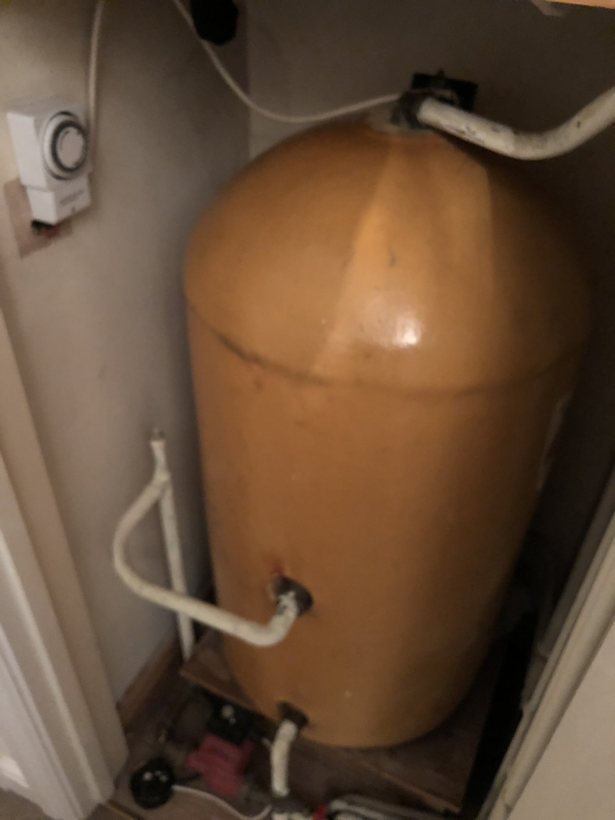

@stem yeah, there is no hot water cylinder thermostat like in the picture you posted.

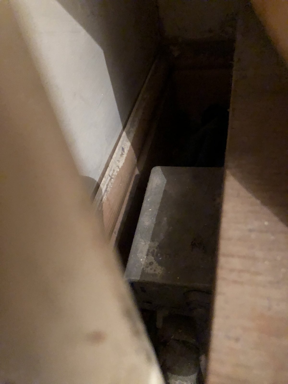

I was told that our valve was only 2 way - I don’t know for sure myself. Is it one of these?
3C00A2F4-27E3-4A9C-A9CE-4C0161CDC538.jpeg 2F4CB341-B41B-4C60-A9B7-1D919818ED84.jpeg D9BD0FFD-0C48-4188-AE1A-D49B8C3409A1.jpeg
A 2 port motorised zone valve is visible in the middle picture.
It's a Honeywell, like the one below.
But from the photos it's impossible for me to see what it's connected to, or indeed what is actually controlling it.
With a C Plan, it should be wired to a cylinder thermostat as per the picture in my previous post and normally fitted in the top (flow) pipe to the hot water cylinder like this. It is possible, but not usual to fit it in the bottom (return) pipe.
Unfortunately, I can't see enough details from your photos to see how the pipes are connected to the pump, boiler, cylinder and motorised valve to ascertain what's actually going on.

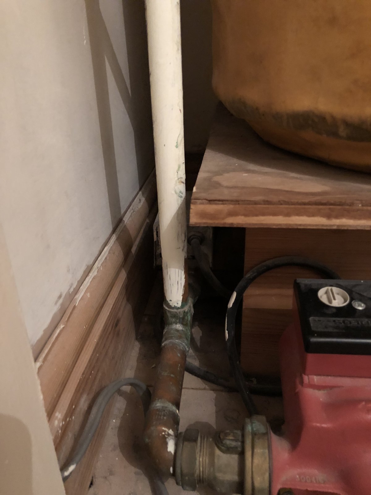

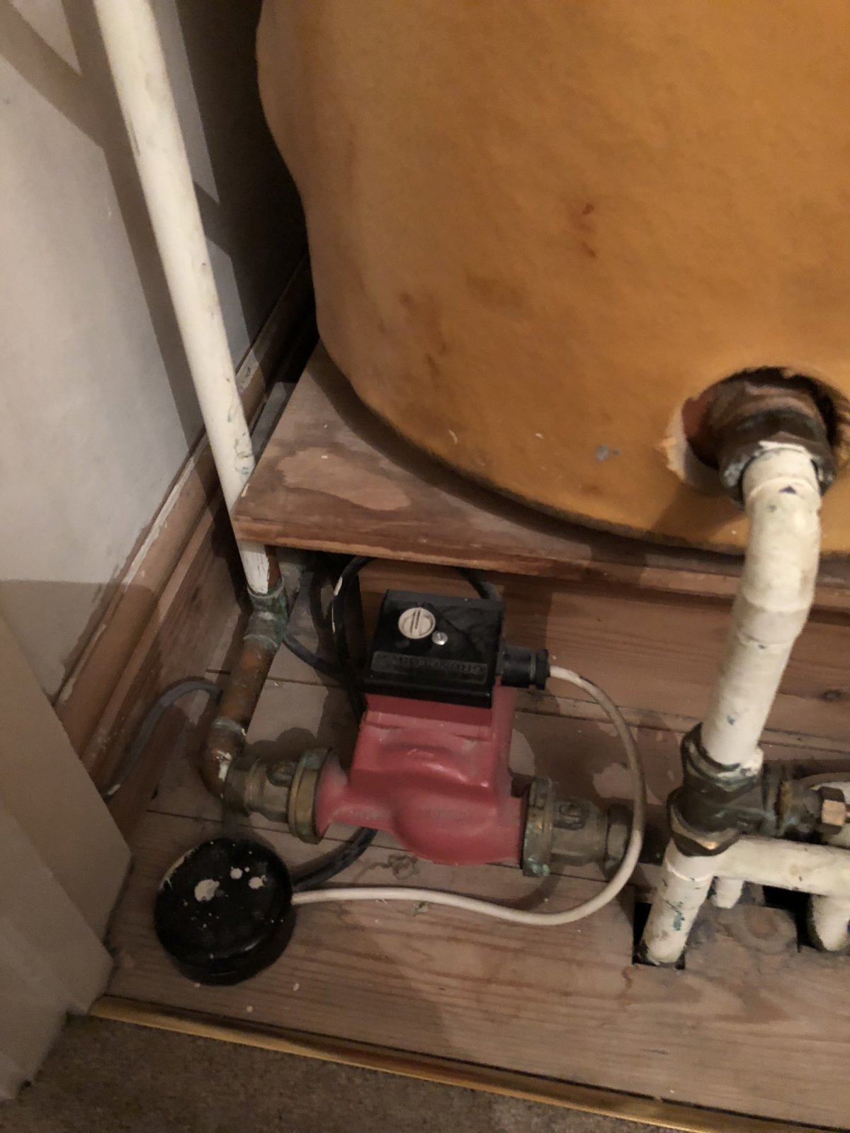

@stem amazing info - thanks. From what I can see there definitely isn’t a cylinder thermostat anywhere unless it’s on the back of the cylinder out of view which wouldn’t make sense right?

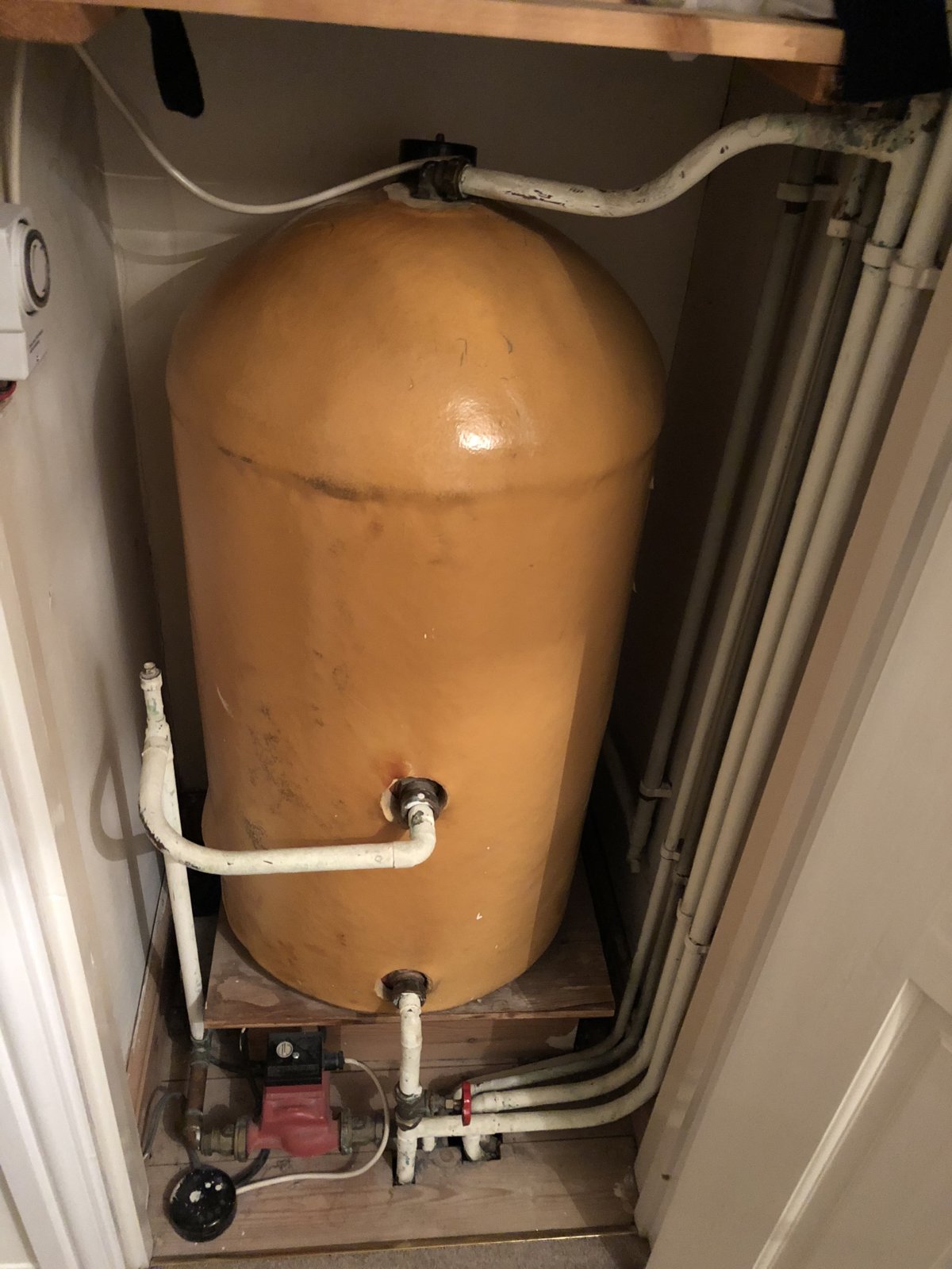

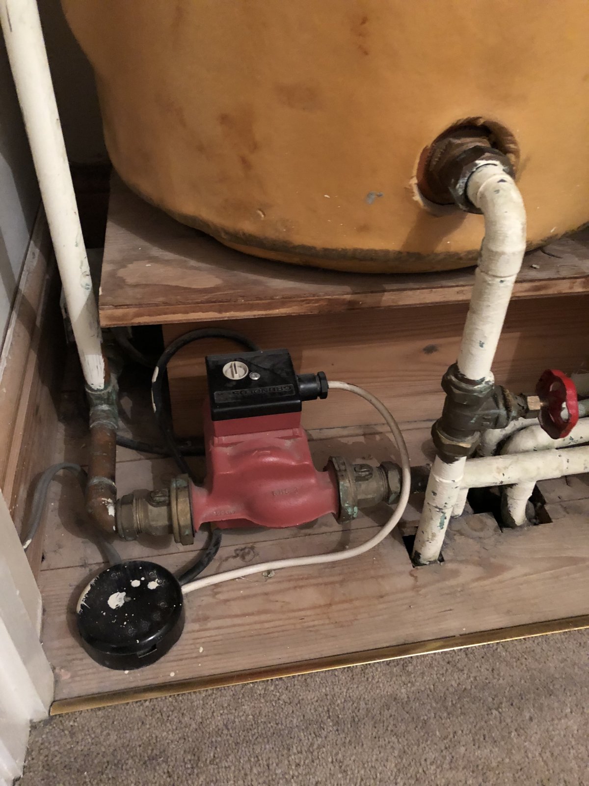

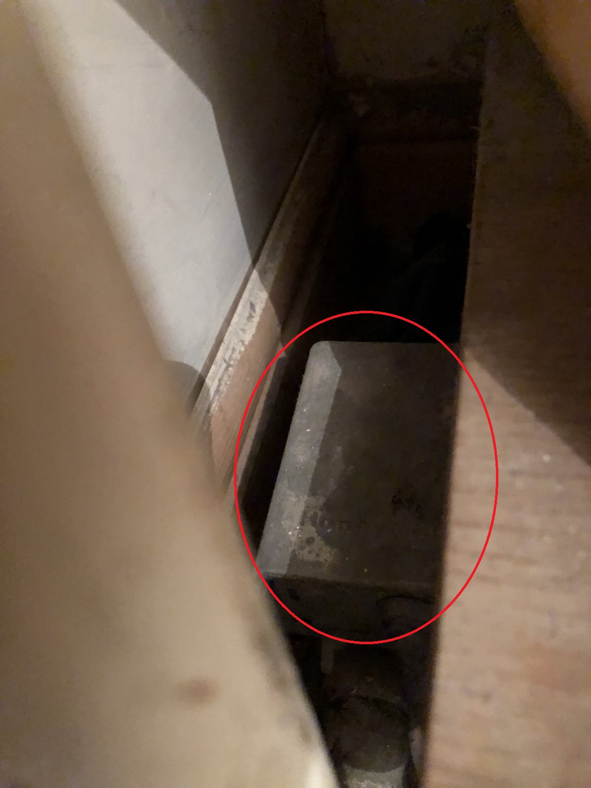

I’ve attached some more photos in case they help - I doubt they will though. I can’t see where the connection from the valve is going to, it’s goes underneath the cylinder.
Just to be clear, at the moment I just want to use the Nest stat the same as we do the old controller, so heating and hot water on at same time or just hot water in its own. We just need a thermostat downstairs to turn heating on or off automatically depending on room temperature and we want to have an on/off schedule and option to turn on/off from phones remotely. That’s it.

The system you have is fully pumped.
The ‘C’ plan uses gravity fed primaries (HW) with pumped heating.
The motorised valve must also be installed in a position so as to leave an unrestricted path for the open safety vent.

Yes if you really must. You will be able to use a Nest to control it. If it is gravity hot water system without any thermostatic control, you won't get all of the functions Nest can provide and you keep the inefficient system that you have. Personally I would convert it to a Y-Plan and forgo the Nest, but it's your choice.
As Wildcat1961 says it doesn't look like a C-Plan, it looks like a gravity hot water system with pumped central heating......except but the problem I have is what is the motorised valve doing? and what's operating it? Motorised valves are usually operated by a thermostat, so where is the thermostat? Perhaps it was connected to one in the past, who knows? This will still need to be bottomed before fitting the Nest.
As the motorised valve is in the pipe from the pump it may actually be in the central heating circuit. It seems to be connected to the junction box. djsmith83, can you take the top off the junction box and take a photo of the wiring inside? also can you check to see if the lever on the side of the motorised valve is in the 'Auto' or 'Manual' position. Maybe it's no longer being used and has been fixed manually open. Alternatively it may be wired to the pump and is just being used to stop gravity circulation of water around the radiators when heating is not required.
