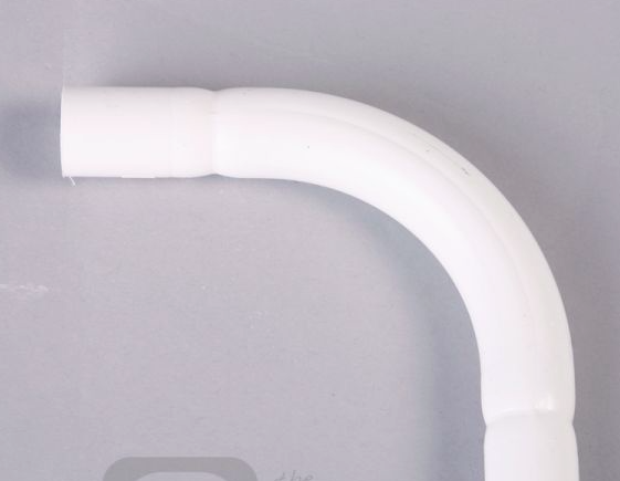

Don't forget that network cables Cat5/6/7 etc, have minimum bend radii, so you need to make sure your bends don't violate these. Bending these cables too tightly, or kinking them during handling, causes an impedance discontinuity which results in signals being reflected, which can cause data errors on the link.
Great advice. I am soon to be the proud owner of 35 of these. I haven't quite worked out how many I need just yet but surely not 35 right angle bends!!
So my plan is to use 20mm rigid conduit with 2 Cat6 cables in each. There will be quite a few separate runs as I am feeding 4 different tvs and I may also use sone for the 5.1 speaker cable in the ceiling as Murphy's law says I will end up with a 4.1 following a poorly placed screw.
