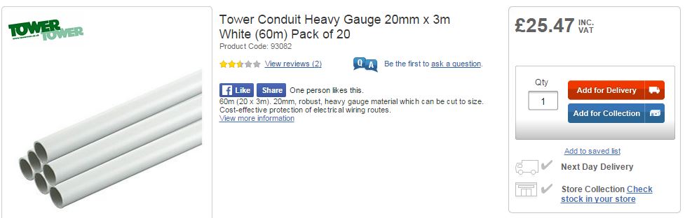

100mm within my concrete slab would concern me structurally. Perhaps unnecessarily. I am going to get these which are super cheap. Also I should be able to get some nice smooth large radius turns using a blowtorch to bend them which I would not be able to do with a 100mm soil pipe.
You really don't want to go to a blowtorch for bending this type of conduit! Just some warmth from a hair dryer can be quite sufficient to make it easier to form gentle curves, using the bending spring as mentioned.
I've probably been watching too many people on youtube torching pipe. Hair dryer and spring it is.
