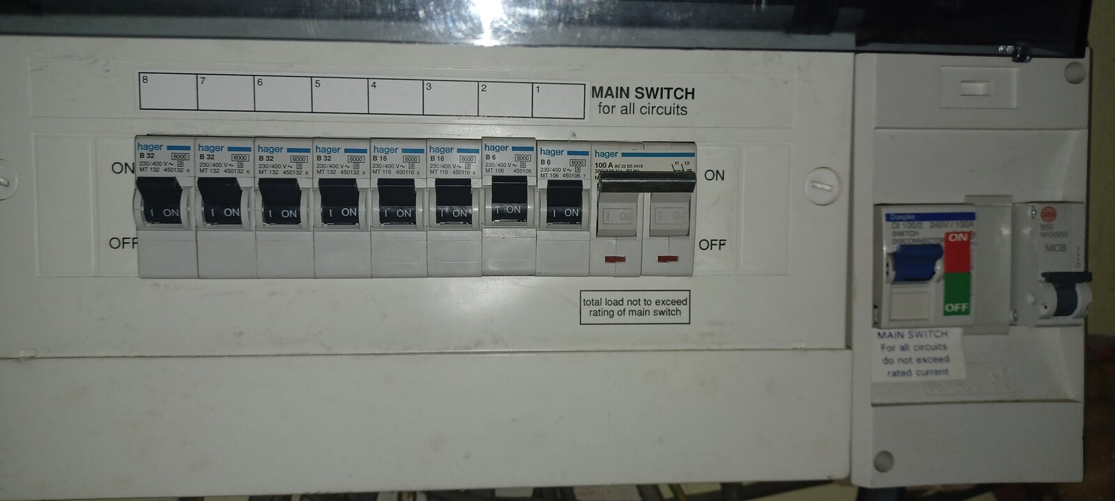

Circuit is on a 16A MCB

Are you sure about the 16A MCB if the power is coming off the lighting circuit?
If its a 6A MCB the likely hood is that the MCB would trip before a 3A cartridge fuse blows.
Yes.
House is extended sideways. The 16A is the old part of the house and outside lights.
Newer 'wing' is on a 6A.

So you are 100% sure the lighting is protected by a 16A fuse or MCB
That isn’t great and needs addressing as most lighting circuit accessories are 10A max
Does the circuit have RCD protection?
A 16A circuit was usually intended for an immersion heater.
Don't think it is RCD protected?
There's a severe shortage of circuit-identifying labels.
