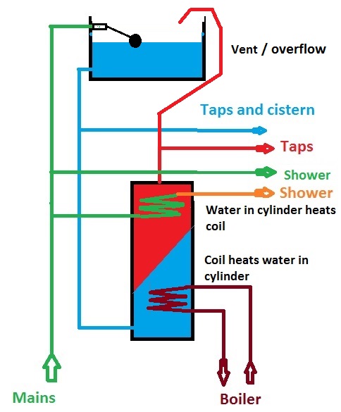

just want to add that you can have that with a mains-pressure HW cylinder
and that is also possible with a vented cylinder with a shower coil. Removes the need for pressure reduction / limiting valves and the necessary safety devices that an unvented cylinder requires.
This works for me.
The 16 kW heat only boiler runs for about 20 minutes in the morning to heat the water in the cylinder.
