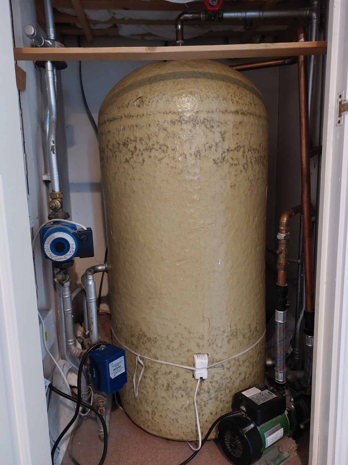

My issue is that my current system is 30 years old, boiler hasn't missed a beat as it's well serviced but flue has now corroded and can't get a service plan and parts.are becoming scarce. Also as my cylinder and loft tank are over 30 years old I am worried about corrosion there and springing a leak, plus the hot water pump I have fitted is over 10 years old. After reading all these comments it seams 50/50 wether to switch to a combi or not.
If I just replaced my heat only boiler, like for like how long can I expect to get.out of.my cylinder and salamander pump before they fail....
Just wanted to add at this time of year ie the summer my boiler fires up for 45 mins in the morning and 45 mins at 5pm and that normally covers all our water requirments unless the Mrs is doing a lot of cleaning lol.
I have enclosed a.picture of current set up with pump in airing cupboard.

Is the loft tank plastic or galvanised steel? What colour insulation does the cylinder have?
Your pump will run until worn out, but is a quick, easy swap in an open vented system, which anyone could do. Not really worth consideration.
Loft tank plastic, cylinder green it's old so greenish yellow if that helps.
Greenish I think is the most recent, yellow older. If there are no leaks, no reason not to reuse it. Mine is yellow, I improved the insulation of mine, with an old winter bed quilt. It made a surprising difference.
I installed my (edit) yellow HW cylinder (looks quite similar to yours) in 1999 and it's been fine since then.
Cylinder will last as long as the hills - open vented lagged copper cylinder - as long as the CH system is clean and you're not plagued with hard water then it should last as long as you need it.
Pump - who knows - again hard water is their nemesis, that and the seals wear out - I have had brass/metal impeller pumps last 15-20 years.
Plastic Cold Water cistern (CWSC) again should last as long as it's needed - just needs a good bylaw kit with lid and again no hard water. Clean it out as and when the sediment calls for it.
Your airing cupboard looks all nice and tidy - pipework good - pump and couplers clean etc, air separator clean, nothing in there to cause concern so that's (edit)all good.
Just another good quality HO/Reg boiler should be all that's needed.
