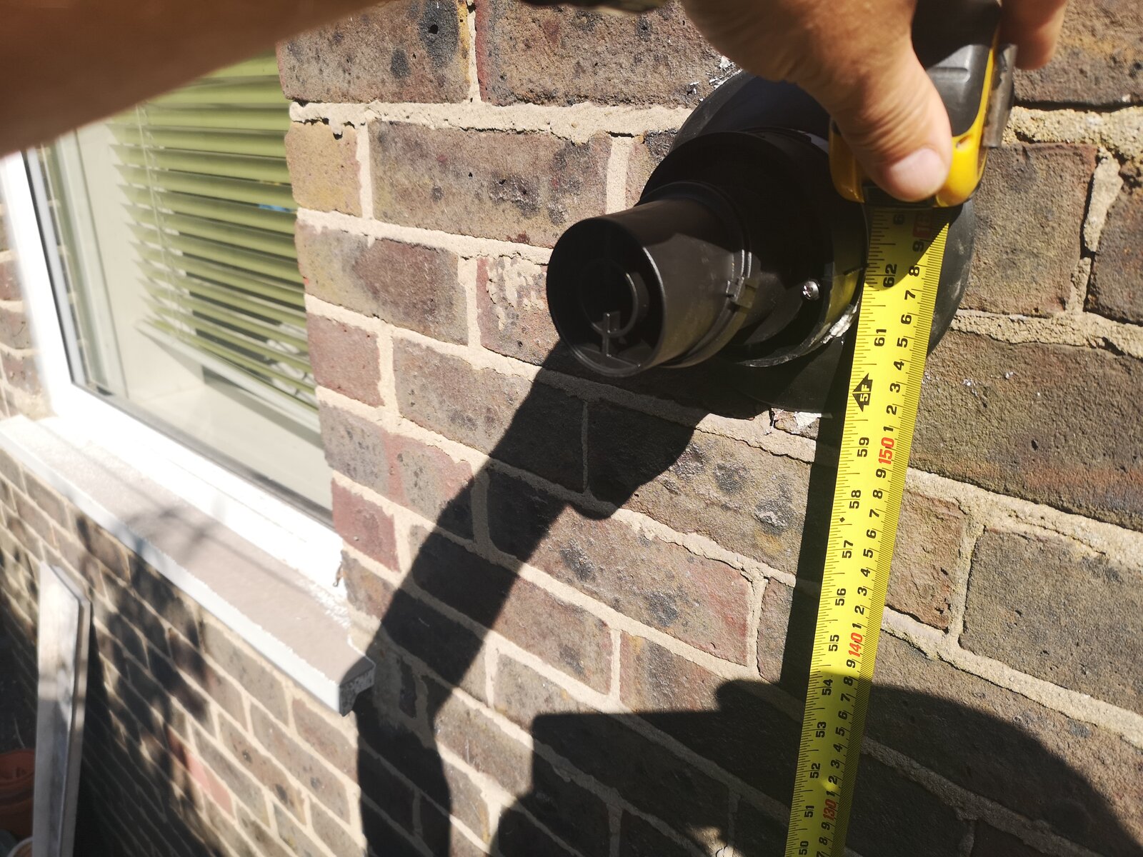

Flue doesnt look an issue per se, but Diverter kit should be used if Plume would create a nuisance.

The boiler height is ok - flue terminal needs to be caged if it's below 2m.

I have just spoken with Gas Safe; boiler warranties and system cleanliness are not in their remit, but safety issues are and they advised that any flue outlet below 2 meters should have a guard to prevent the possiblitiy of scalding, so there are safety concerns here and they are going to send an inspector round to assess the whole installation.
