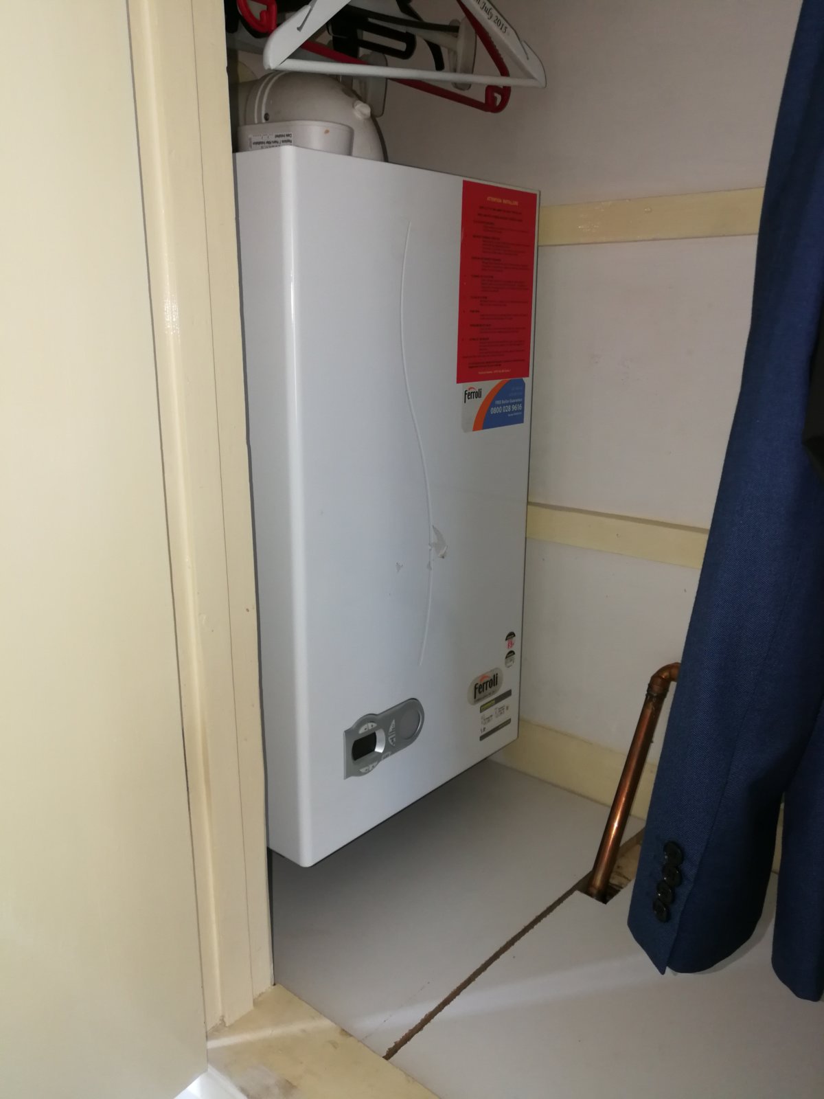

The intergas can't be fitted due to its size and layout.
The veissman man who came out today was really helpful and filled me with confidence, I spoke to him about the intergas, and he really likes them only reason he don't fit them is because he says he doesn't really like the local intergas rep. Any way he said looking at it the intergas wouldn't fit, mostly due to the condensate, just checked the install manual and yep you need 840mm clearance, I've got 780mm (from the top of the existing boiler to the base of the cupboard)
He also recommended the Baxi to me because of the way the flue can be situated to go straight out the rear of the unit, which means I can lift the boiler higher from the base of the cupboard, he said he has fitted about 10 so far with no issues.
He said he has had issues with a couple of veissman but said they have always sorted it out no quibble. Oh and the veissman no longer have rubber hoses, they have now changed them all to copper only.
What's the opinions on the Baxi? Probably not great.
Have uploaded some photos to show what I mean about the boiler and being restricted in size.

Shame. Yes height is sometimes an issue with them. Viessmann are good but go for the 200 rather than the 100 if space allows - it is far superior.
Baxi are ok, but the older ranges such as the Duotec aren't compatible with modern energy-saving controls, and the newer ranges are still a bit unproven as they've not been out long. You do get a long warranty and decent-ish backup though - usually 2-3 days wait for them to respond to a warranty call
Hmmm
I was looking at the veissman 50 tbh, then the guy mentioned about the 100 and said it's about £150 more but is a better boiler. Only downside is you have to pay veissman an extra £150 to extend the warranty to 7 years.
Veissman website doesn't really explain the difference between their boilers very well.
EDIT: the 200 doesn't fit, to tall
I thought the Baxi he offered was the 100 but that's not the 7 year one so he must be talking about the 600, the Baxi is also cheaper than both veissman.
