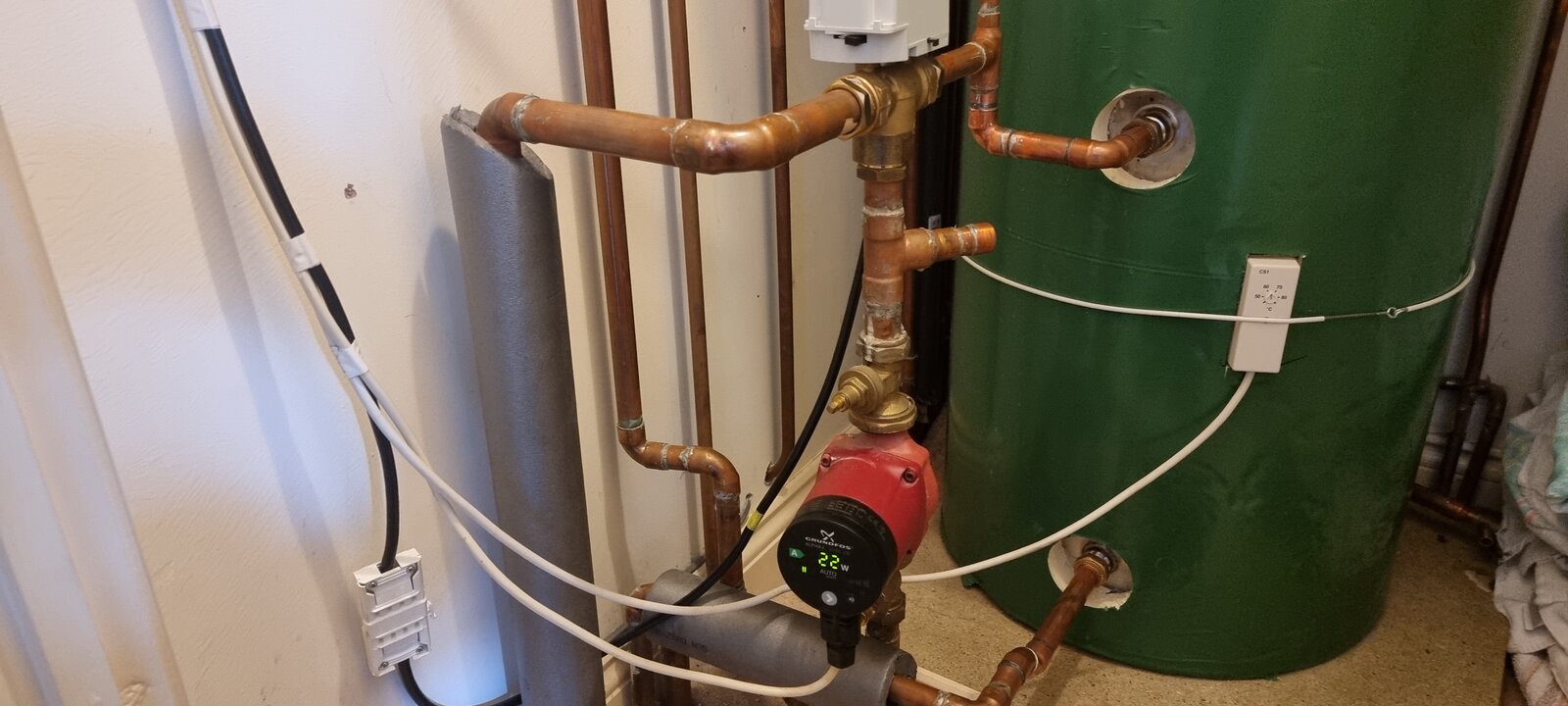

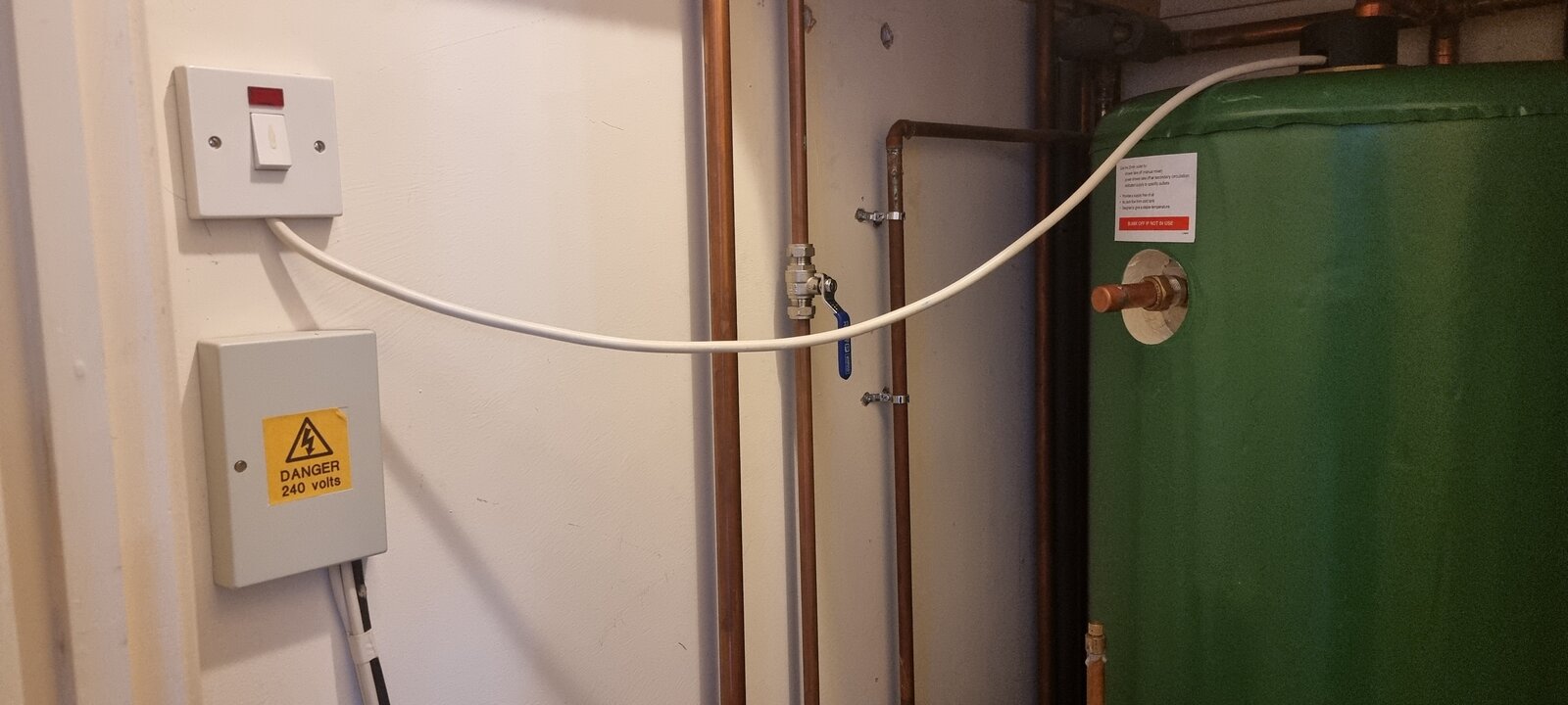

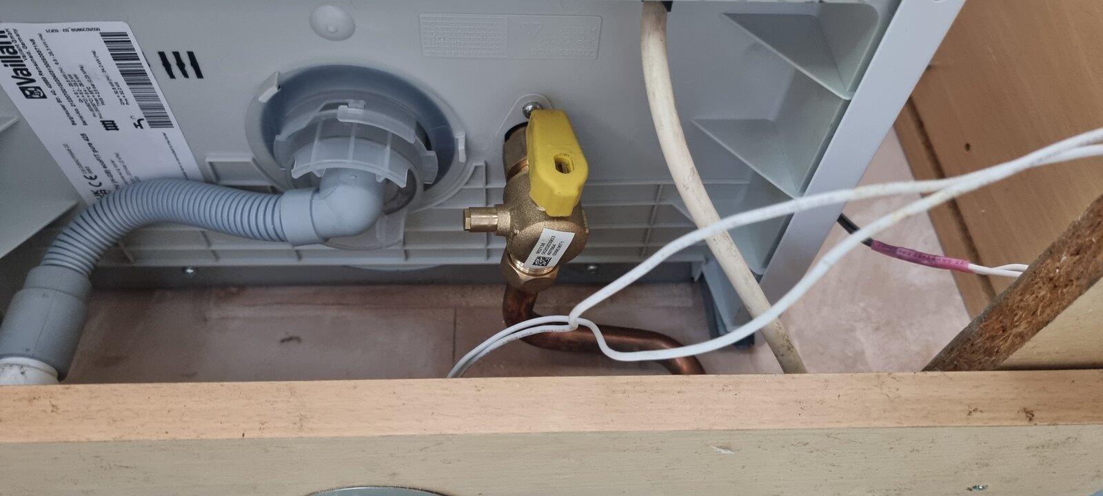

post pics of your wiring at controls and boiler ends
There not a lot to see as you can tell from the attached pics, is this what you meant? (Ignore the white cable with the two wires that's a separate supply to a downlight)

The most cost effective stab in the dark is to try a new pump ( assuming it wasn’t replaced when the boiler was fitted.). It’s a component where water and electricity are in close proximity seperated by a seal
The most cost effective stab in the dark is to try a new pump ( assuming it wasn’t replaced when the boiler was fitted.). There isn’t another component where water and electricity are in close proximity seperated by a seal
I must admit that was my initial thought...
