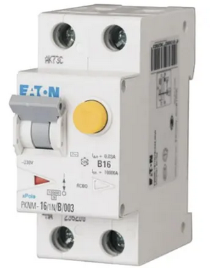

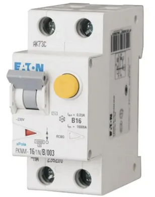

The Eaton range
has a RCM built in so warms when near point of tripping, but not seen any others with that feature. And with all the test equipment I still failed to find out why every so often my RCD would trip in the last house.
I blamed spikes on the supply, but without an oscilloscope unlikely to find it, and even with one, once tripped too late to read display.
The Eaton range View attachment 264901 has a RCM built in so warms when near point of tripping, but not seen any others with that feature. And with all the test equipment I still failed to find out why every so often my RCD would trip in the last house.

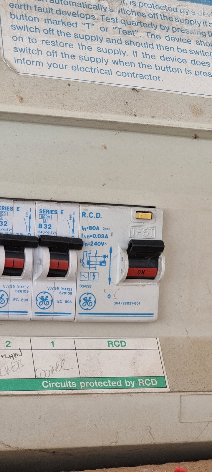

However over the years they do seem to have improved, and they don't trip as easy, however still loads of the old ones around, today the 30 mA RCD is sold as four main types, the type AC
should have the single sine wave sign, my old ones don't have any sign, it seems type AC can be frozen by DC so today we tend to use type A
these can stand 6 mA of DC, and there are other devices to detect the DC so if there is DC the other device will trip, then we have the high frequency
where we are using switch mode power supplies we can get high frequency, personally never fitted one, and not seen a RCBO as type F or for that matter type B which is next in the list type B
are used with EV charging points and solar panels and will work with over 6 mA DC out of interest which type do you have?

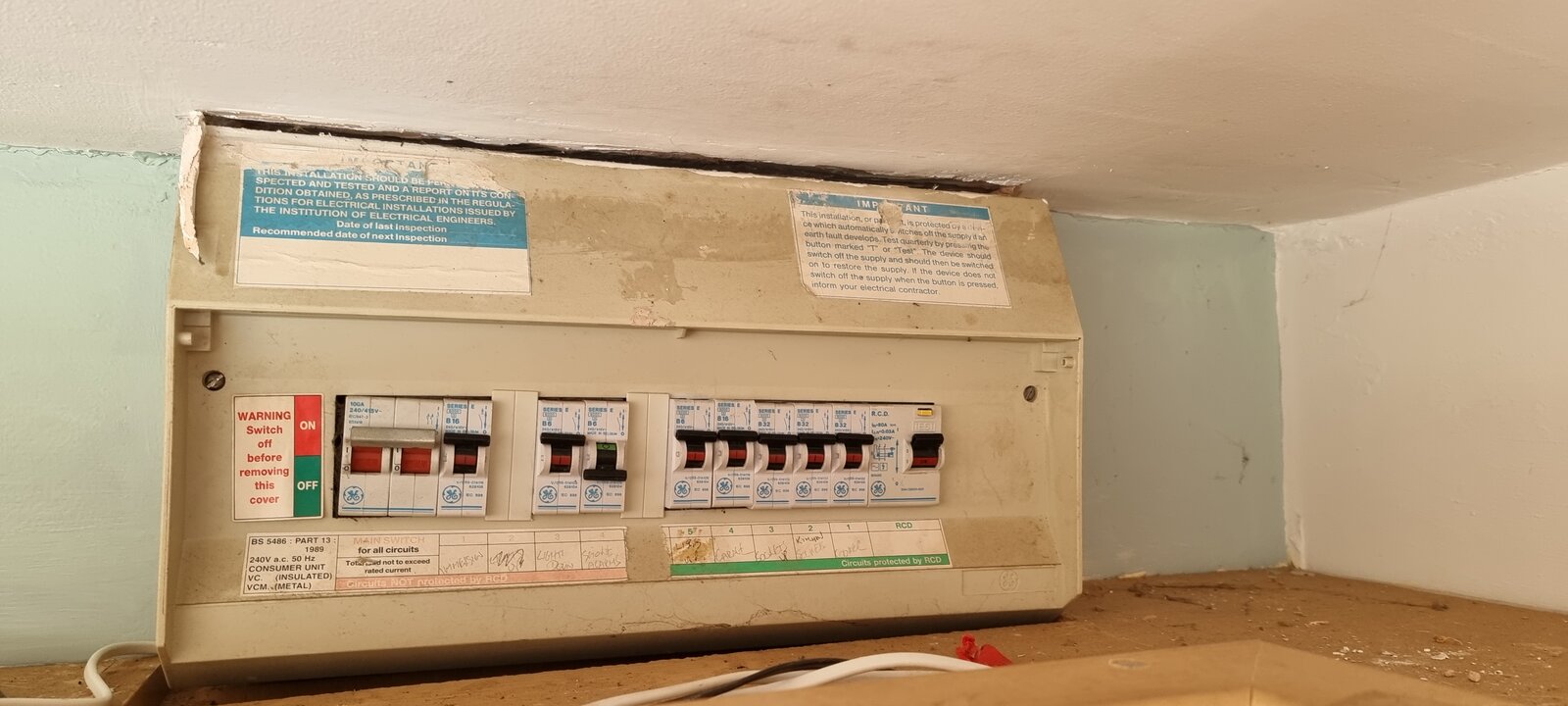

So this my very old CU, I have type AC on my RCD. I've got my (usually tame) electrician coming round on Friday to price me up an RCBO CU, and we've talked about splitting some of that large Kitchen/Lounge/Bedroom 1 & 2 plus utility room circuit up. I'll definitely be putting the heating on it's own RCBO and with a bit of luck maybe split the Utility room or lounge off too, just to make it a more sensibly sized circuit.

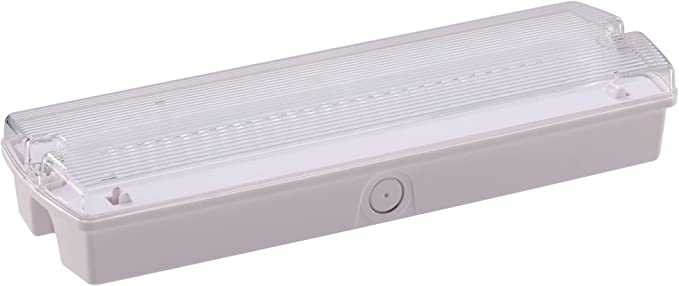

I use the Lidi rechargeable touch, it auto lights with a power cut, so it draws on attention to loss of power, also have one I think came from Tesco, There is a movement sensor which will make it light in the dark with movement, used in the caravan I put tape over it, here at home it lights the stairs at night.
Sorry to say GE did not last long in the UK, and a consumer unit is a type tested distribution unit, so fitting another make of MCB or RCBO would mean it is no longer a consumer unit as not type tested, and when the installation is in the control of an ordinary person which your house is, then we should use type tested appliances, so an electrician is likely to be unwilling to fit some other make of RCBO in that box. Even if there is one that fits.
Which circuit is the heating on? I’m guessing sockets?
A 10 way fusebox consumer unit Height 259mm Width 306mm will it fit in the space?
At a push, we'd need to either cut into the top of the cupboard to make space for it, or re-site it elsewhere, the electrician is coming round to have a look on Friday, but also yes, my intention was that the unit would go and we'd get a new one with RCBO's, rather than fit RCBO's to the old board.
Yep, the heating is on the kitchen sockets, along with the lounge, utility, Master bedroom, 2nd bedroom... it's a crazy big circuit! Like I said above I think, I'm planning to get that circuit split up a bit to reduce load on it, but also to narrow down any future tripping issues...

I've actually bought one of these to make sure I wake up, it's a non maintained LED so come on with power loss :LOL:
I'll keep looking for something audible as an ideal, I found one thing but apparently it's deafening, so not sure that's the way to go...
