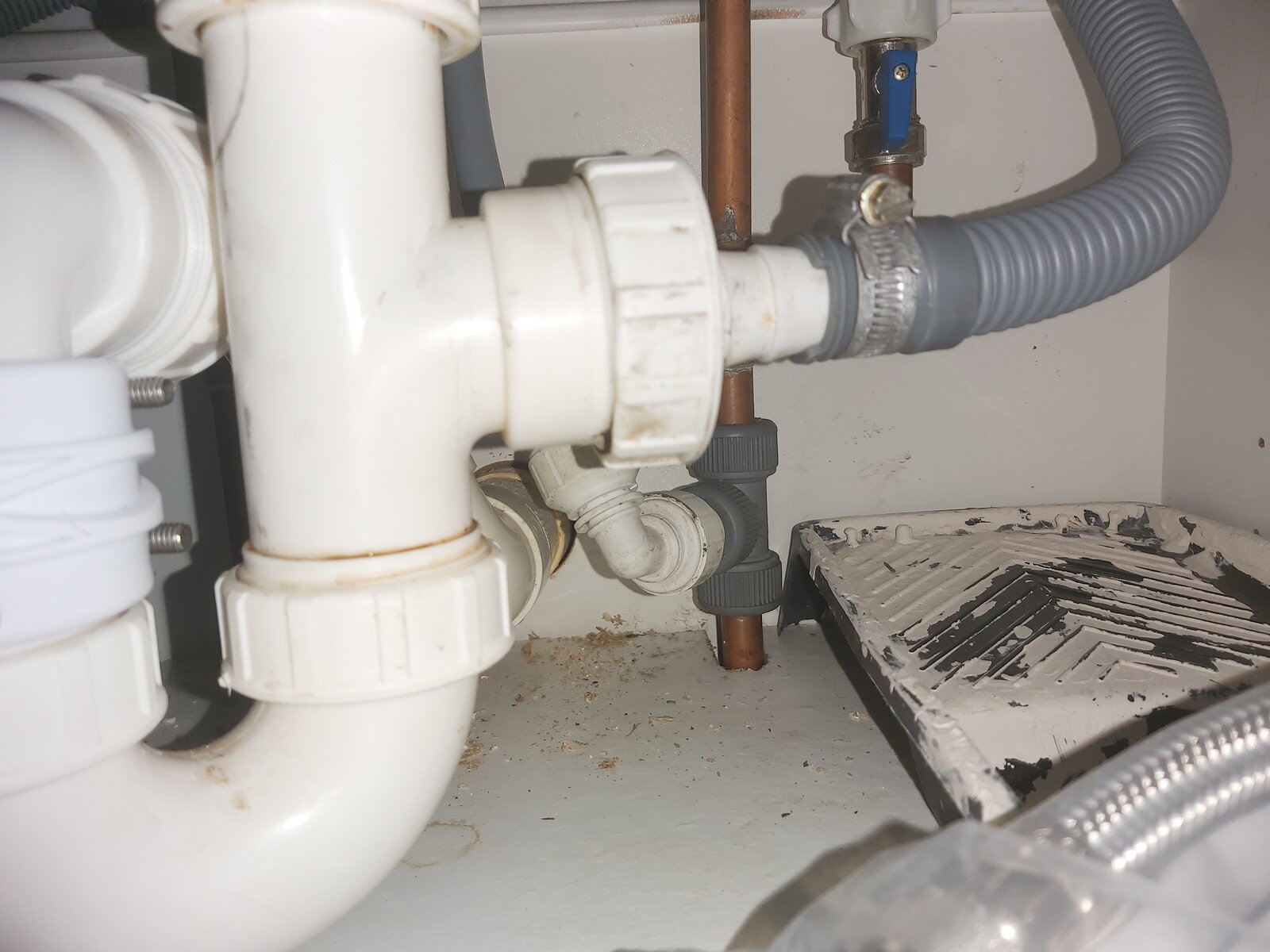

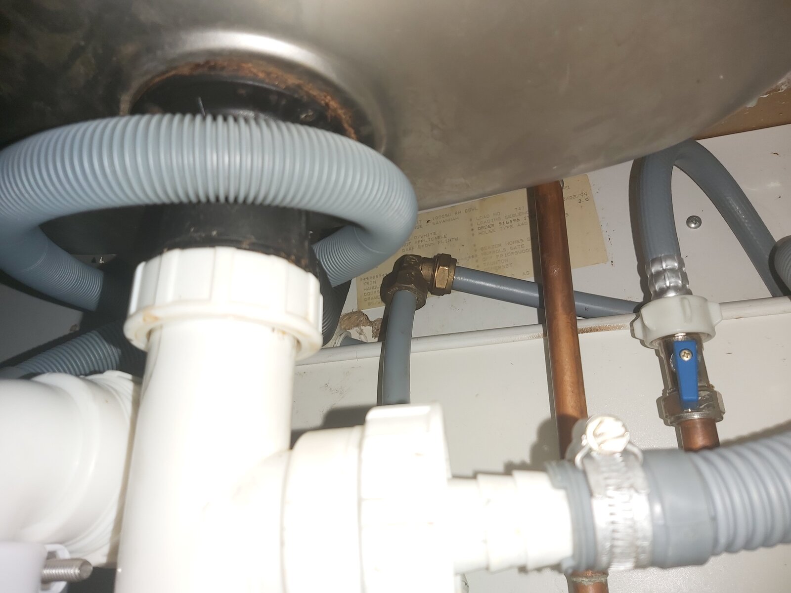

All the valves are open from what I can tell but I did notice he's used a little plastic elbow that could be restricting things?

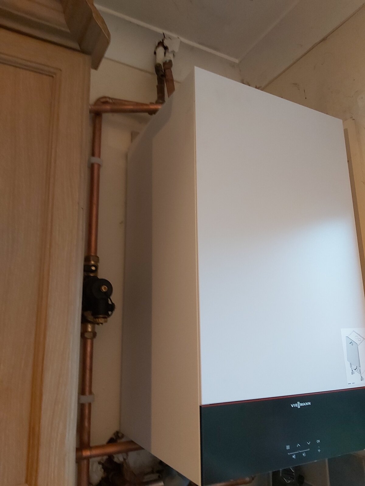

Irritates me when fitters work on a copper system & bang in a load of plastic cos it's quicker/easier for them. The internal bore of placcie 15mm is only about 11mm to start with, the inserts drop that even more so it won't be helping.
What sort of flow & temp are you getting from the kitchen hot tap? And I really meant pics of the boiler pipework and valves, sorry for confusion.

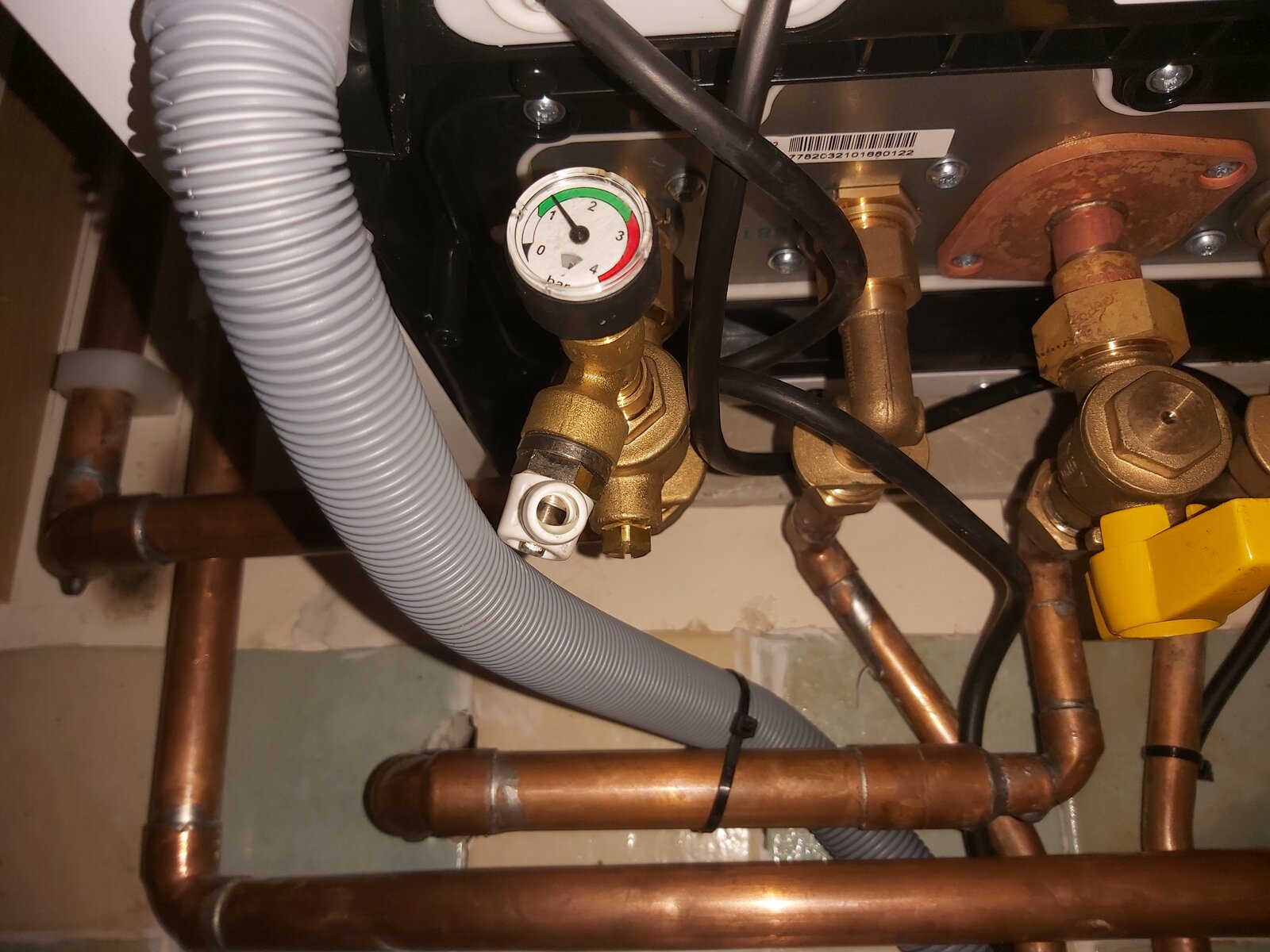

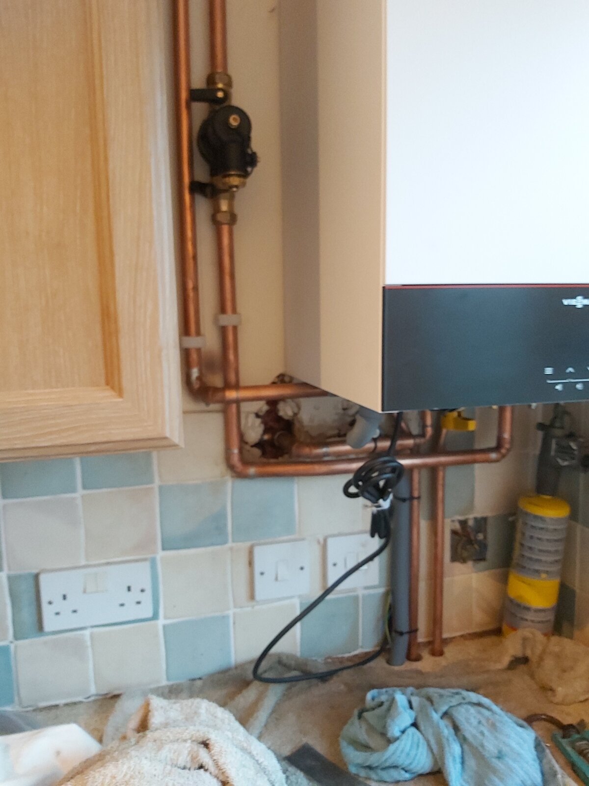

some more pics...

That's all a bit shoddy...wonder why he didn't run the F & R behind the boiler? Would have had to get creative with the Magnaclean I suppose- under the worktop mebbe? Looks like the iso valves around that cleaner are closed...did you do that or did matey leave them like that (if they are closed then heating won't be working)
Thanks for picking up on on that. Those pics were taken mid install before it was all hidden behind a cupboard, figured they'd be clearer/easier to see what's going on. Valves are now open on the magniclean.
