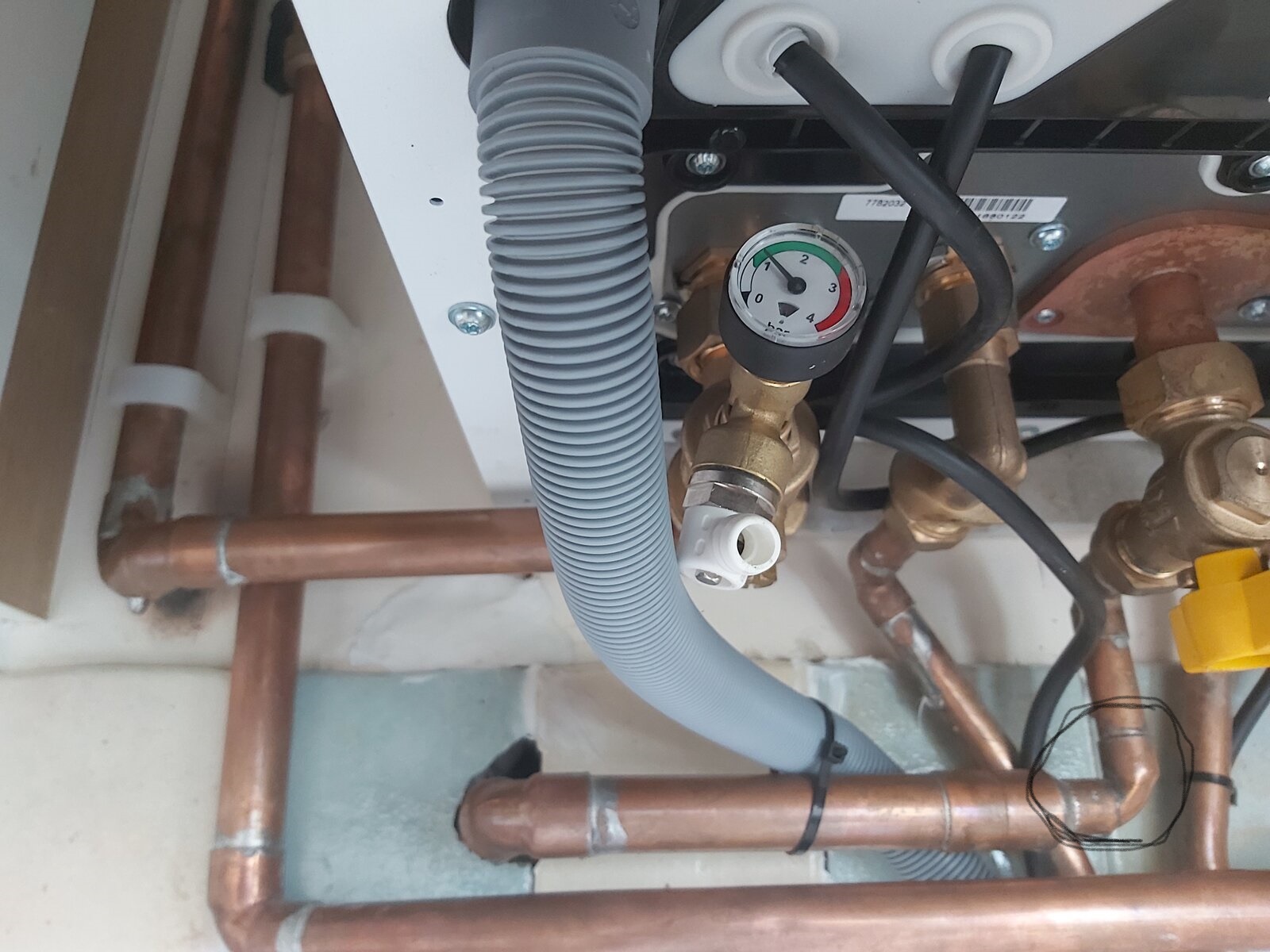

I'd really like full bore copper from the CW feed to the boiler, seems crazy to reduce things down there when it affects the whole HW system. As mentioned that plastic pipe is probably 11mm internal and that plastic elbow could be as little as 8mm (5mm?).

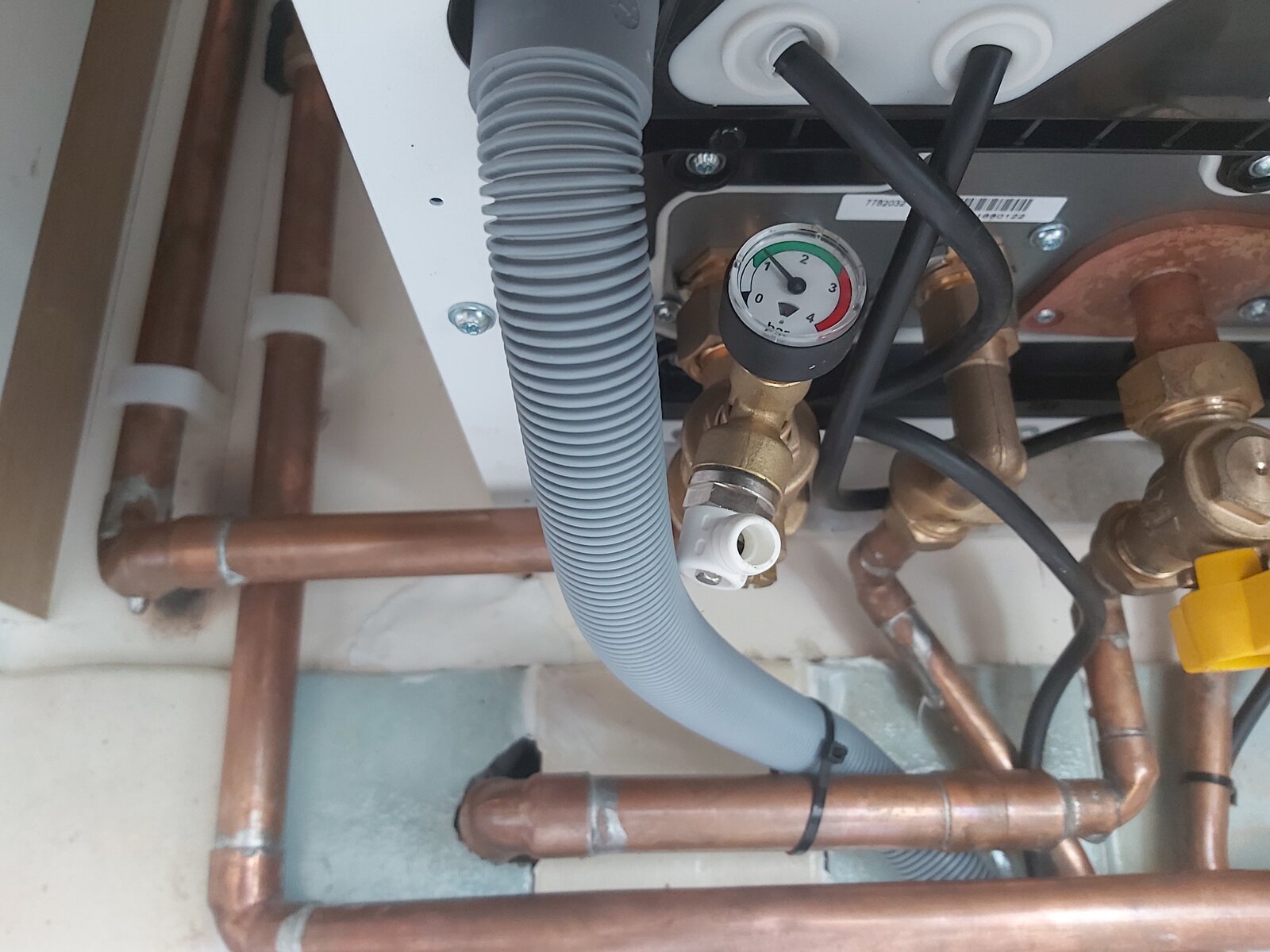

That gas pipe through the wall, is it protected
Not sure what the difference would be, I'll attach a photo of how he left it....
That pressure gauge bottom left of the boiler - if that's a reducing valve then no wonder your hot flow is rubbish, it's only at 1.some bar (assuming that's the cold inlet).
EDIT Sorry, looked again- it's a rough arse pressure gauge on the heating side, my bad :(
EDIT 2 A foot of placcie and some inserts won't be dropping the pressure by 50%. Is there any other valve gear between cold supply and cold inlet to the boiler?

Probably starved of gas if this elbow is any thing to go by.....
Probably starved of gas if this elbow is any thing to go by.....View attachment 242764
Yeah, I don't know what's going on with those elbows, not seen them before. The ones I've seen are 15mm around the bend, these look stretched out or something...
It looks like it goes down to 10/12mm or something as well. (edit: actually that's probably 22mm coming out the wall, still, the bend is not good)

That could suggest a restriction in the gas supply, so it throttles the water flow to achieve the required temperature. There must be boiler inlet and burner pressure tapping points, a check with a simple water-tube manometer would tell whether it meets the boiler spec.
What length is the 22mm gas pipe? That 15mm elbow doesn't look ideal, but I estimate it gives pressure drop no more than about 0.25mb.
What length is the pipe in total? From the meter? It's gotta be 10 m, maybe a little more.
