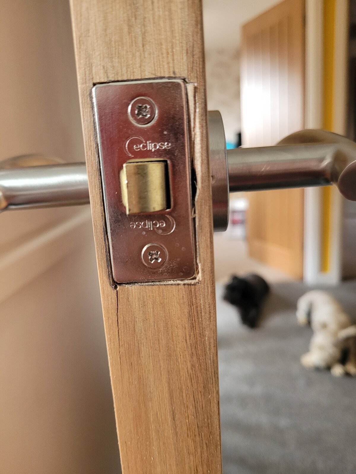

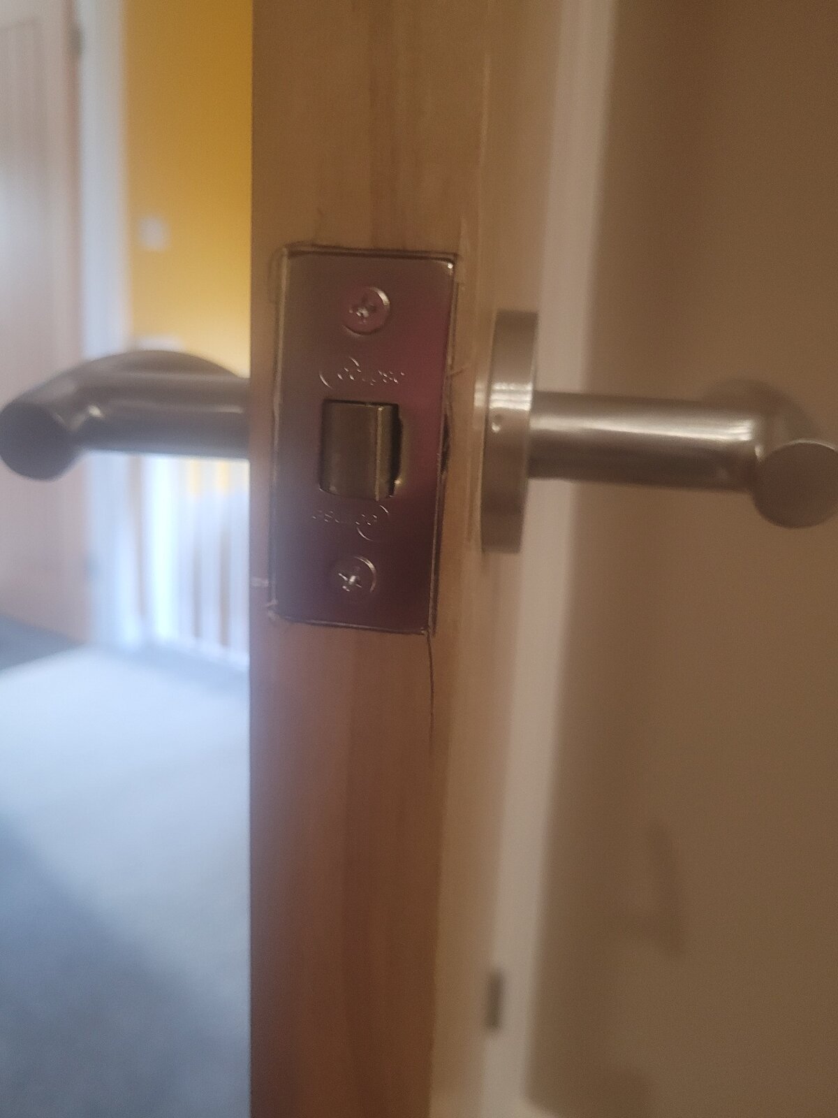

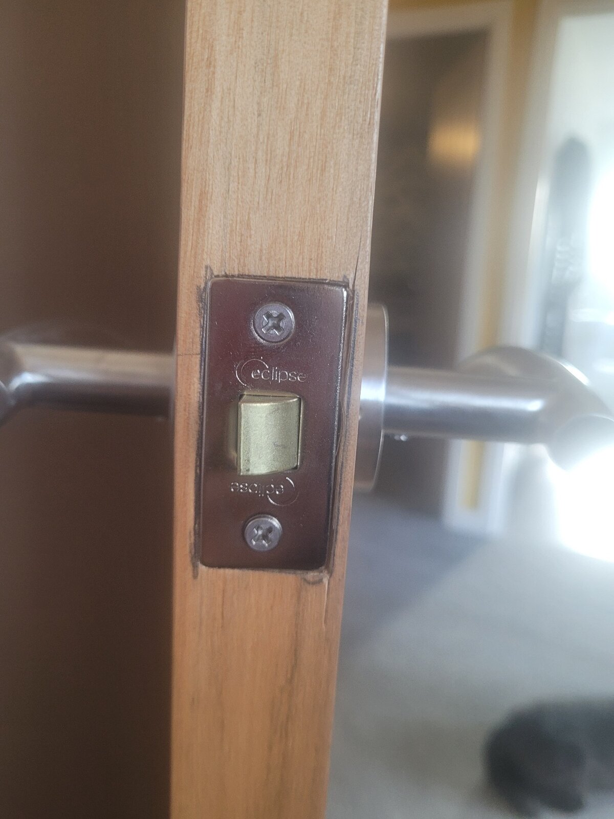

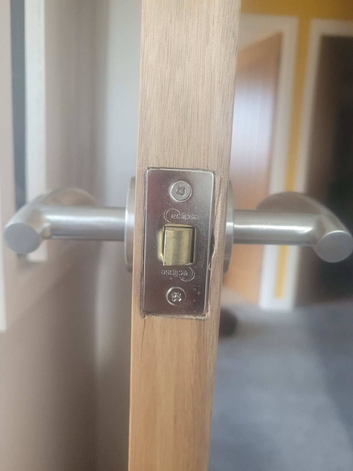

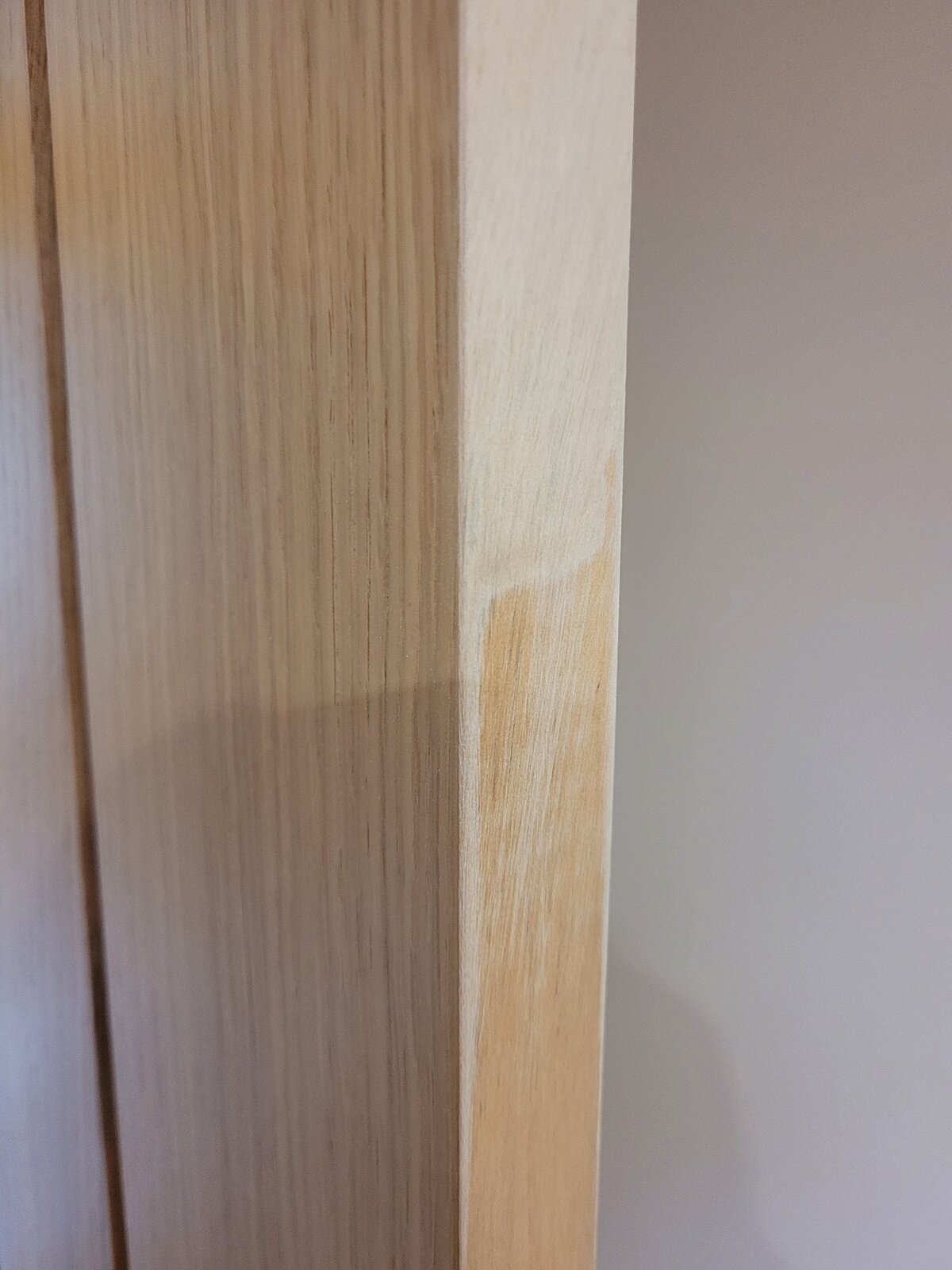

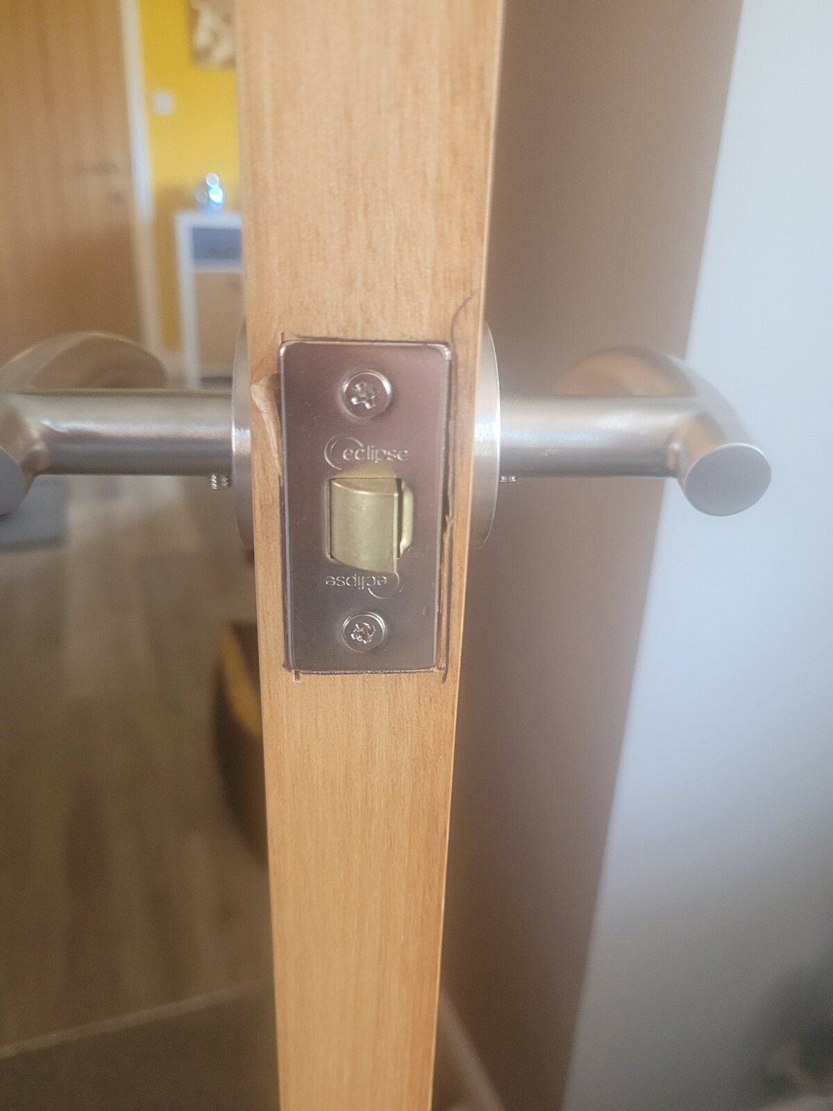

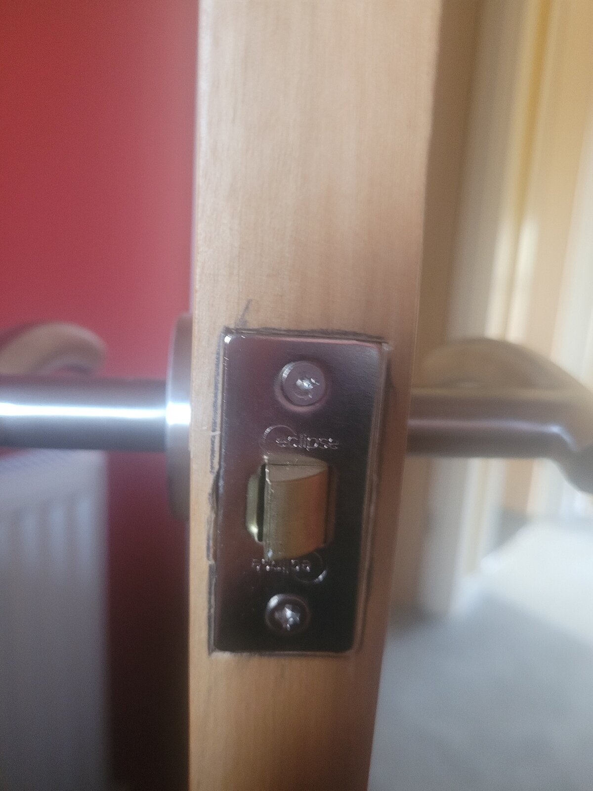

Looking for some advice re the following please...
We bought 8 new oak doors from Howdens (Dordogne pre finished) plus door packs. Rang couple of chippys and got prices but then spoke to another who couldn't do it but said we need to make sure we get someone who is going to varnish the edges after trimming. Thought best to ring Howdens and they recommended a fitter who's done loads of these doors and is also apparently their showroom fitter. Rang him, he said he has the varnish and knows how to do them. He messaged later saying it would be £600 to fit the doors. Bit more expensive than the other 2 but they never mentioned the varnish so we booked him in.
The other chippys said they needed 2 days and the one we booked said 1 day for 2 of them.
So onto the day of fitting, I was out but missus wfh, he turns up alone around 9am and queries why there's 8 doors when he thought 6. Anyway he gets on with it and he's finished at 330pm.
I get home and we check the doors and can't believe how he's left them. I messaged him and sent a photo, he agreed it looked **** and will come back.
I get an invoice that evening for 600+vat which wasn't mentioned initially. I rang him and told him we're not happy with any if the doors and that they look like they've been rushed. He doesn't disagree and he is due to come back Tuesday to rectify but I don't see how he can. I queried the price and he said he thought it was only 6 doors so the vat was a wau of trying to get more money. So basically he wants snywhere from 80-100 per door for which I'd expect a perfect job. He also didn't fit the extra hinges we bought so each one has 2 not 3 as advised.
So basically what I want to know is how we stand if we're not satisfied after his return visit in regards to not paying him and having to potentially replace doors he's screwed up.
Photos attached, please comment if you think I'm complaining over nothing or if it really is as bad as I think

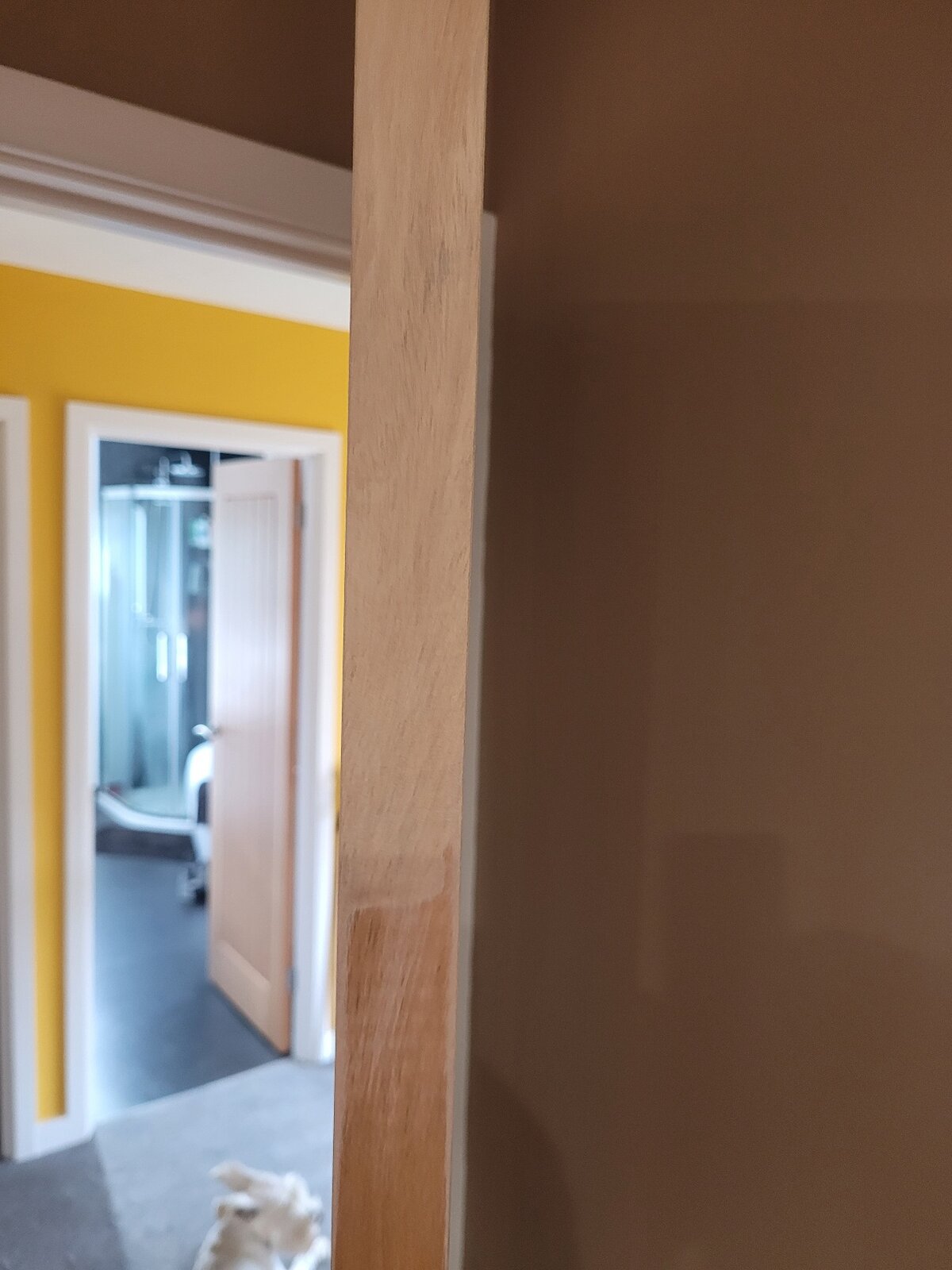

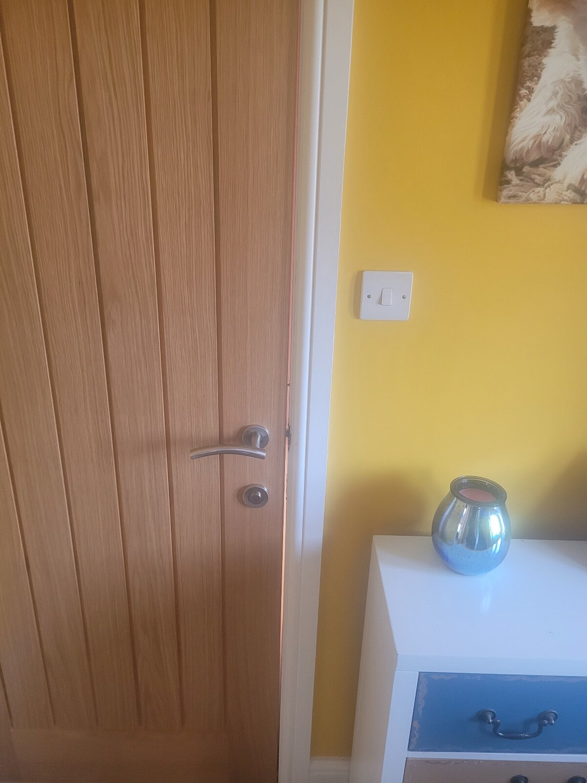

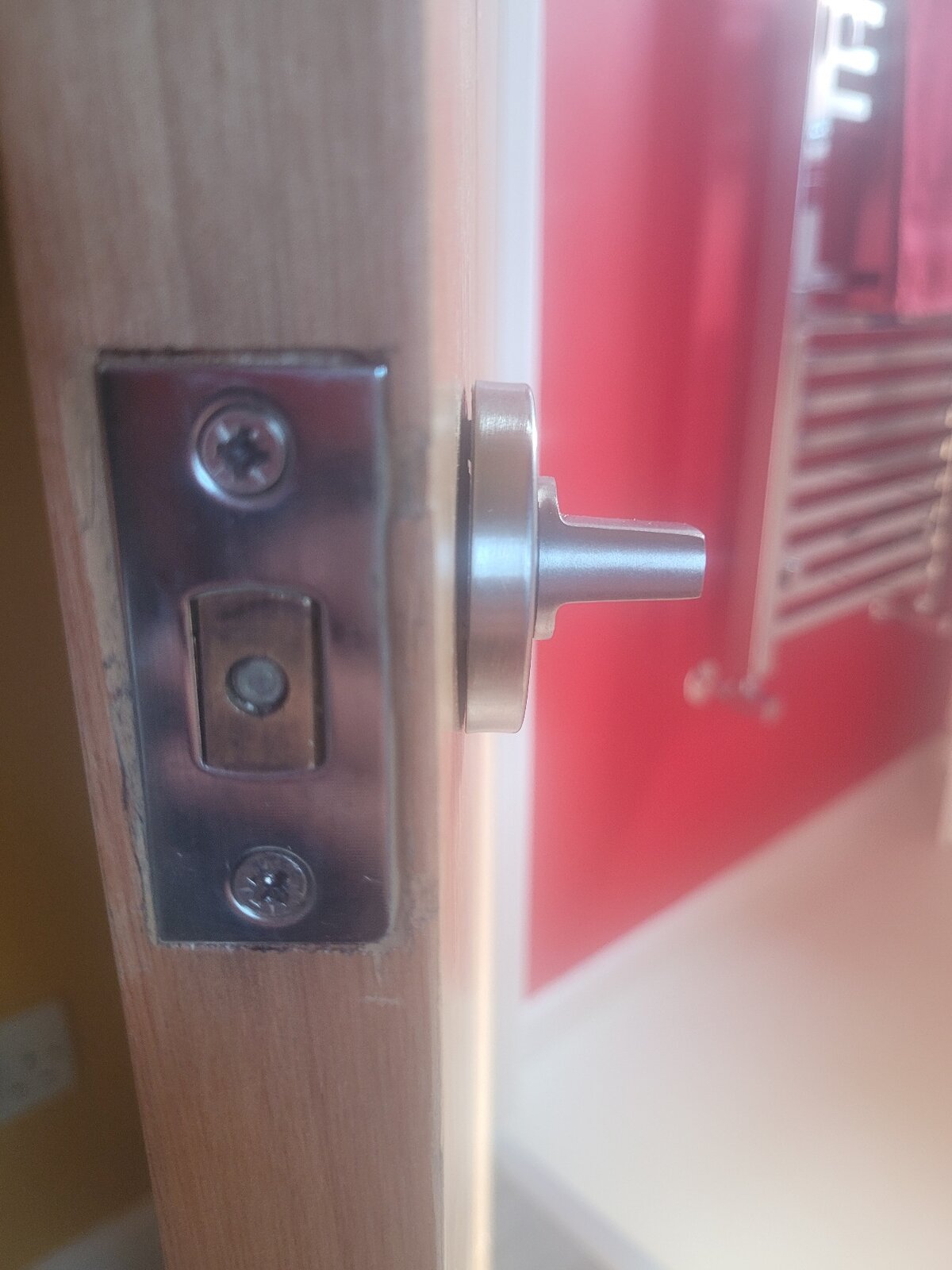

OP, I was amazed at the fact that he got the first one wrong then proceeded to make even more mistakes all the way through!
- He marks everything out (inaccurately) with a (seemingly) blunt pencil which he can't be arsed to clean-off afterwards (ALL).
- He has drilled the holes for the latch body slightly off centre and it can be seen (Pictures 2 RH, 4 LH, 6 RH, 7 RH and 10 RH). The easy way to mark a centre line is to use a marking gauge - they teach you that at school - and you should size the drill correctly to be a snug fit around the body of the latch, and slightly smaller diameter than the face plate. It is not rocket science
- He has made wonky cuts all over the place (Pictures 1 RH/LH, 2 RH, 4, 5, 6 RH, 7, 10 RH top) which has resulted in broken/split grain (Picture 1 LH side - attempted to fill?, 2 LH top, 5 RH top and bottom, 6 LH bottom, 7 RH bottom, 10 LH bottom)
- The recesses are oversize/not square/poorly sized (Picture 1 top, 4 - twisted?, 5, 7 top, 10)
- A number of the face plates do not seem to be centred in the door and in some cases are twisted (e.g. Pictures 4, 5 and 7). If the keep body is twisted the handles might end up stiff whilst twist and/or non-centred latches can lead to doors which when closed rattle, because the keeps don't align properly
- Chisel cuts extend past the recess (Picture 2 LH top and bottom, 5 RH, 10 RH top)
- Handle grub screws not driven flush (Picture 2). That might result in a handle pulling off
- Keep badly installed and/or damage to door lining/casing? (Picture 3)
- Door edges planed off, but no attempt made to sand-in then relacquer (Pictures 8, 9)
This is not a comprehensive list, but it seems to me that he doesn't understand how to set-out lock face plates on the edge of a hardwood door - it's not that difficult with the correct tools - a mortise and marking gauge, a square and a knife. As said above, the way he works is just plain slipshod. It should, however, be possible to hide most of the damage by glueing and cramping the cracks, and by fitting new sprung latches of a design with a larger face plate, although a bit of filler might still be required here and there. At this stage correcting these errors by hand might be a tad awkward, so I'd probably make-up a little router jig and use a small router to recut the face plate recesses in the door edge (which will be a lot more consistent), and I'd then use a sharp chisel to clean-out the corners (TBH for 8 doors I'd have considered that in the first place). So all is not lost, but I wouldn't let the guy near your doors again as I doubt that he's capable of effecting the rework to a high enough standard
