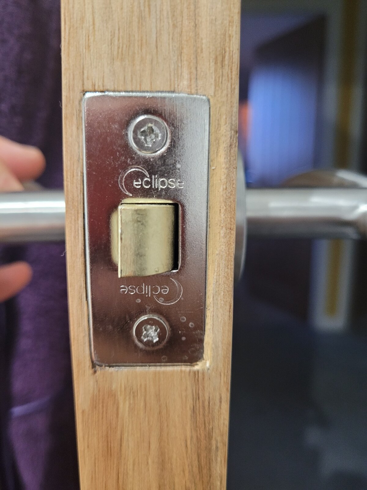

I'll see what it looks like when I get home. He was there for around 2 hours. Missus seems happy with the end result but I'm not sure filling new doors one week after fitting is acceptable tbh.

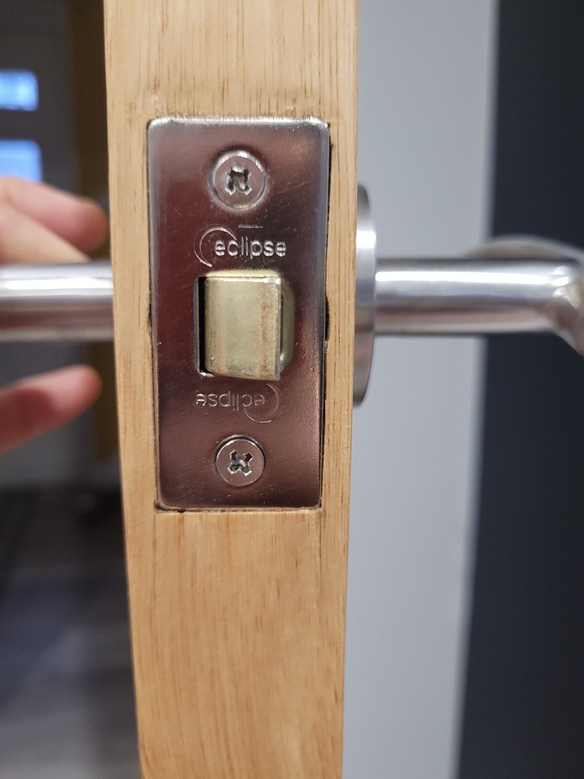

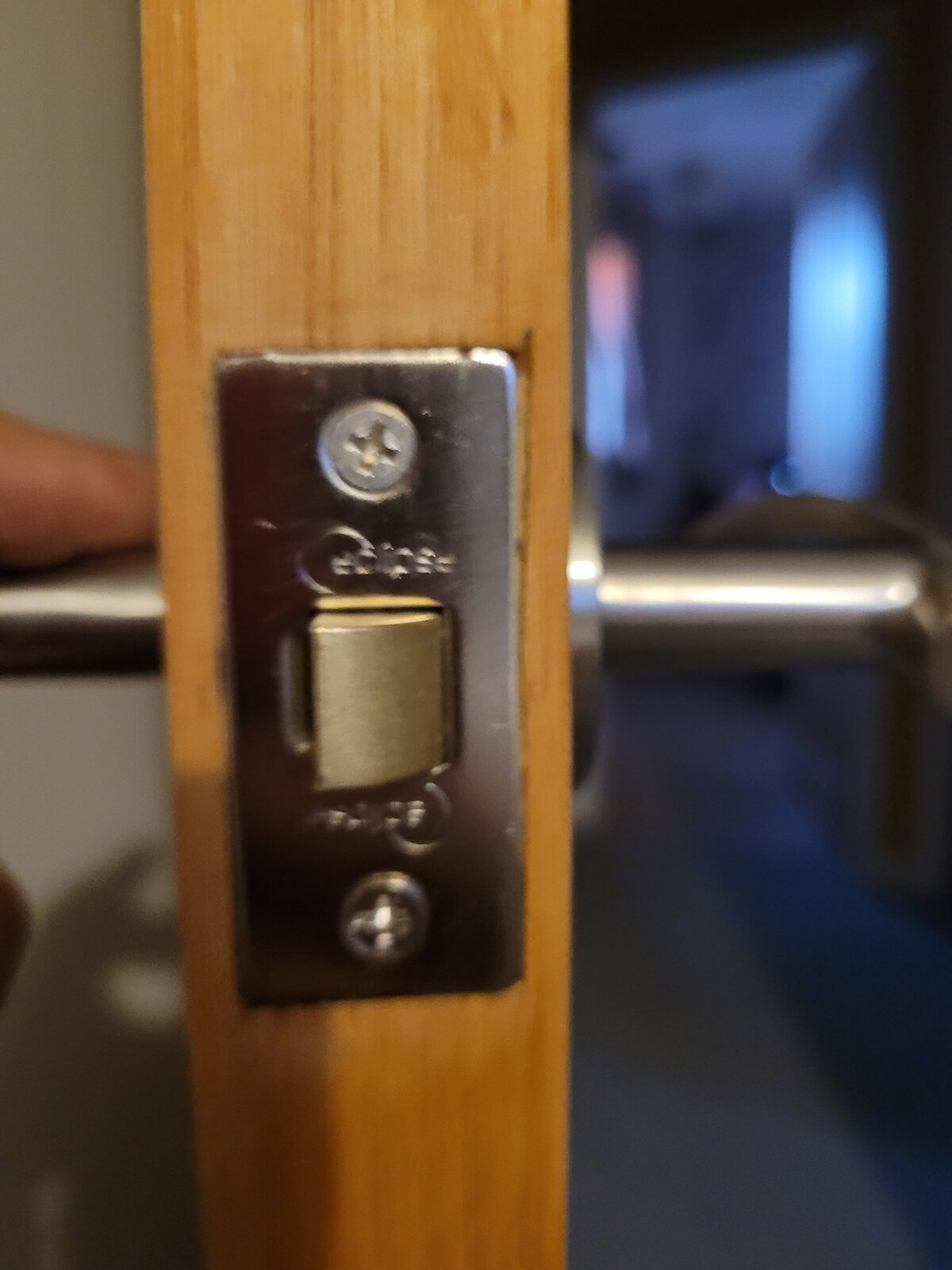

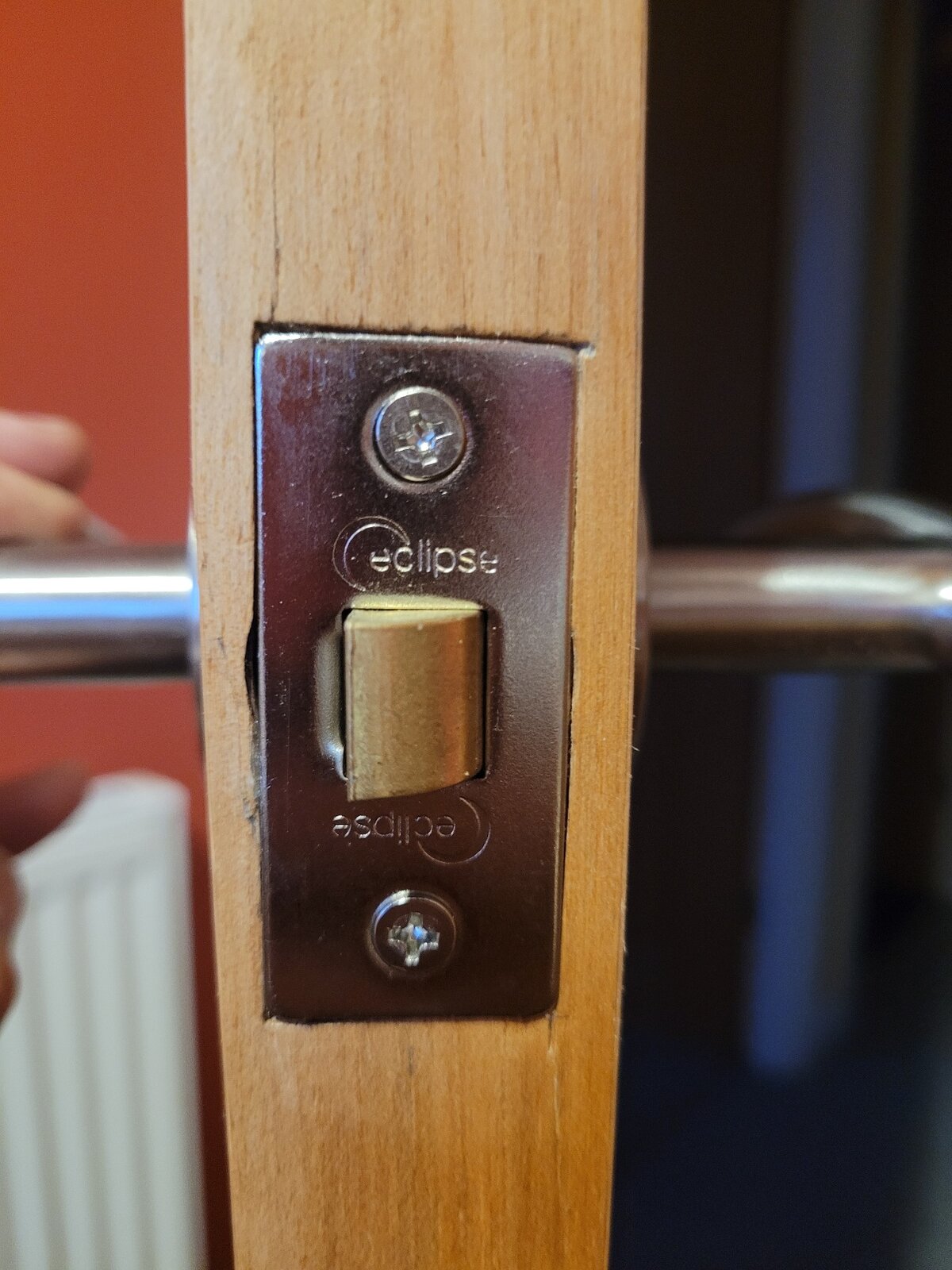

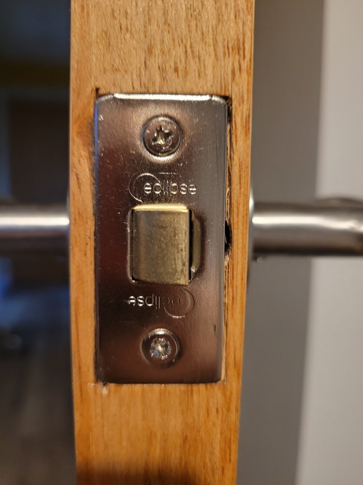

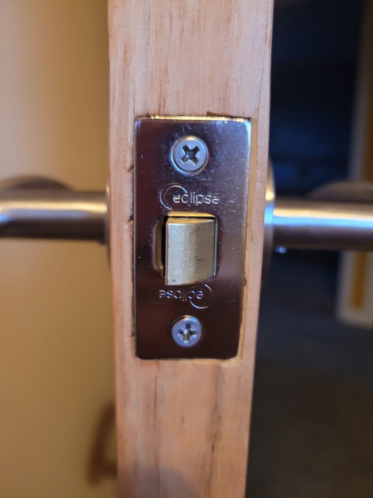

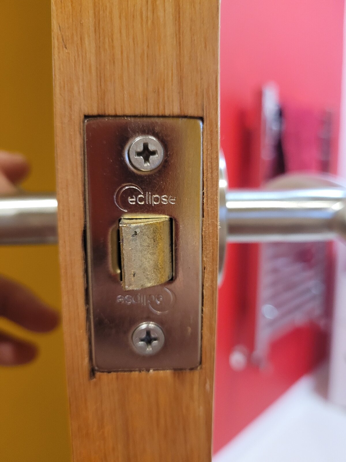

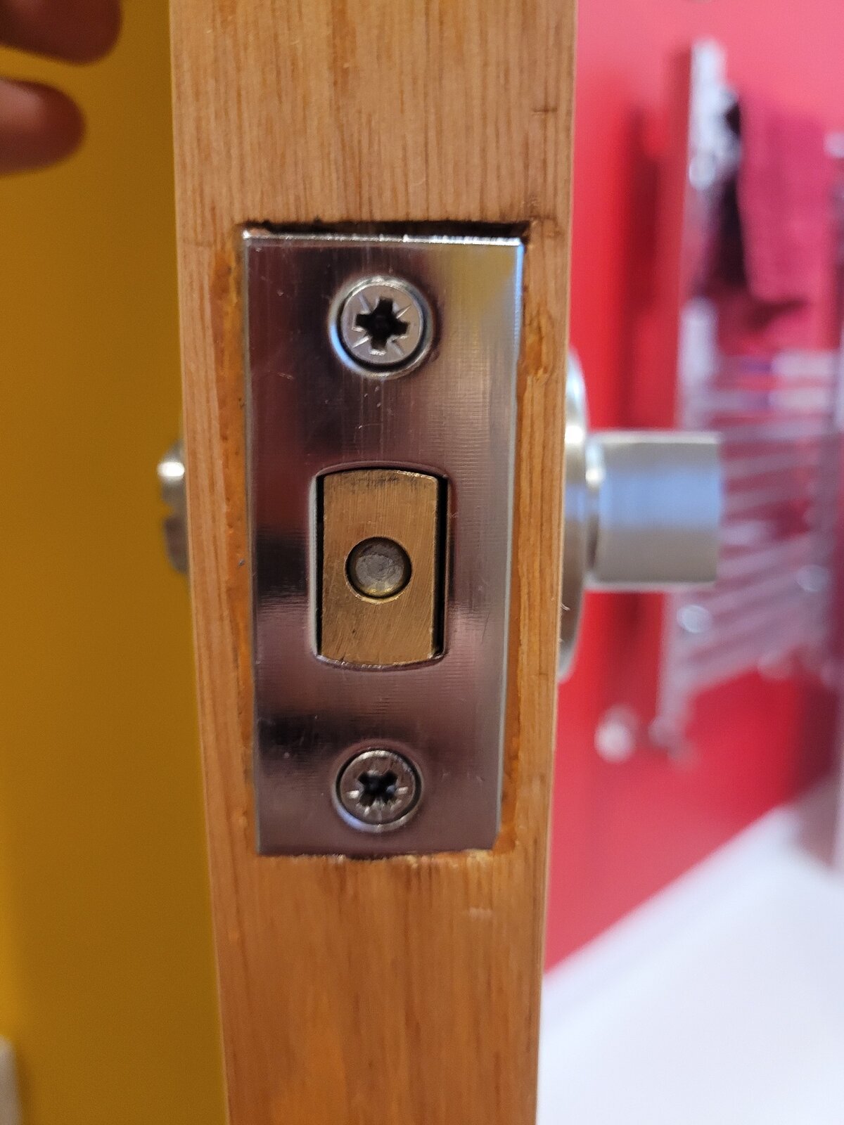

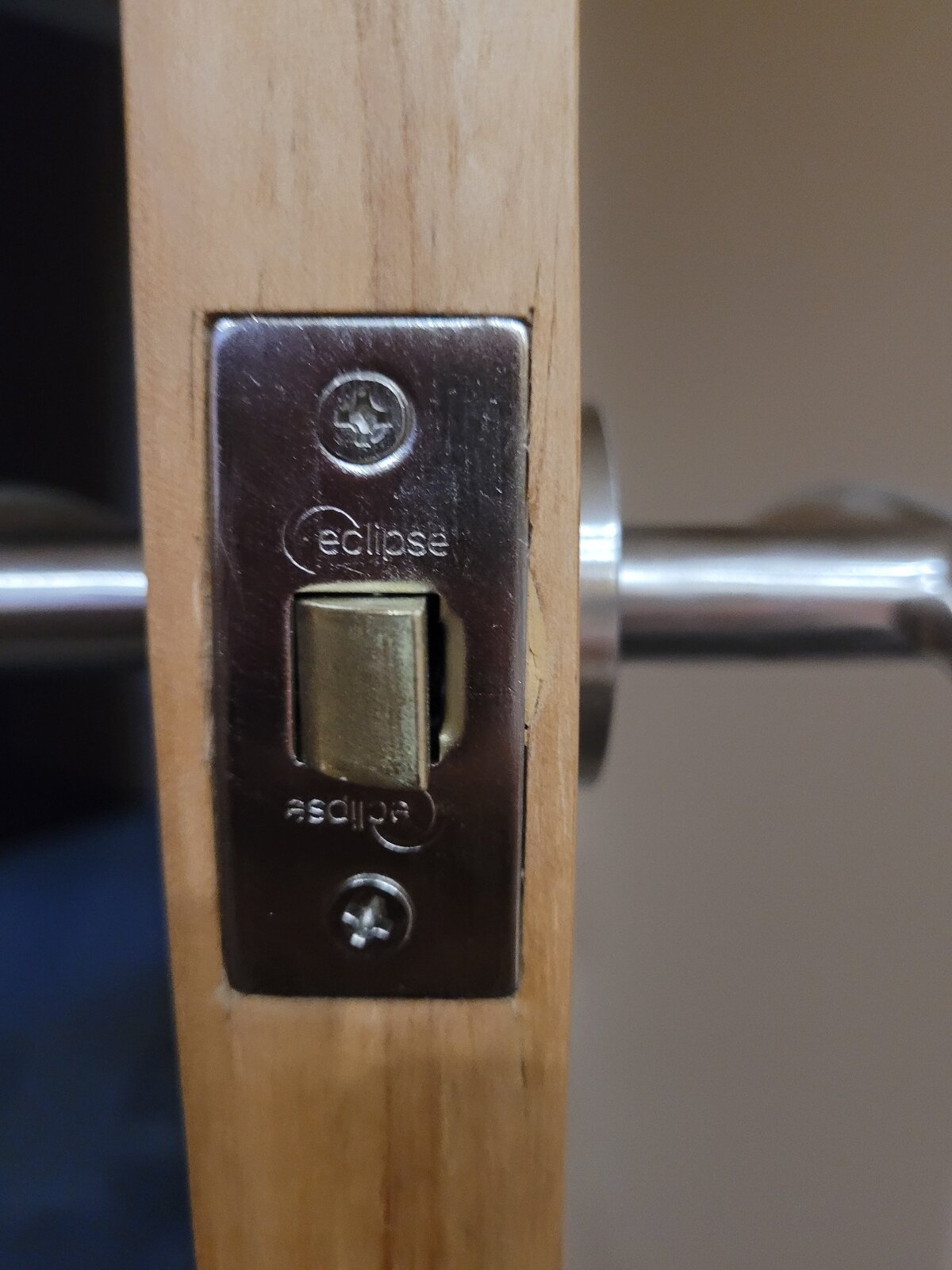

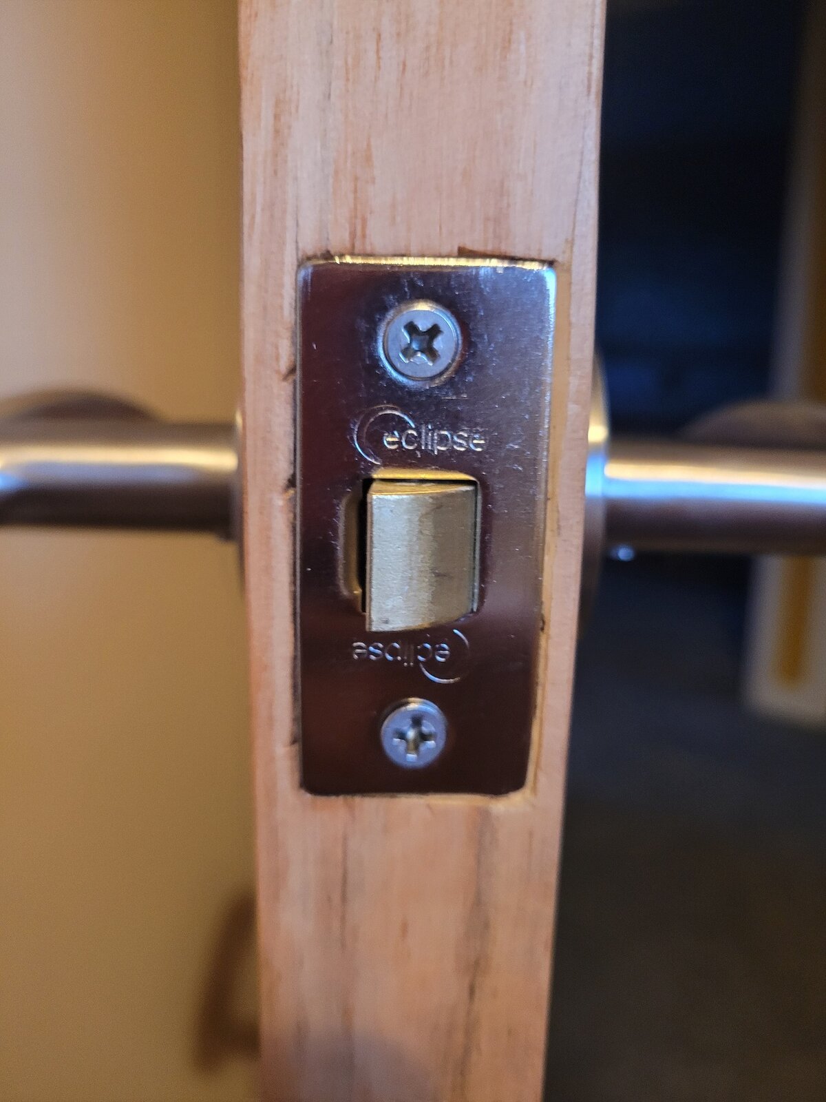

This is how the latches are now. I can't say I'm happy with then still tbh or am I being over fussy?
I'm tempted to offer him half his money and walk away from it. There's no way I'm paying him full price for that finish
For the price he is charging, no.
At least he tried, but filler generally isn't the way you sort out problems - it's how you (try to) cover up mistakes - and even there I don't think he has succeeded (e.g. photos 2, 6 and 7 - out of alignment keep body drilling still visible, photo 3 - gap at top, photo 4 - dog rough edge to faceplate recess, etc). To me the fact that he came back indicates that he knew he hadn't done a good enough job. TBH this is the level of work I expect to see on lower cost new builds with painted doors (where standards are lower and this sort of thing often passes muster), but for the amount of money he is charging (effectively more than £300/day), he really needs to up his game and stop thinking that he can get away with this level of workmanship
He also quoted 2 men for one day and he's spent approx 8 hours here on his own which is half the labour he quoted
