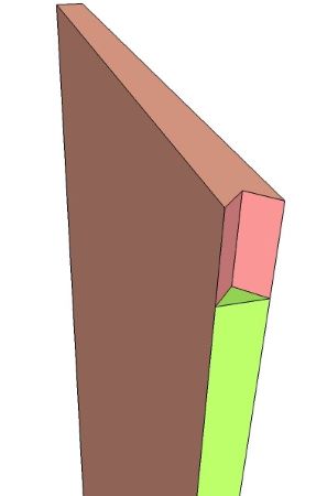

Having looked closely at that I think that a good "plastic man" might be able to blend in a straightforward lipping repair providing the grain is similar, but it may always be visible to a degree, and the plastic man will likely add £250 to £300 to the job (that's for half a day's work, but they are generally worth the money to us on big jobs). The only way I can think of to make a near invisible joinery repair is to use a triangular section repair pieced into each door leading edge (or an invisible lipping - the green piece below):
But I'm pretty sure it wouldn't be doable on site, as it really requires a workshop with a spindle moulder, so I'm beginning to think that the only satisfactory solution may well be complete replacement. Out of interest I also had a look at my PL and PI insurance, and went onto the Hiscox site, to confirm what I already thought - namely that neither insurance covers any claim arising from defective workmanship. There is a presumption of competence. So if he doesn't cough-up you may well end up at Small Claims.
