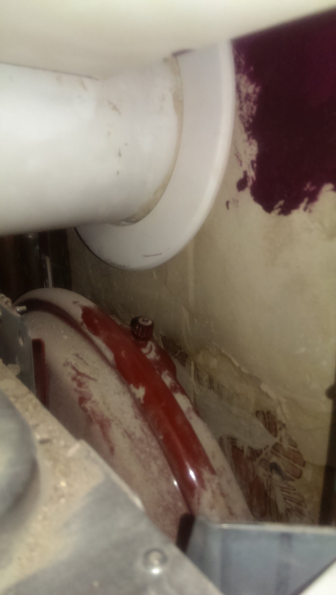

Noticed a water drop from the pressure relief external pipework from the combi (Worcester Greenstar 25Si) this morning. Pressure when heating was off after being on, slowly went to almost 0 bar. No air in radiators, topped up to 1 bar and heating back on and confirmed PRV activated and above 3 bar pressure. I have an internal expansion vessel at the back of the boiler as part of the fixing frame and can just about reach the air valve.
Gave the air valve a little press and immediately water came out of it. It that a 100% guarantee that the diaphragm is no good and the vessel needs changing? Re-pressuring the vessel isn't going to achieve anything (except maybe a short term fix?)

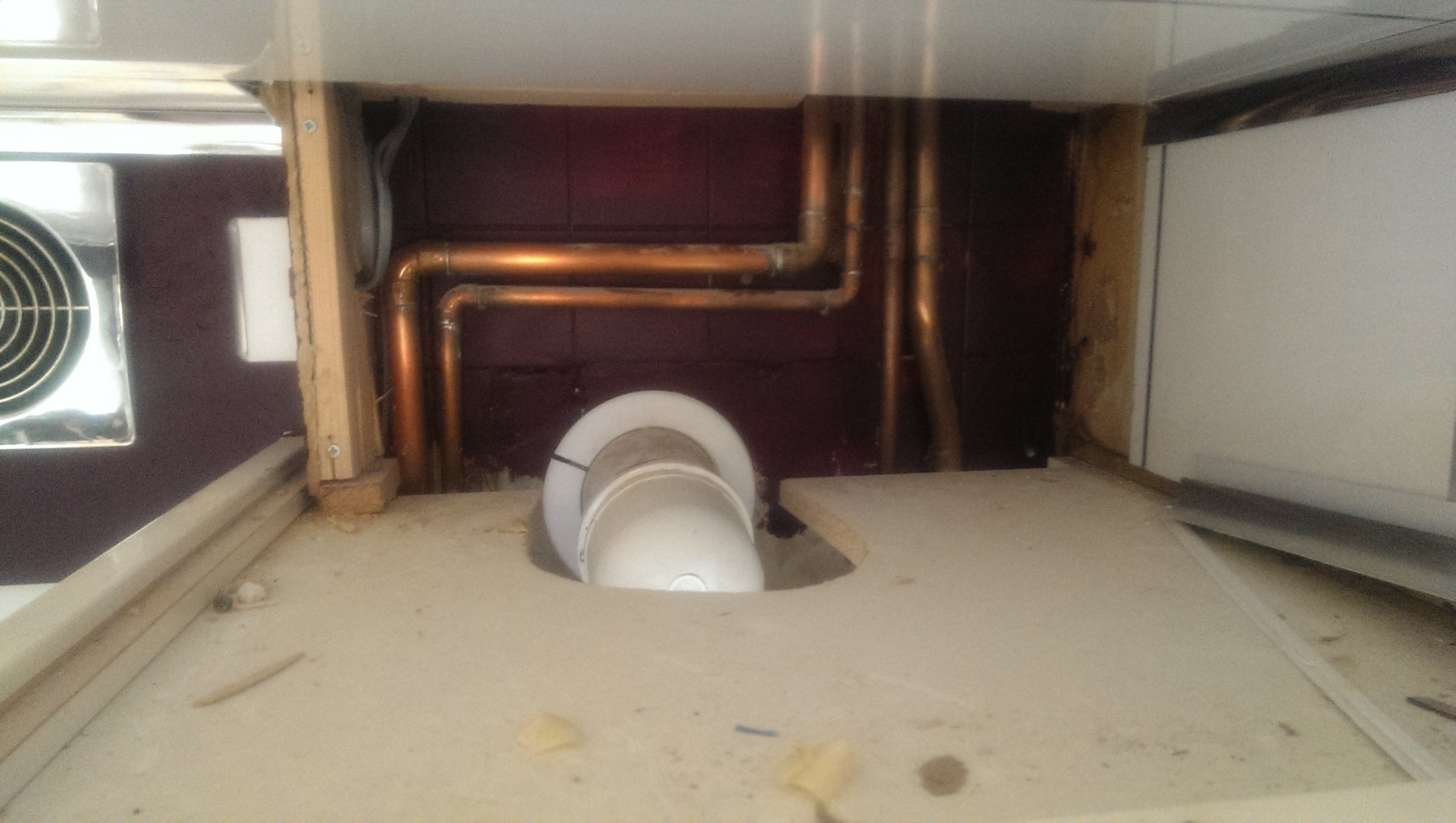

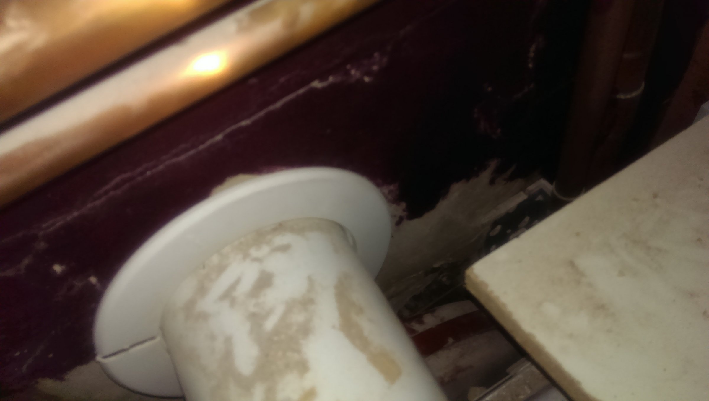

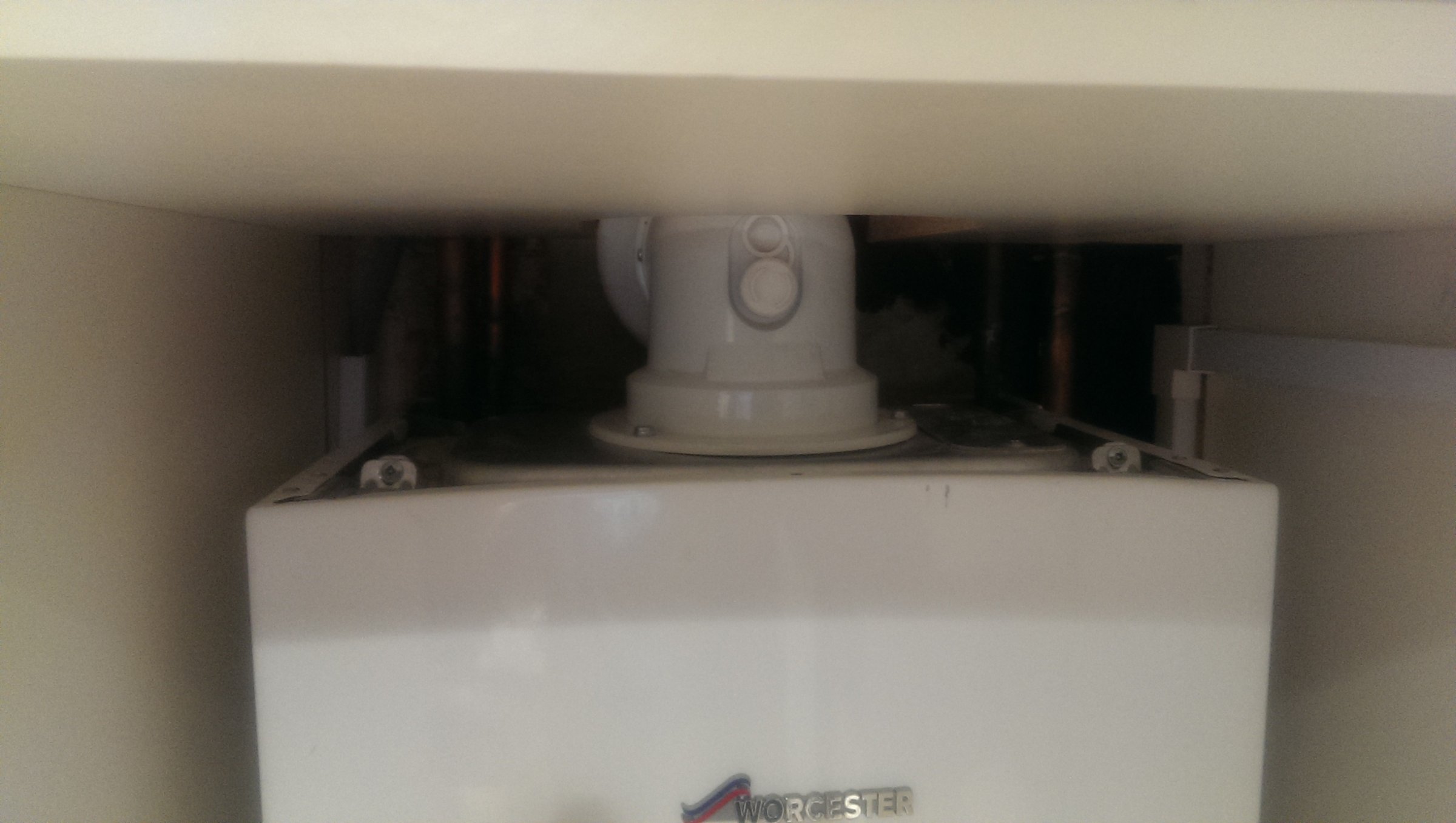

The boiler is housed inside a cupboard and the flue goes out over the top of the boiler, so they cannot do an in-place replacement of the vessel without either taking off the boiler or could they remove the flue and go above? If they remove the flue should they replace any gaskets/sealant with new? Or is this not required/applicable for this part?

Few pics so you can get idea of what space is like.
If there's water where there's supposed to be gas then yup 99% guaranteed the EV's membrane has gone. If that's a void/empty space above the boiler cabinet then a remote vessel could be installed on that return pipe and the vessel located in that space and then a piece of board matching the cabinet put on the front to hide.

@omega015 just because water was ejected does not mean the vessel is FUBAR. They are prone to condensation and will always hold a bit if water.
What you need to do is isolate the boiler, drain the boiler side of all pressure, leave an open end (drain point) and then test pressure in the vessel. Pump up vessel with the open drain point open to MIs. Normally about 0.5bar. If this holds then vessel is all good.

There is often a little water on the air side.
If it has lost all it's air pressure then you might well get 10-20 cc of water out.
So my advice would be to let the water out and see just how much you get.
If the diaphragm was holed ( very rare ) then the water would keep on coming as it would flow from the heating side.
In most cases only a limited amount of water comes out and then it is possible to repressurise with air. As long as this is done with the system depressurised all the time you are pumping it up.
All this can be done by a DIYer when the EXV air point is accessible without opening the boiler sealed cover as in this case.
If you try to leave it to a boiler cover firm you run the risk of them trying to get out of it as changing an EXV like yours can be a big job sometimes meaning removing the boiler from the wall.
Most independents would add an external EXV instead of replacing the one in the boiler if that was more work.

Most manufacturers have the foresight to put the expansion vessel where it can be removed without the boiler coming with it.
I'll fit external if it is more practical than internal, usually on worcesters. Also it is quite common that the internal ev in undersized anyway.
Op I don't think you've got enough height/space even with the flue out do they'll probably have to take the boiler off the wall
