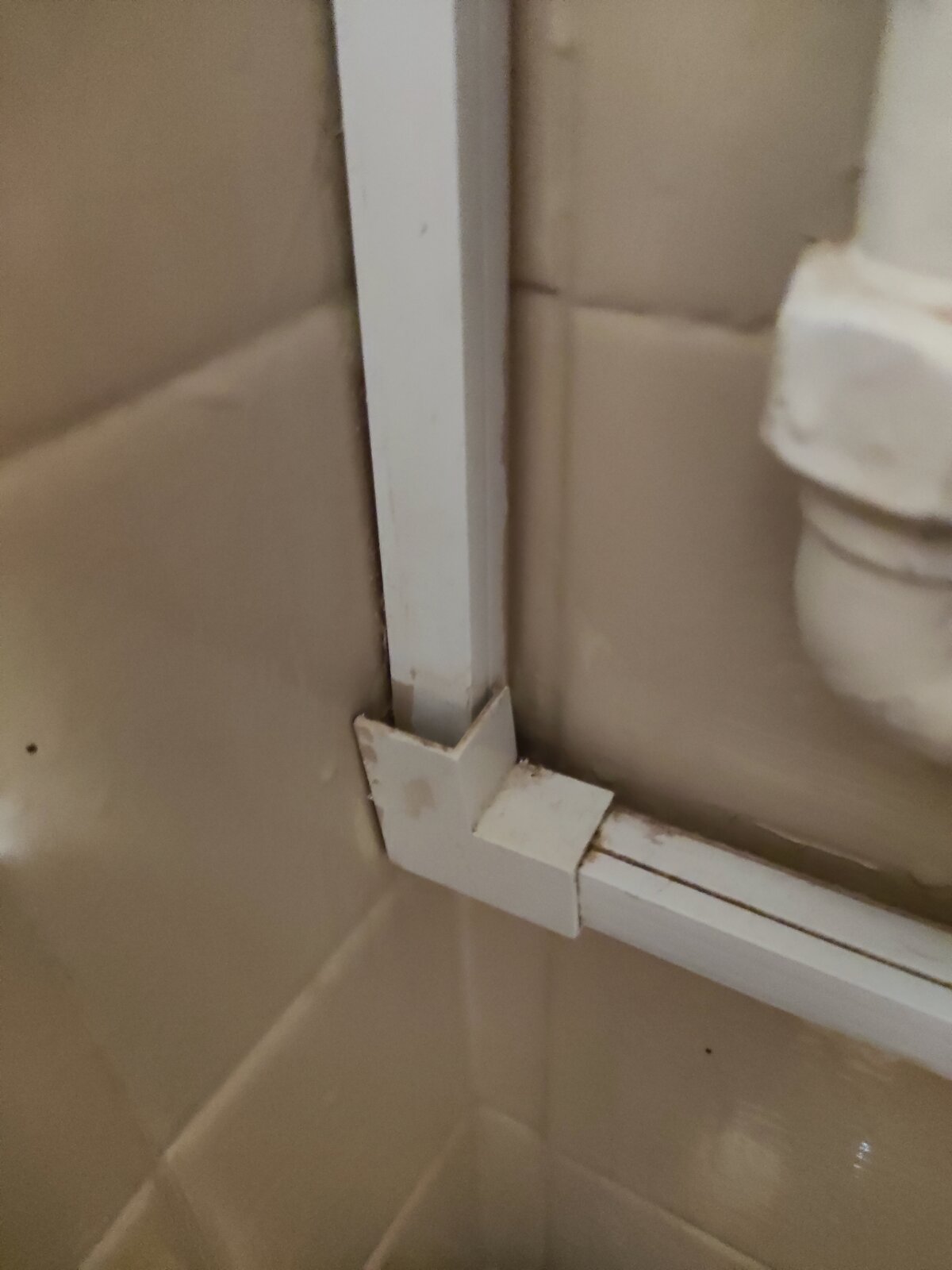

So the electrician tells me that the bonding has to be encased in trunking, it can't just be a plastic coated cable through my flat. Which, if it looks like the trunking that was placed in my bathroom (see photo), is liable to look pretty awful. It seems to have a tendency to fall off the wall. Are there any better options?
Although trunking can often look better than that (I tend to not use those awful knuckle joints but just trim the trunking itself to size/shape). Another tip , a long run (example floor to ceiling can look better than just half way etc)
Bonding conductors do not have to be in trunking.

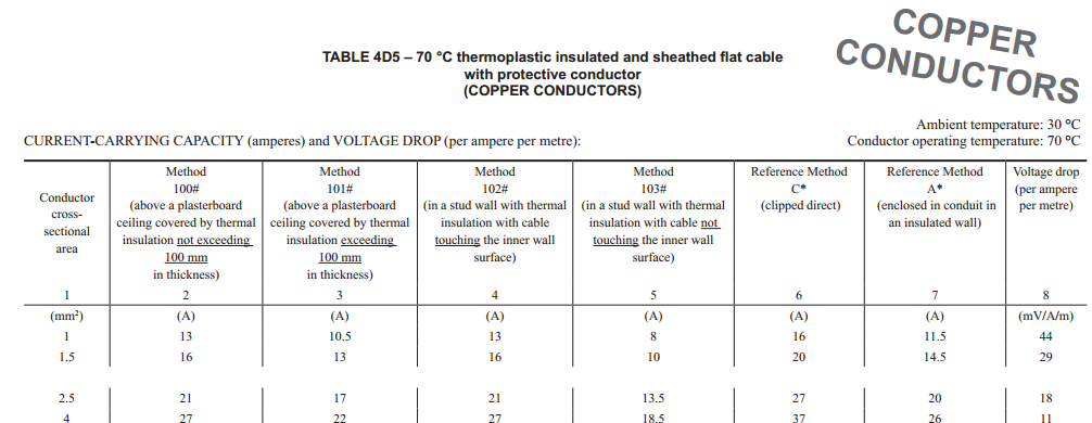

Thanks. Any authority that I can give him for that? Or is it just that there's nothing to state it has to be in trunking? Here's what he says:
"The trunking is used to enclose and protect the wiring. We cannot run wiring clipped direct to walls/ceilings."
Rules rarely state what is not prohibited.
It will be up to him to show where it is prohibited.
Whilst that is true -
It is done all the time for all wiring.
Clipped direct is one of the installation methods - Why else would he use that phrase?
From the Wiring Regulations; Method C:
