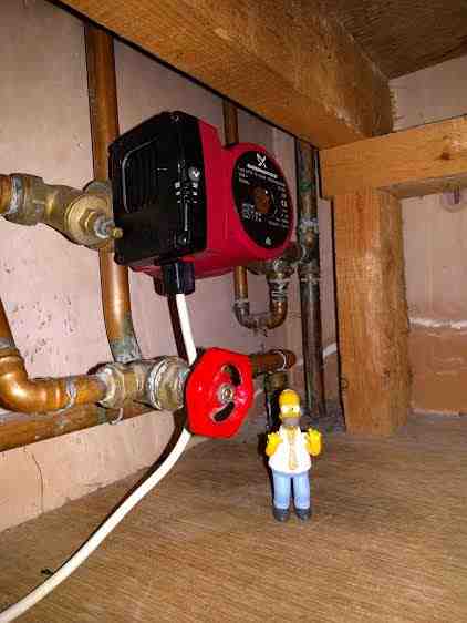

It's difficult to see in the pics, but what, exactly, is preventing the pump being installed with the shaft horizontal?
If it's the control box on the side, the head can be removed and rotated 90 degrees clockwise so the control is on the top.
I'm not sure why they tilted it, I had a brainwave this morning and moved it by using the nuts on the isolators and moving the whole thing, there was nothing stopping it being horizontal, I'm not sure they weren't trying for vertical...
So now it's horizontal, however it's still the same, not starting correctly, so that doesn't appear to be it
Here is a pic with Homer to show orientation
Also checked the coltage and it's fine, 245V AC continously, no sign of a colapse when the pump is trying to start
I do hope they were not trying to do that! It would kill the pump very quickly as the top bearing would not get any lubrication.

There is clearly something not right. Now the pump is at the right angle that should have eliminated it from the list. I would have estimated the previous angle as almost 45 degrees above the horizontal.

I'm now thinking a dodgy pump housing might be the issue, I've worked out a way to close the isolator valves so I'll try getting inside to have a look....
I measured the voltage at the box the wire goes to, it's a cheap connector block and the inputs appear to be from the boiler and the orange wire from the three-way valve, and it was measured at over 240V when it tries to start, rock solid, no dip.
It was on 3 and I've dropped it to 2 with no difference, I would say it's now sticking after a shorter and shorter period, also tapping the right spot on the back of the pump seems to get it to go straight away
