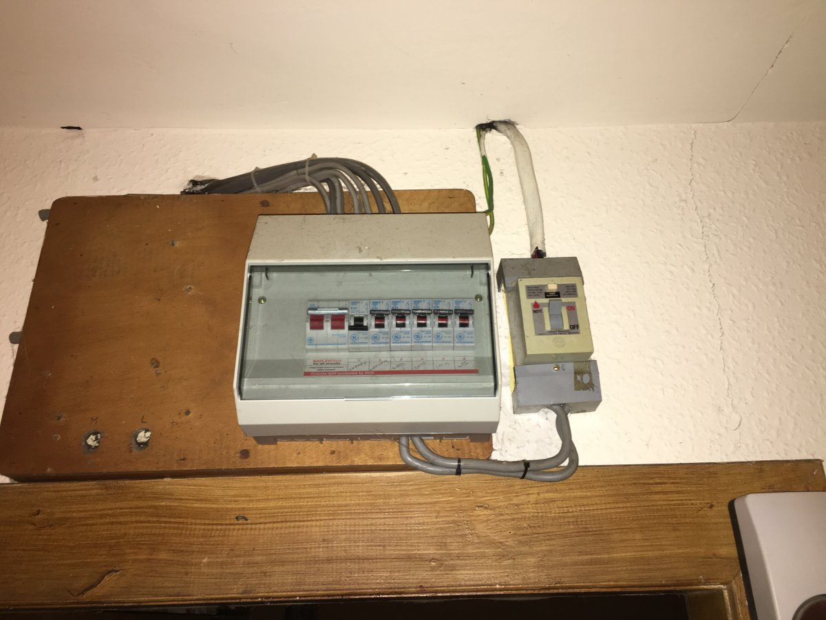

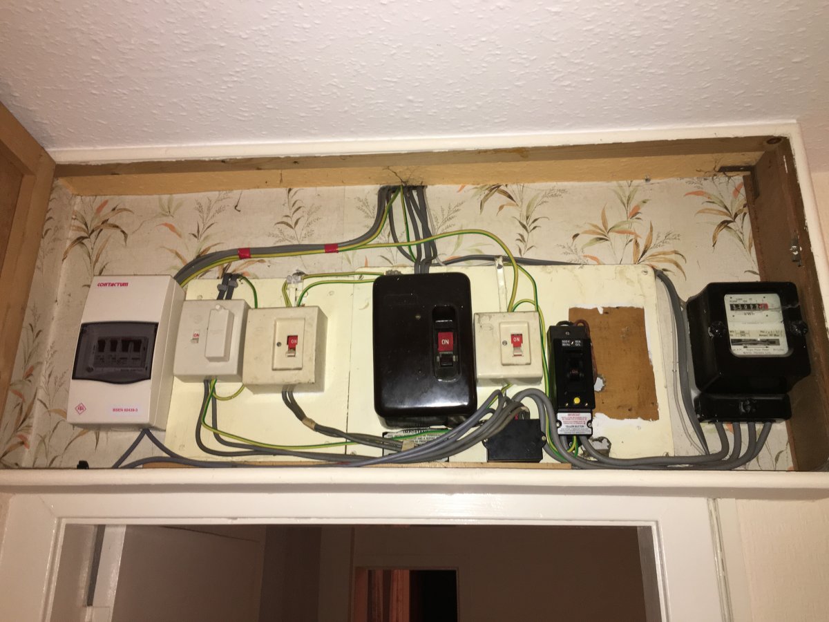

Here are the two CU's after that outside meter.
Not managed to get into loft yet to find where the joins are.
The first picture shows the typical array of switchgear where things have been added over the years. It's likely the black MEM unit (more or less central in the photo - it has multiple fuses inside) was the original, and the other individual switch-fuses have been added over the years, mostly 1960's & 1970's. It looks as though one or two may not be used for anything now, but can't be certain without more detail. The Contactum unit at the far left is much more recent. You have an old voltage-operated ELCB (Earth-Leakage Circuit Breaker - the black unit with the yellow button on it) into which power is being supplied at its top. I can't quite make it out, but it looks as though that might be older rubber-insulated cables entering it from through the hole in the back board. This whole lot is something of a mess, and presumably now it's all as one house you wouldn't want the separate meter either.
The second picture shows a more recent work and that certainly looks like T&E feeding the RCD on the right. You commented earlier that there were two meters inside the house - I don't see a second one in these pictures though.

That Feed into the VOELCB looks like rubber (??) and the single insulated conductors are visible.

I wonder if the supply in the VOELCB trip pic was or still is overhead? Sort of got that 'look' about it.
The cottage is rural (ish) Scotland. But no overhead supply, I have already checked this, and only telephone is on a pole. It is all very odd.
