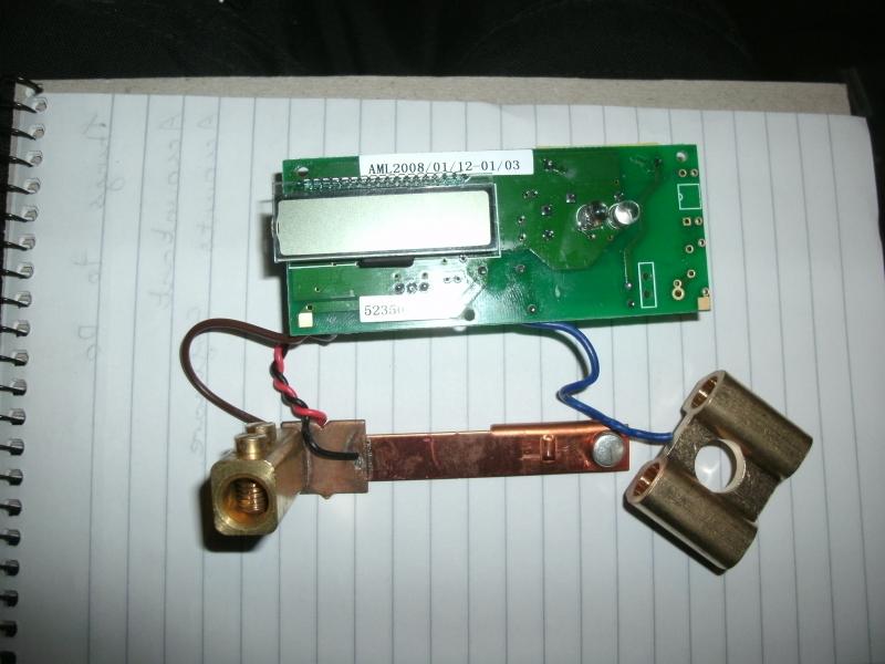

I think i have a siemens meter somewhere, i will pull it apart later and check but it is allmost certainly SP

How is that meter doing 'metering'? Most of the load current is obviously going along that copper bar (the 'switch') - is it just monitoring the voltage drop across a short length of that bar, via the red/black pair (and monitoring the voltage between the blue and brown), or what?
I am not sure of the actual working of the unit but i will take another picture of the reverse of the parts so you may be able to see something there.
Thanks. A close-up of where that red/black pair meet the copper bar/strip might be interesting. If it is measuring current by voltage drop along that short segment of the bar, considerable precision in the attachment of those leads would be required to get reasonable accuracy!

I thought there would be a pick-up coil, or some kind of solid-state sensor.

Or a non-volatile case-by-case calibration setting in the processor.
Yes, I suppose that would work. It would presumably needs some temperature compensating measures, too.
