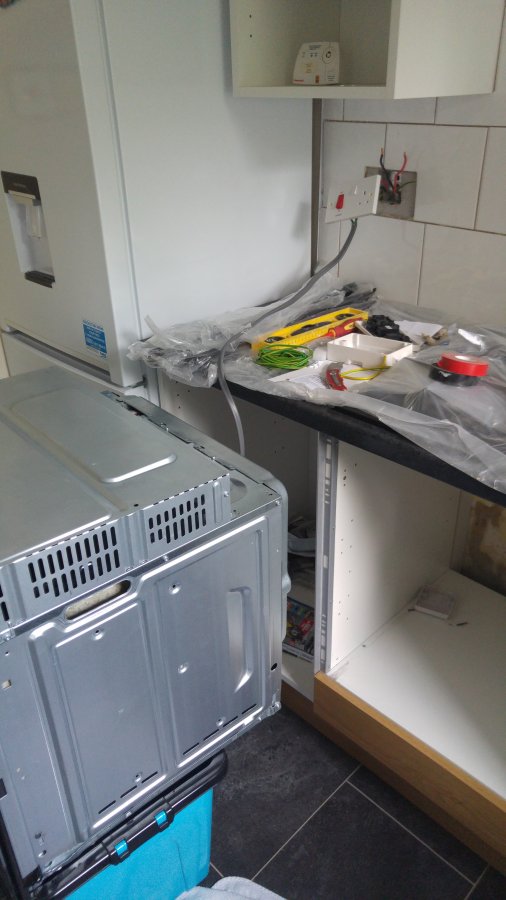

Hi all,
Got a new oven to replace old in a like for like (6mm T&E from oven to wall and cooker switch on wall) but as soon as switch the cooker switch on the whole circuit in the house trips (RCD).
I've double checked all the connections, everything seems fine. The cooker switch has a plug socket in it witch works fine too.
Any ideas what else I could check before I need to call an electrician?
Cheers,
J

Yes thats what i meant, whatever the case the Bosch engineer has just been and connect an normal plug to it, plugged it in and it worked, he said the oven is fine and there might be an earth leakage?
Well, if an RCD trips there will be an earth leakage; that's what they detect.
I presume the engineer replace the 6mm² cable - you won't get that into a plug - so has he also, perhaps inadvertently, repaired a fault?

I'm not home yet and theres no point asking my wife! I'm not sure if he wired it back into the cooker circuit so i'll check it when I get home.
Well I got home and tried the oven, still tripping the RCD. I wired the oven directly to the switch but no luck.
Didn't see any visible nicks in the cabling.
I did have the consumer unit replaced recently so don't know if its the wiring in that?
Here's some pics:
Straight in to the switch to bypass the chased cable in the wall (The plug is working in the cooker switch hence my theory here)
The recently installed consumer unit - there was no cooker at time of install so the cooker circuit would not have been tested!
