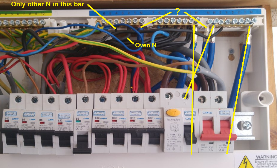

I was thinking that too, but I am counting too many big blue wires in the right hand bar - there should be one from the main switch (far right N) and one going to the top of the RCD, but there's three there.
It is as if it was a high integrity board and it got butchered (badly).
I'm just wondering if there is not enough loading on the lights to trip the RCD as they are in the left hand neutral bar too.
A lot of IFs, so I may be wrong - but
If the Oven N is the cable marked AND
the blue tails marked with ? are the same cable (or it may be the other one), then
the right hand side of the blue tail should be in the neutral bar to the left (middle one).
Also there is only one other wire in Oven N neutral bar, so if you can find out what that supplies then it too should trip the RCD - if I am correct.
I would liketo see a pic with the busbar cover removed (turn off main switch before doing this, John).
From what i can see it has been done as a split load configuration. Counting from the RCD, MCBs 1 through 5 are on the RCD (up to the B6 which is off). The rest are not RCD protected.

There should be TWO RCDs in that box!
The whole thing is a complete horlicks, and I agree with Spark123, it smells of mixed up neutrals. He hasn't followed the terminal marker numbering, for some reason too.

I think the big blue wire which feeds the RCD in that board may be smaller than the one between the right hand neutral rail and the main switch so piggybacking middle to left bar may not be a wise decision.
I want to see the busbar, and see if it is split, or in one piece!
If it is split, I wonder how it gets its line, probably from the bottom of the main switch?
If it is split then (as EFLI's pic) the tri-rated neutrals in the 'raw' (right hand) neutral busbar will be (from the right)
Neutral in, from main switch
Neutral out to RCD in
Neutral out to left hand (N2) busbar
His lights trip with the RCD so I'd say the busbar will be in one piece up just before the left hand 16A MCB (boiler). This is somehow fed separately with the neutral for it being the black wire in the right hand neutral bar.
Your 100% correct. There's a live wire going along the bottom underneath the plastic to boiler MCB.
That's what I suggested!! Not that I'm being competitive (get outside now, we can sort it out in the car park!!)
Oh. I see now there may be more Ns in the left bar but same difference if not used.
Correct - i think these are for a dissused alarm system I'll try disconnect them tonight. Or should I move the oven to the other N bar?

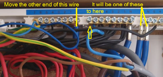

You could do that -
OR
If you feel comfortable doing it, all that needs to be done is:
That is - connect the left N bar to the middle N bar instead of the right N bar.
That is the only fault.
