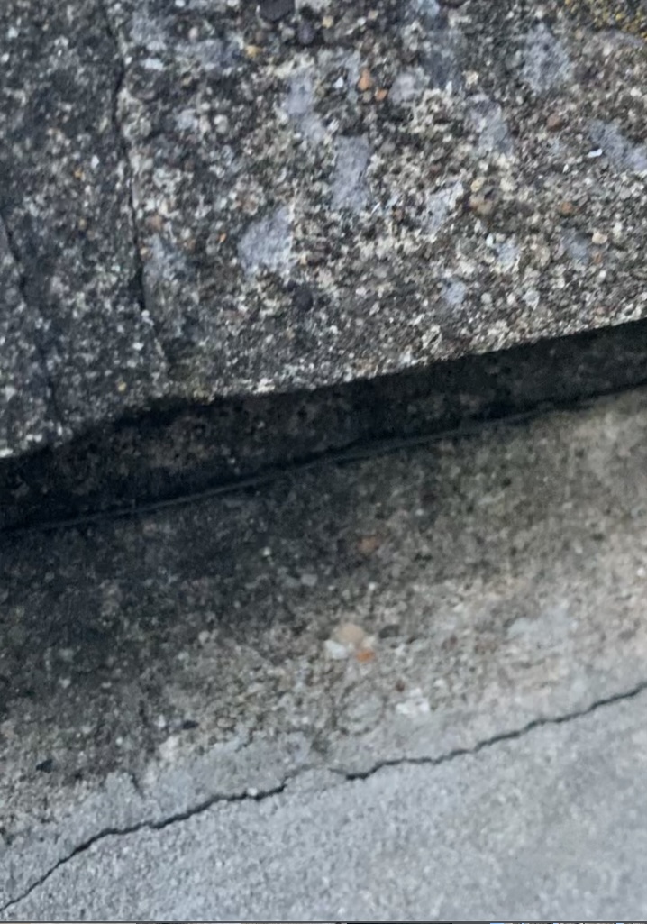

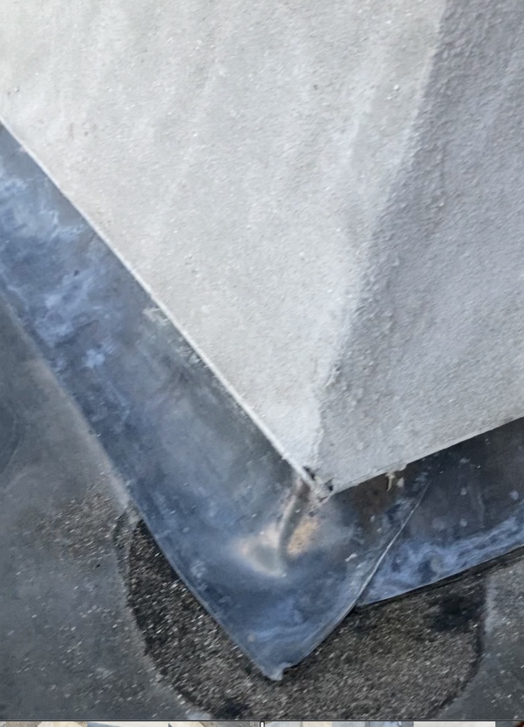

Hi all.

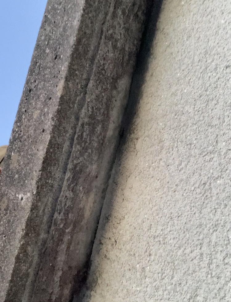

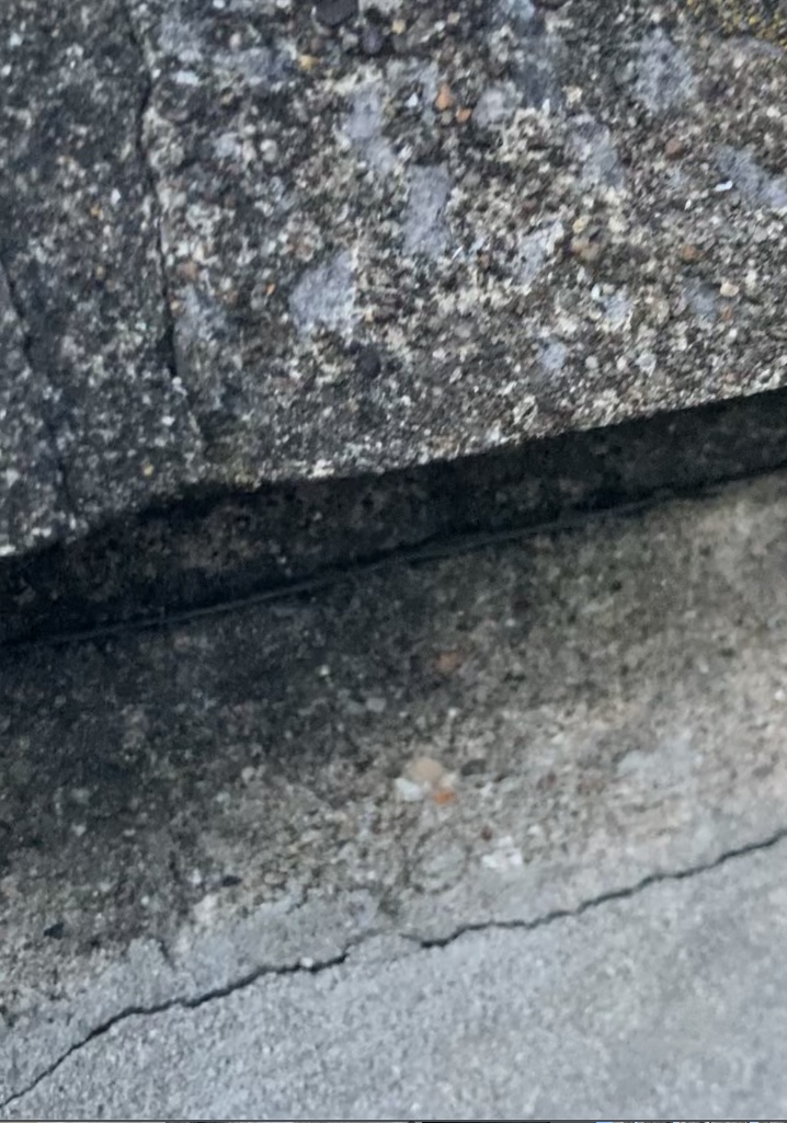

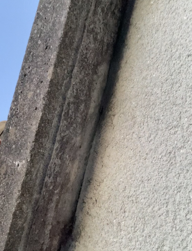

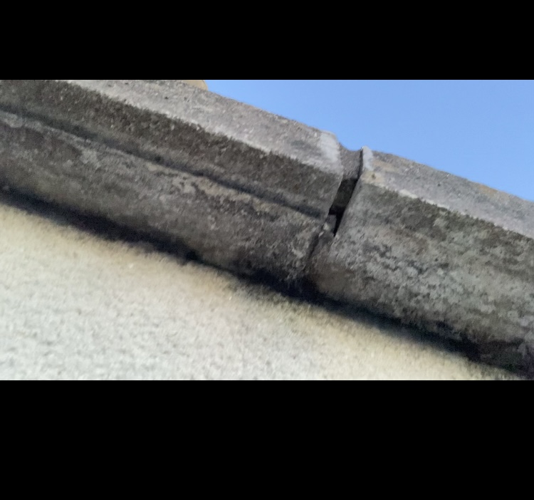

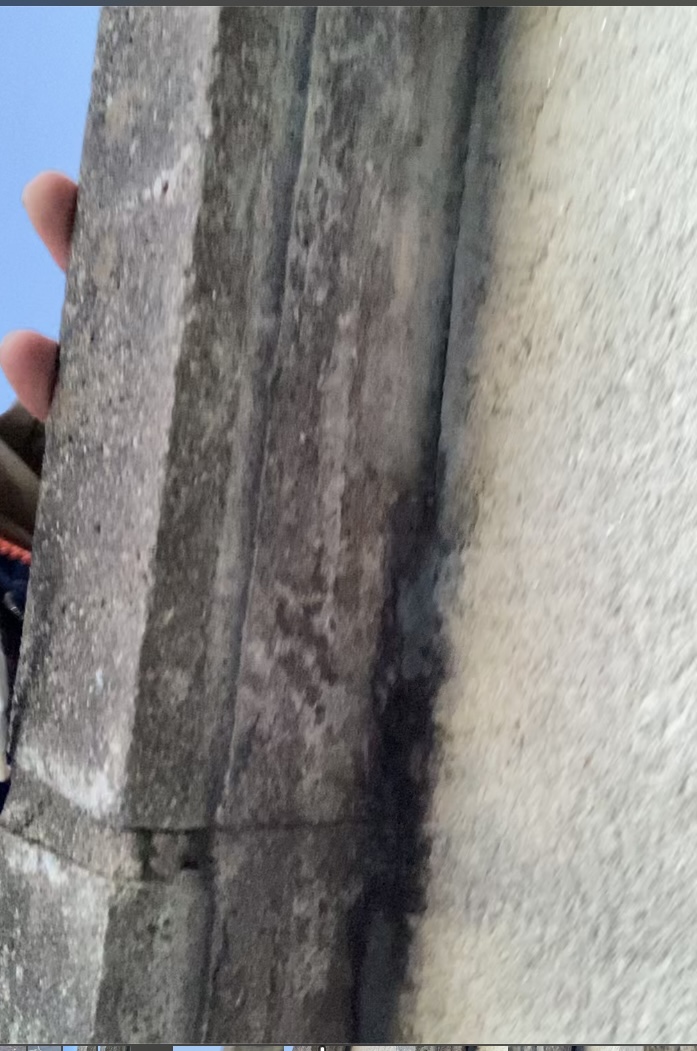

Sorry for the delay in reporting back.
The render on the inside. It’s freshly done but I can see cracks and some of it does seem to sound hollow. I forgot to check the render on the outside (doh)
Clíp around the vent is good

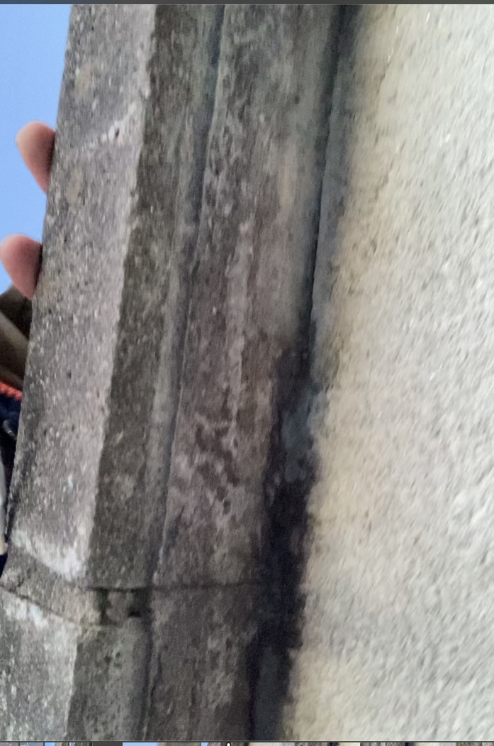

Width of the overhang is a good 80mm.

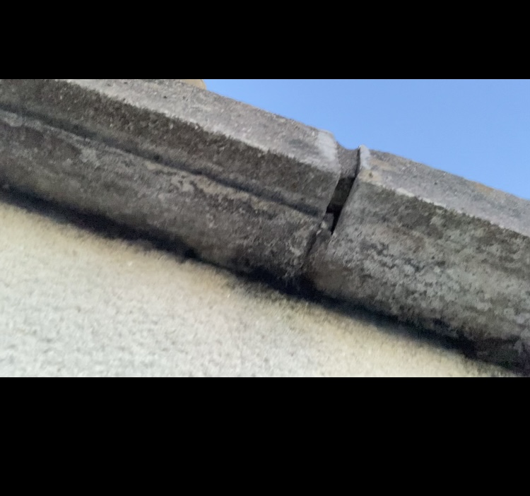

There is a channel but it is bridged in some places. See pics.

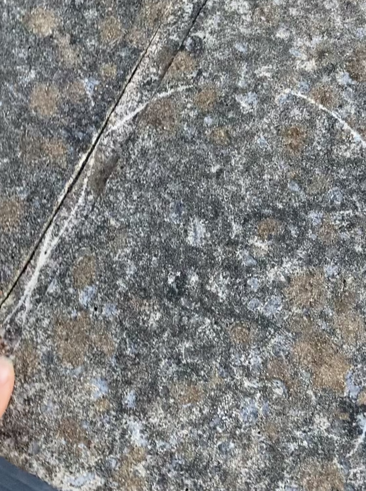

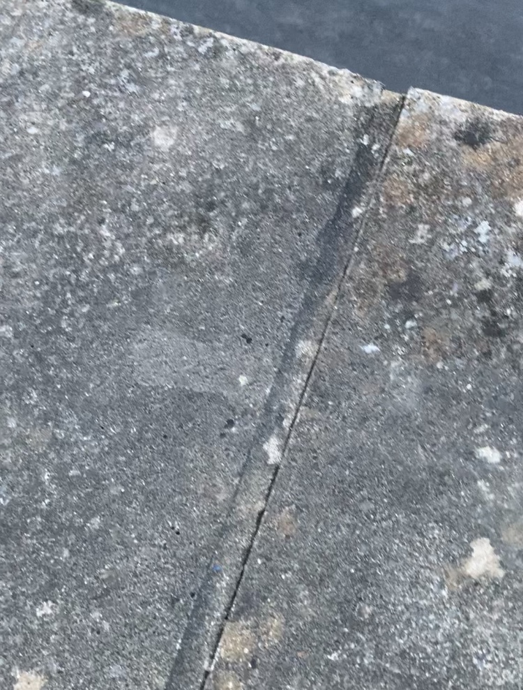

The mortar between copings doesn’t look the best. See pics.
There is however a dpc under copings see pic.
There has been a tarp over it and no further leaks. Although not great deal of rain.
We’ve had one quote and they say the original job is good and that it needs a mineral felt covering over the coping stones. However I’m not sure on that. I just can’t see how this is the problem if there is a dpc? Can the dpc fail too as well as mortar?

Coping butt joints need attention regardless of the tray (DPC) total hack out and tightly pointed and knocked back.
The tray is liable to failure as its cut short and will allow water to track back in. once it starts it will get worse.
Cracks in render need dealing with too.
One can only guess what has been done at the epdm upstand to render area.
I would keep things covered until its been truly tested.
It doesn't look to project out appreciably beyond the render so water reaching it would spread out until it reaches an edge then be able to transition from above side to underside without dripping off clear of the render
