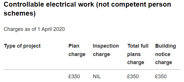

I saw that post, and not convinced those were really the LABC charges, the idea was in England to allow each local authority to set their own fees so to reduce the charges for Part P work. .... However in Wales the £100 plus vat does not include the cost of third party inspectors, so if the LABC employ an electrician to do an EICR then the home owner is charged for that on top of the standard fee.
Indeed. The £500+VAT we heard about seemed very high, but I think that most LA's in England charge a lot more than the £100 you mention for Wales.
This is what my LA currently says (albeit dates from April 2020). Note that the £350 is the same for a "Full Plans" application (which few people use) or a "Building Notice" (which is what most people use), that the the figure includes VAT and that, in contrast to what you say about Wales, the fee for 'inspections' is "NIL".
