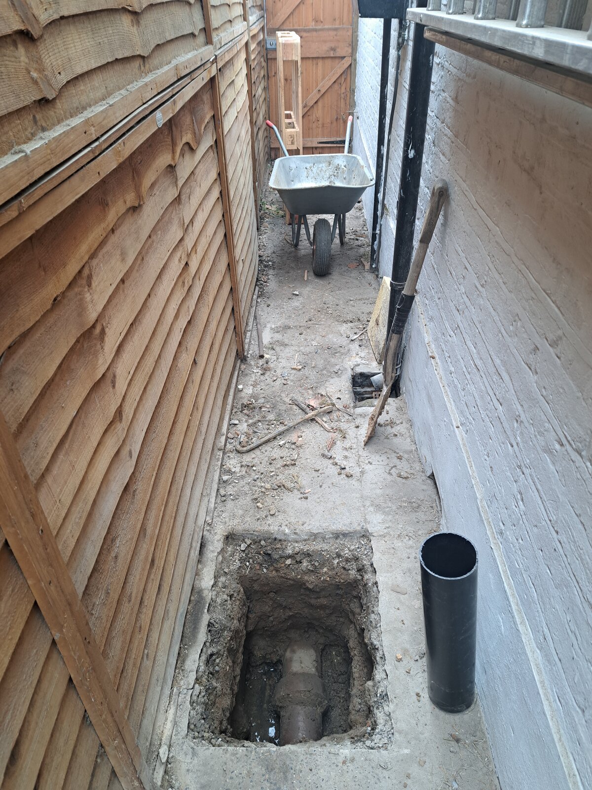

That's the access with approx position of new stack. Can't really move the wall or fence, though can dig up more of passage to make it longer.

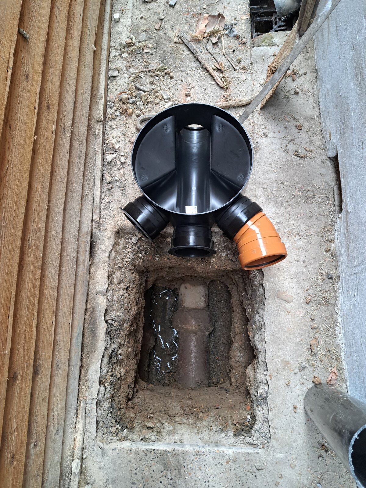

I've just offered up the 320mm inspection chamber and it's better than I thought:
And yes TS gave me a 30 not 45 bend, although I'm wondering if it could work to get rest bend right against wall.

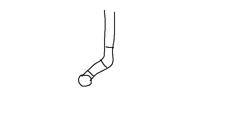

No, what I'm suggesting is, come down vertically with the new Stack, fit a junction into the existing pipe, then use a slow radius bend on the bottom of the stack to angle it across to line up with the main run. You haven't got enough room for a chamber, and I think it'll cause more issues that it solves, provided the existing run is accessible, and you fit an Access Point on the new stack, then I don't think you need to do much more.
Excuse my poor artwork.

Thanks Hugh, that is very similar to what I first thought! But I read that a long soil stack coming into an unsupported join like that might get damaged over time with the force of the water (and other stuff) falling from height (at least 4m and maybe even 7m if we go up again).

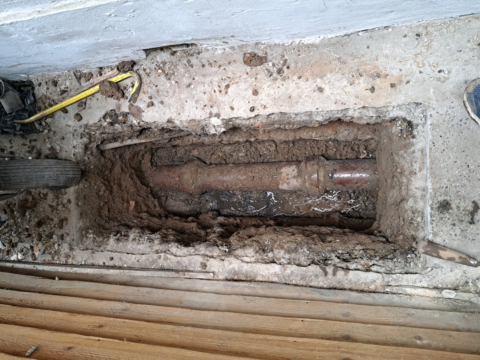

Have dug a bigger hole now:

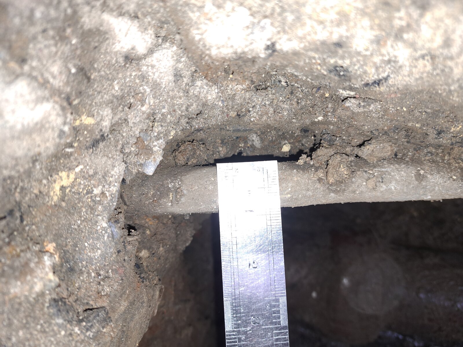

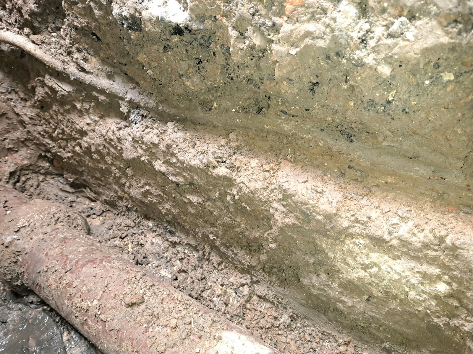

But there is the water main running right where I'd be trying to bring the new soil pipe through:
Lead pipe is just under an inch in diameter by look:
What a pain. It's an old lead pipe I want to replace and run a different route eventually but that is another big job.
My ideas are:
1) cut out this section of lead pipe and make a small detour in new piping. But getting a mains water fix on to an old lead pipe? Do those lead-loc things work?
2) Try to chase out a route for the new soil pipe just next to the lead pipe (even bending it by few cm). But that is going to be very careful work with an SDS and what feels like pretty solid concrete.
3) do something more like Hugh drew above and try to come over the pipe with a branch only (no inspection chamber or rest bend), taking out less of the foundations too
What do you think?
I would go to Screwfix and buy a 45 degree junction, a rest bend and a pile of 15 and 30 degree single/double socket bends (on sale or return), a length of black soil pipe and an access socket and a tub of silicone grease. You have all the dimensions to hand, dry assemble something that fits the space with the straightest run possible. Personally, depending on the heights, I think you'll have to go behind and under the lead pipe to ensure the run is fully rodable or you might end up with a sharp bend to drop down to the pipe - but it looks in good condition and they're pretty durable so you should be able to excavate round it with care.
I would (excuse my drawing) aim for something like this:
I don't do much drainage and always find it difficult to visualise it in all dimensions and get the angles right without the trial and error so I always get it right before I break into the drain. I generally start with something cumbersome and finesse it with a few swaps, twists and turns. If all else fails - it works but the stack entry isn't quite in the right place that's easily sorted later above ground.
Presumably you know how to cut the clay with a 4" grinder? Cut a rectangle along the top, carefully remove it to allow you to cut lower down through the pipe.
Get an end cap as well, then if you're a bit stressed after getting the junction on just cap your new connection and have a beer! It's easy from this point, just tweak your dry run assembly till it all lines up. Make sure all the fittings are fully engaged (witness marks) and none are under stress.
Oh, and a few brackets for the soil stack so you know how far from the wall you need to finish.
Although you appear to be doing outside of the regs, I would buy a bung and do a basic leak test. I'm not an expert on the regs but believe that using the 45 degree junction means you don't need an IC.
Don't worry about the footings, there'll be plenty left.

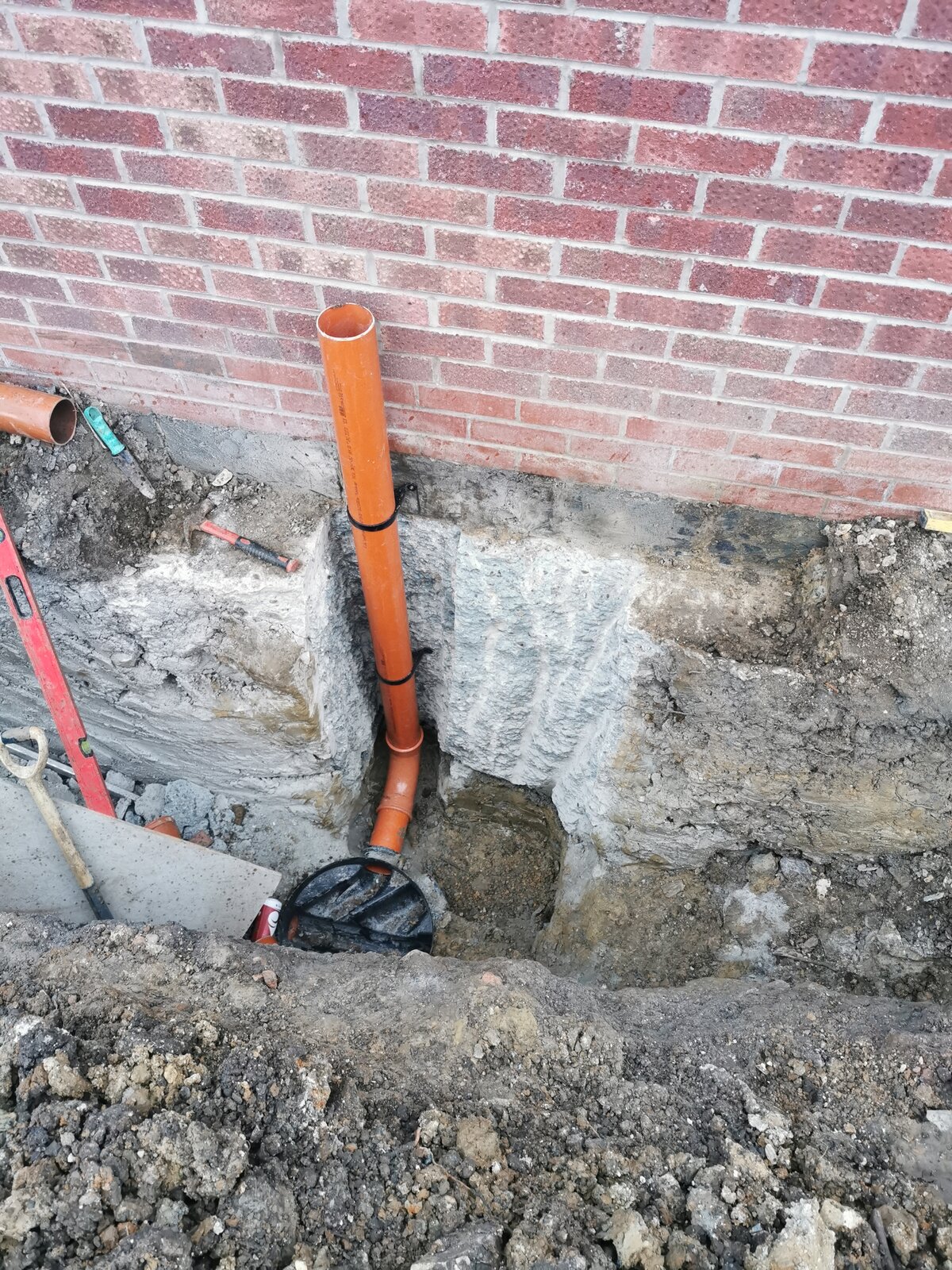

I'm planning something fairly similar with a 45ish degree section under the ground, using a 135 branch+access cap to make that bit roddable. The main fall from 1st/2nd floor stack will hit the 45bend embedded in concrete as pipe goes into ground (and not the buried branch between the old clay pipes). I think I can come in front of the lead water pipe just:
Going to try cutting the clay tonight if weather holds. 4" diamond blade in a grinder, chop top half out like you say (access to sides is v limited).
Have got pea shingle, are there any minimum depths below or above a new branch like this?
Thanks again
Sorry but you seem to 90% of the way there so why not do it properly,
Get the rest of that foundation broken out and a proper rest bend put in to meet the branch then above ground level have a roddable access.
You want to end up with something like that but yours will go into the branch not an ic.
Don't worry about the water pipe too much, get your grinder and cut a channel either side of it, break up and remove everything up to the channel and the pipe should come free enough for you to complete the job.

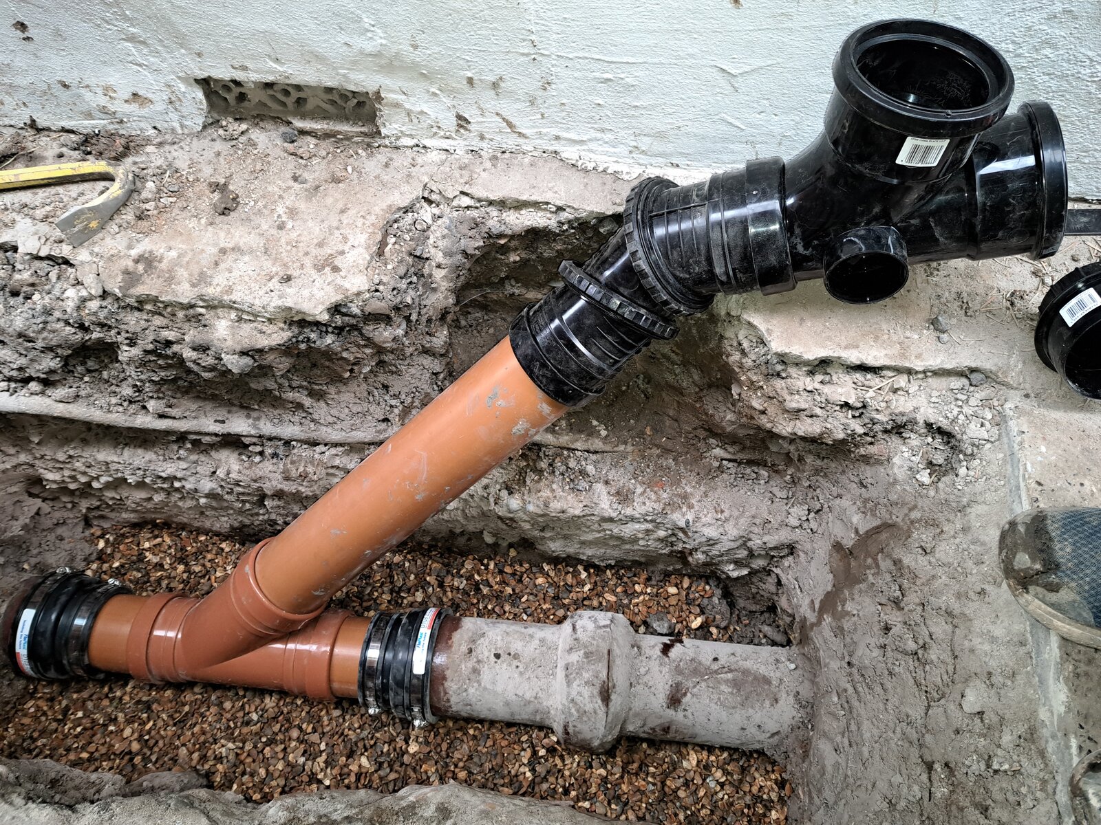

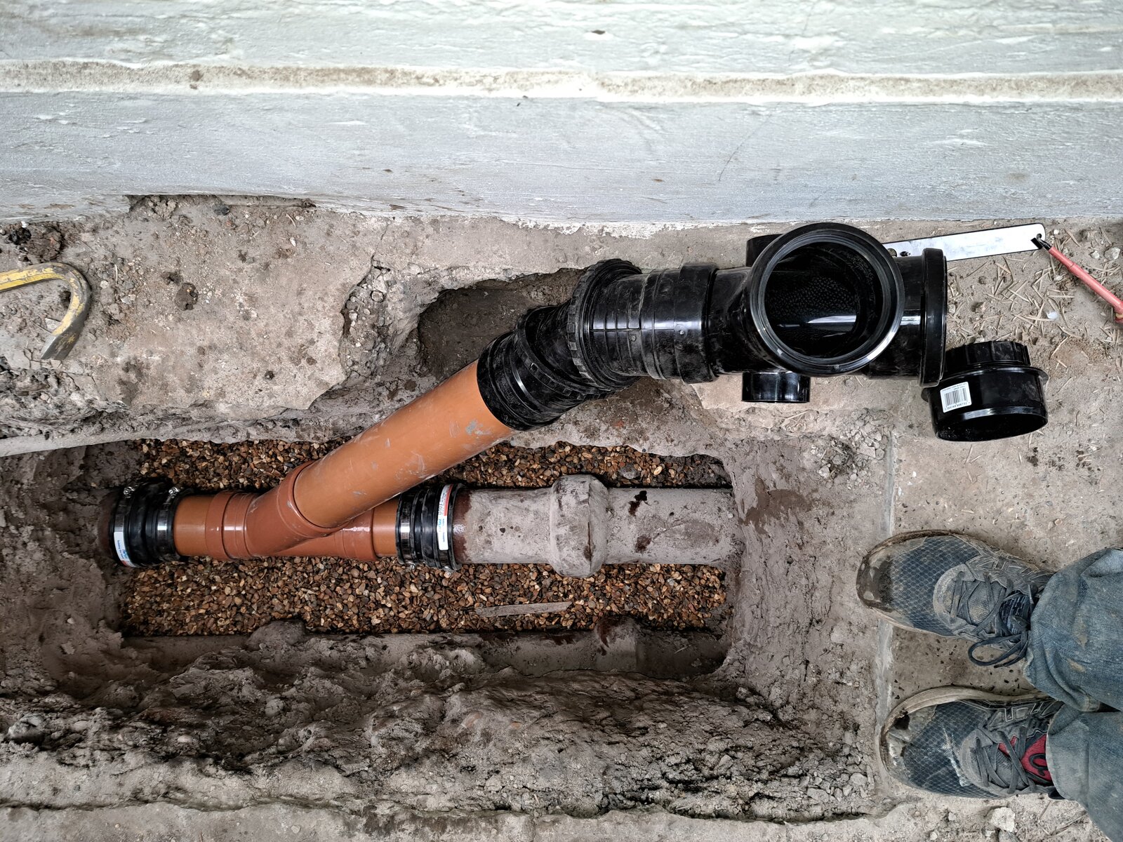

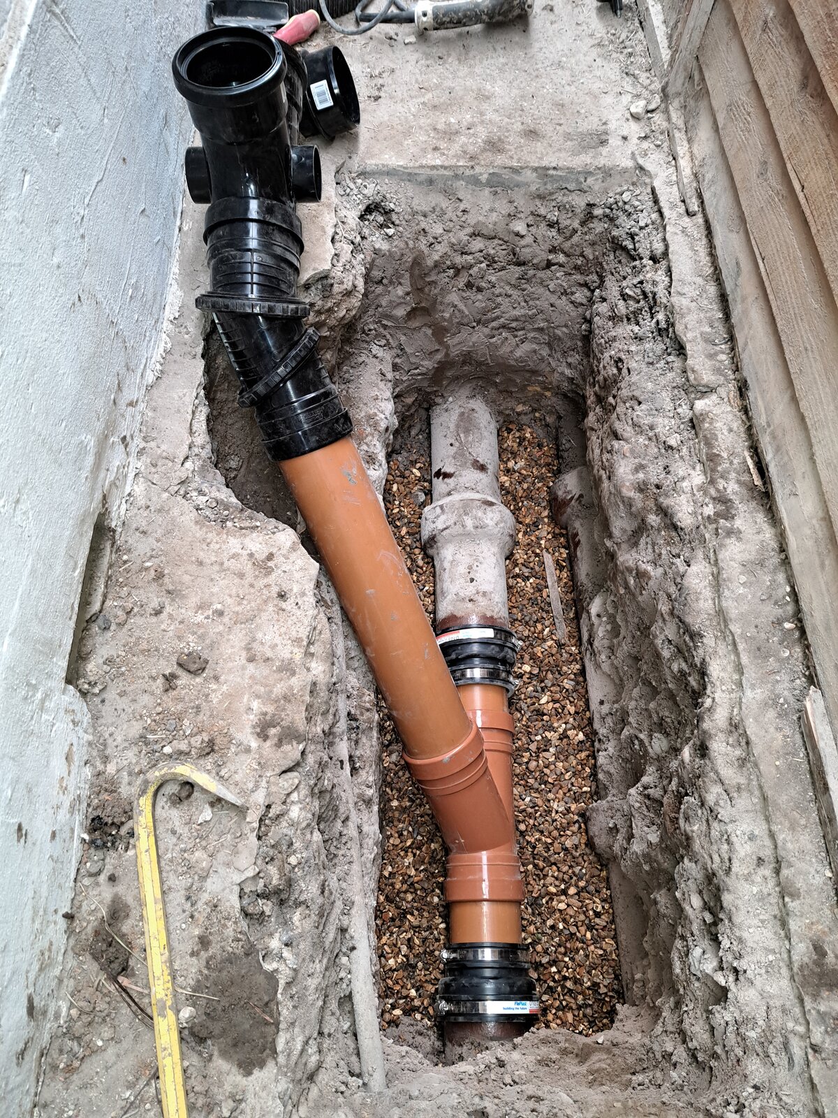

Chopping old pipe went well. Adapters fit pretty nicely. Dug up a bit of cement underneath and replaced with pea shingle.
This is just dry fitted:
I will probably just tighten clamps and block it for tonight. Any problems with this setup?
The 112.5 black branch will have access cap on which gives pretty good rodding access down this new slope.
If this is good, how much of hole should I fill with pea shingle, mud and concrete on top?
I can sit the black branch piece on a blob of cement too, then put a clip right after it up wall.
Thanks so much for advice, even to have got this far without messing up is great.
