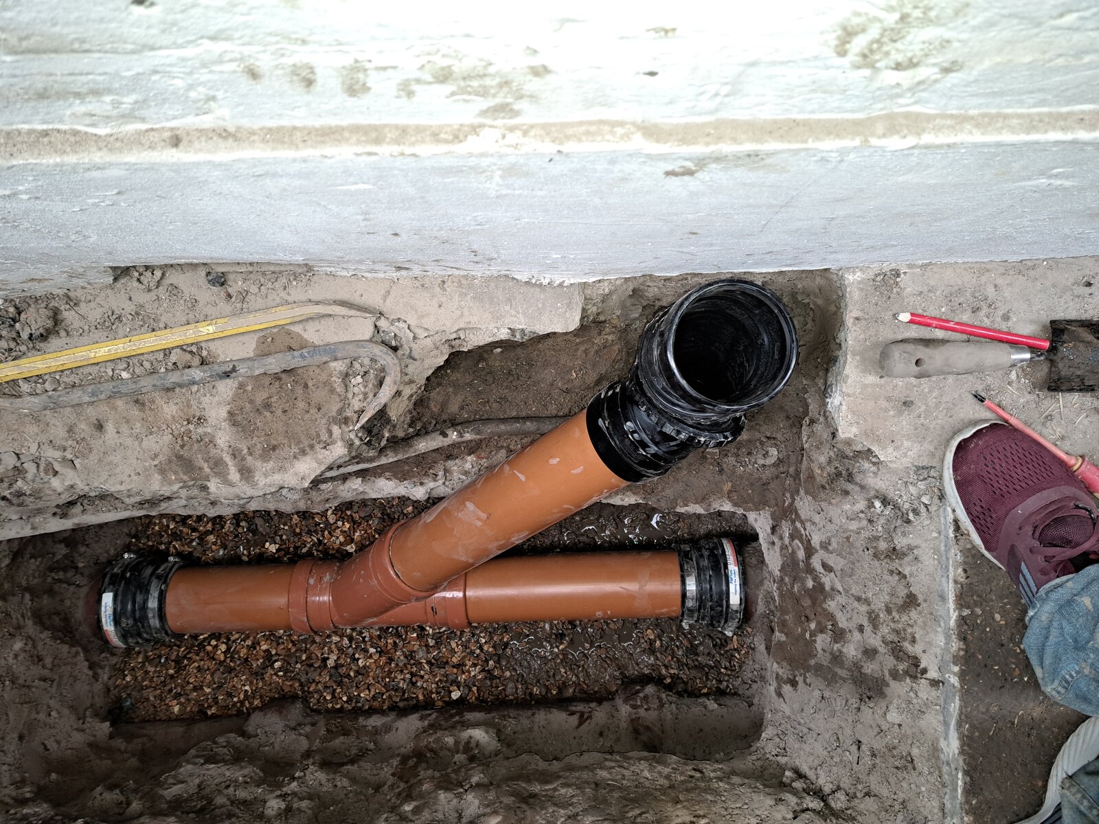

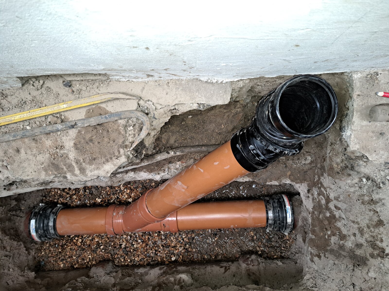

Keep it simple, you're getting over complicated with that setup. Take that junction off, and rotate the adjustable bend so it points upward. Fit a rodding access into that, (https://www.screwfix.com/p/floplast-push-fit-2-boss-single-socket-access-pipe-black-110mm/82593), then head upwards. It is very unlikely to block in that downward section, but better to have the access and not need it.
I would really advise against fitting that junction there. It is likely to cause you issues with noise and possible blockages, the falling waste will hit that, and splatter everywhere, you want to be directing it towards the sewer! Otherwise, good job done.

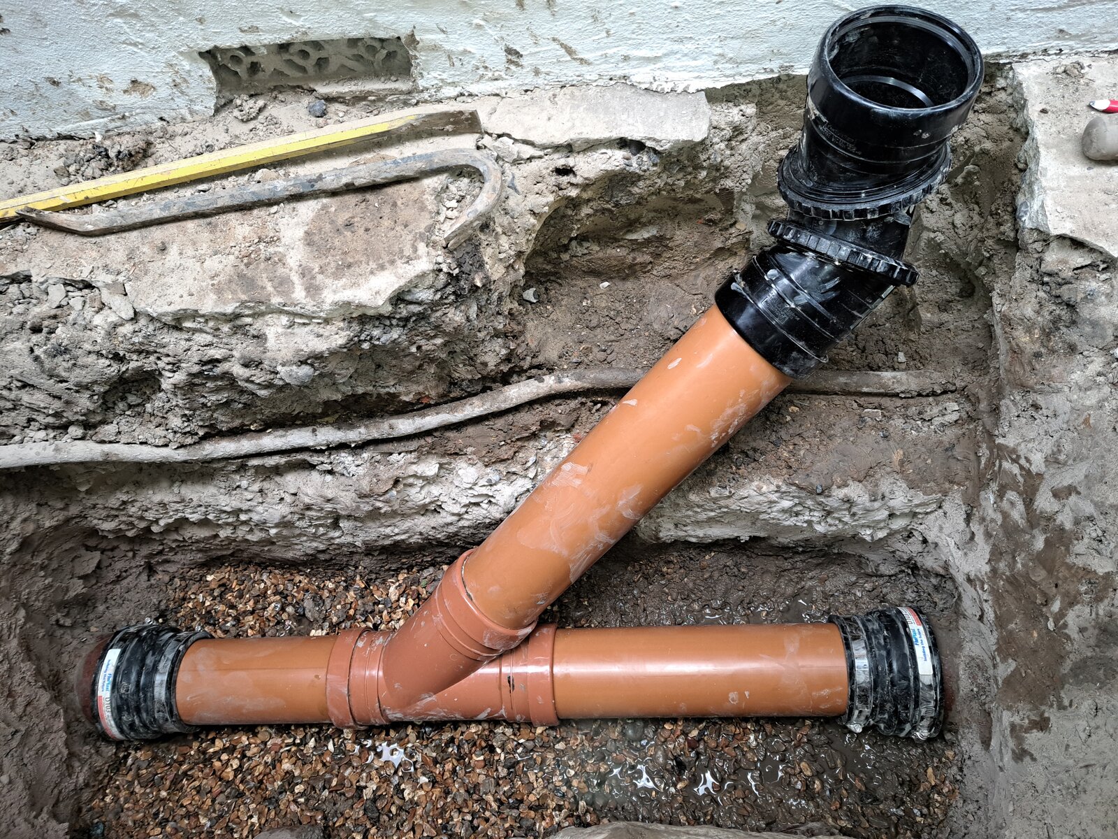

Thanks Hugh I've just had another go at it:
I will fit an access point just above the adjustable bend.
I tried to get out the concrete to get right down for a rest bend but it was really hard and grotty and kept nearly pinging the water pipe. Might leave trench open and have another go if I can get rid of the lead pipe.

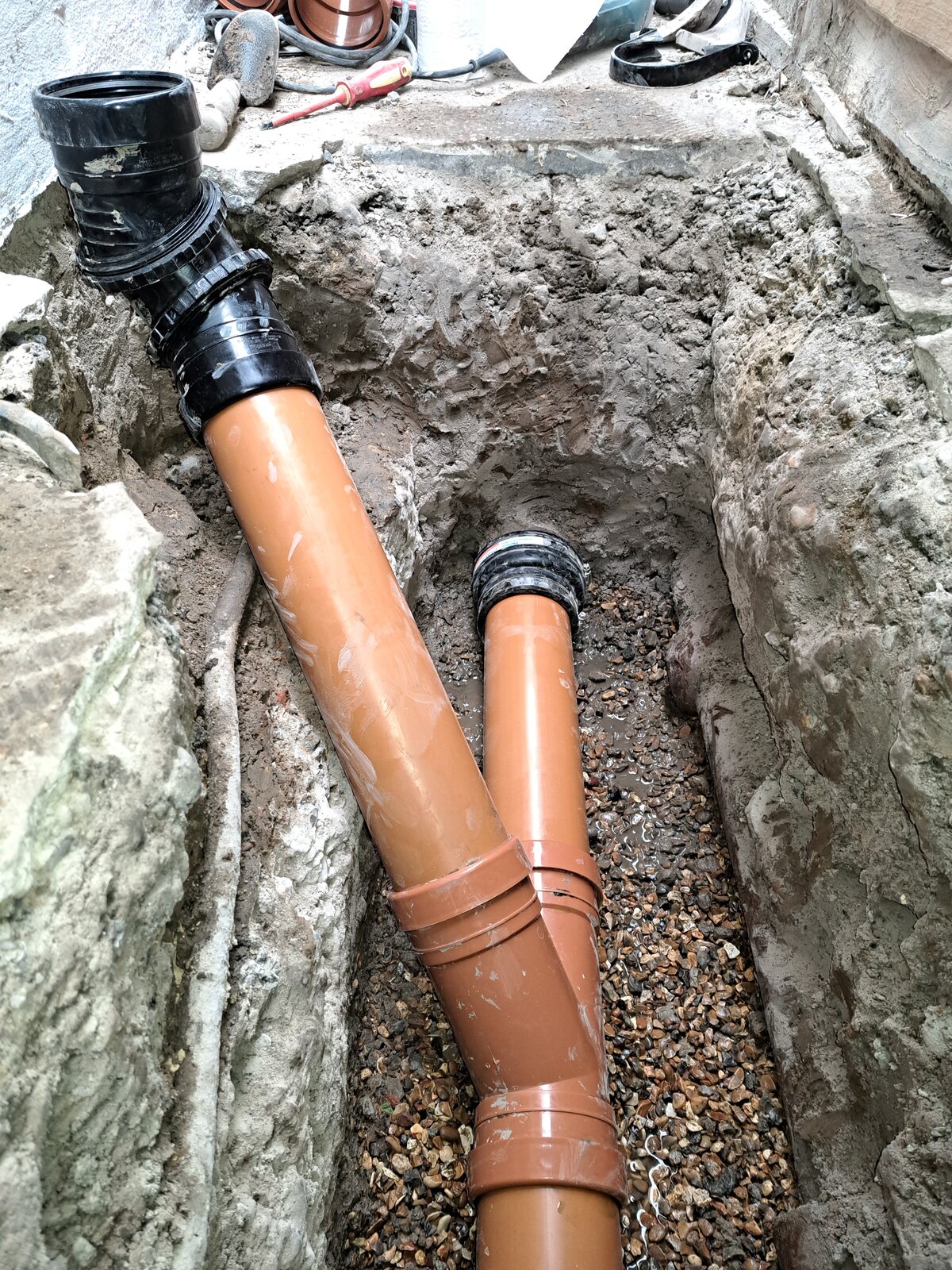

Thanks for all the help, I'll post a few more pics even it's finished in case any other DIYers taking on something similar. But hoping now out of ground it will be easy!

I think given the proximity of the pipe to the footing, you'd struggle to get a Rest bend in anyway, without chopping out a tonne of concrete and coming into the main on an angle as you suggested previously. My only concern with that setup would be, sufficient flow coming from behind the junction to wash any solids that collect, downstream and away.
I put plenty of clips on. Does the pipe or bottom joint need any more support? should I cement them in?
When I fill in the trench again, how much pea shingle should I put over the top of the new pipes?

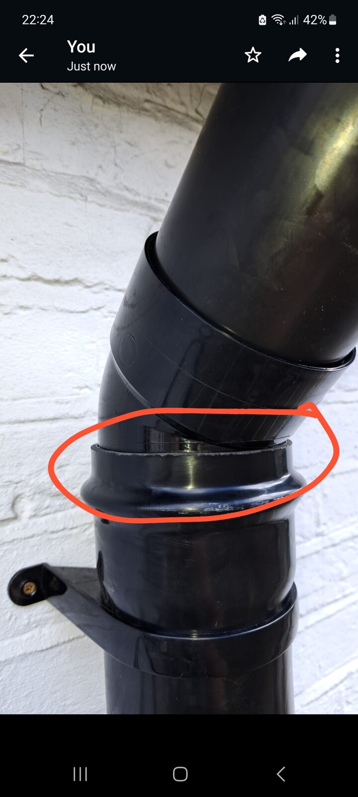

Only other thing that didn't seem quite right was the final piece with the vent, just push fit doesn't feel very secure.
