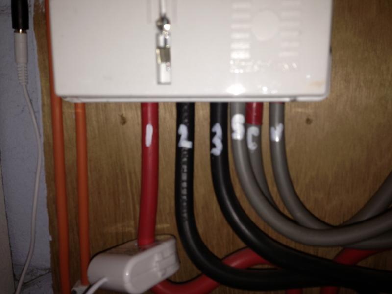

How about moving your current clamp at the meter to the OFF PEAK tail (either of the two which goes to the off peak fuseboard, can't see in the pic).
This would log all usage which is switched by the combined meter/teleswitch.

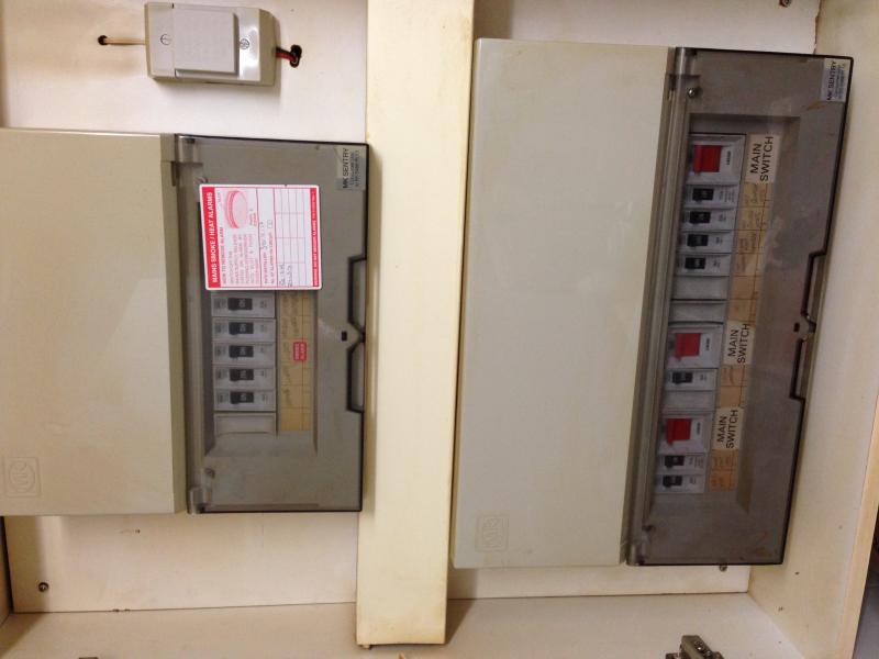

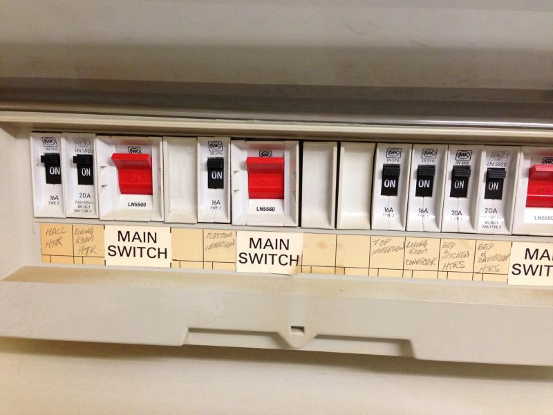

Can you test for voltage at all in your peak CU? I don't suppose there is an RCD in the peak CU that you could press the test button on? RCD's will only trip with power connected.
Can you take some pics of the fuseboxes? Are there three? difficult to work out what the smaller meter is for. Which tail have you put the clamp on?

It is on the one marked 1, first red one on the left of the meter.
Thats the supply into that meter - It's switched output is one of the two greys on the far right at the back.
One is usually on all the time, and the other is only on when meter switches it. Not sure which is which TBH though.
Is the smaller meter measuring your normal lecky usage (lights etc?).
The larger meter perhaps recording the peak heating usage (convectors/water), and the off peak switched for the storage?
Do you have three meter readings on your bills?
