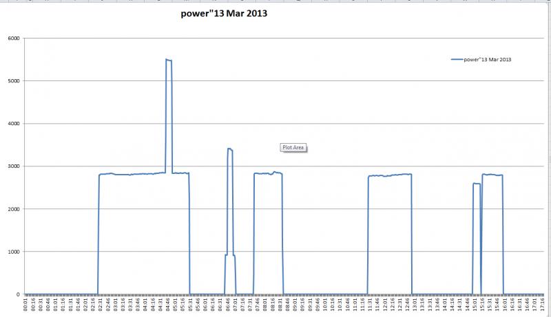

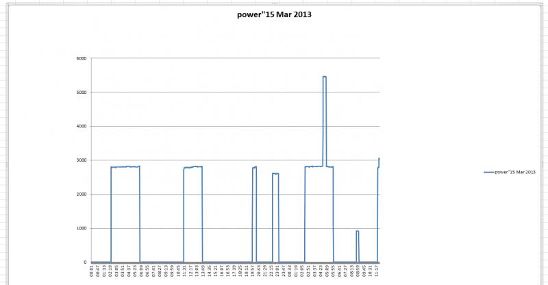

Looks like the larger meter is recording THREE seperate loads - The convectors, storage rads and the water heater.
Three main switches in the big consumer unit, and three 'out' tails from the larger meter seem to indicate this.
The meter should be switching the outputs to the storage rads, what times this occurs depends on the tariff, the water heater may also be switched.
The little meter appears to be for your general lecky usage in your top consumer unit.
Phone your supplier and ask what tariff you are on, it looks like a heat wise meter , I think it's 10hrs off peak a day
