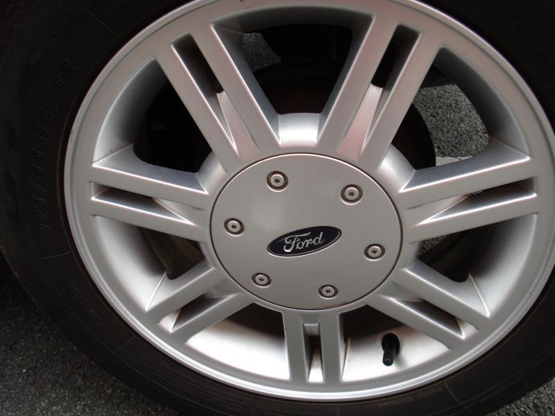

Thanks everyone. I've decided to go with the Continental Eco Contact 3 seen as they are very highly reviewed, I'm not prepared to skimp on tyres and they are the only contact between me and the road! I took a centre cap off one of the wheels (one of the things holding it on snapped off so if anyone knows where I can get replacements from that would be great - part no. 97BG-1000-EC - see photo) and now I understand that it is the locking wheelnut key. I'm arranging for all 4 tyres to be replaced at a local place for £180. Will ask them not to tighten everything too tight too. Cheers everyone

Located some replacement caps for a fiver each, will order some if any are too damaged. Just out of the interest, the other fiesta will need at least 2 new tyres soon, anyone know any best buys for 165/70R13? Preferably no more than £40 each! Thanks

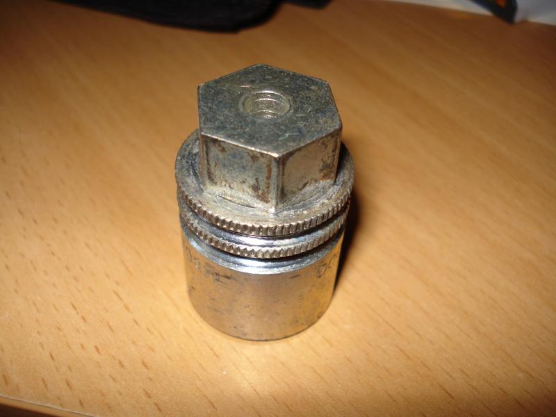

Note how the hexagonal nut base is located tight against the socket cup end face.
If the tool does not seem to locate into the wheel nut - look for a gap, hex to cup face, the hexagon part is an interference fit in the cup.
My particular one had moved 'back' and therefore would not locate in wheel nut - Not easy to notice this - My first use since vehicle serviced... What happened? - I can only guess.
A sharp hammer blow on (protected) hex end, with open cup end resting on bench restored the situation.
