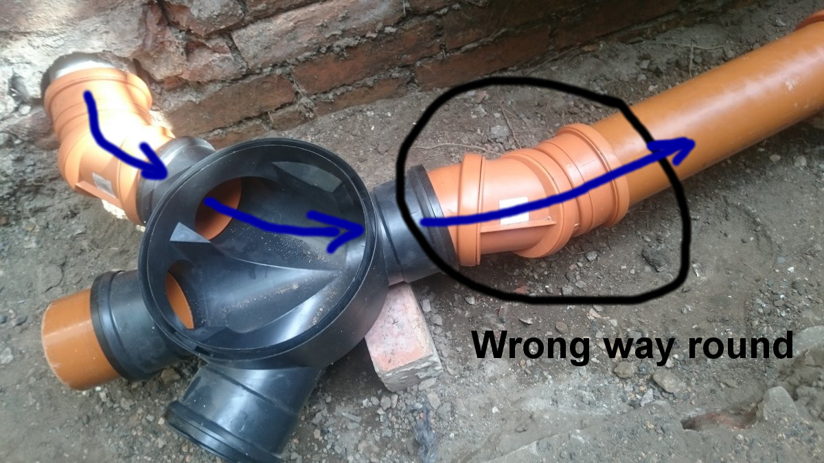

The incoming swivel joint is okay, but the outgoing one is in the wrong direction, (even though there's a degree of reasoning to the way you've done it) as you always push the champhered end into the next seal, in the direction of the flow. You should have pushed the long piece into the outgoing spigot, and then made the angle adjustment at the other end.
But if the swivel part is leaking, then just take them back and say they are faulty. It might be a faf to go and get the better ones, but if the joints see, over a period of time, you'll get the ground sinking round the joint, and that'll mean redoing the job, with very soggy and stinky ground to dig up.
If you can get fixed angle joints to make the connections, then you'll end up with a much more secure job.

To be honest, I really don't think the images I've posted show the full picture, it's giving the illusion that the spigot of the adjustable bend going into the IC is crooked, but looks way exagerated on that picture so perhaps I could post some better ones up.
I'm sorry Doggit, I'm still trying to comprehend what you are telling me. I'm literally staring at the picture at the same time as reading your advice and I just can't see what you are seeing which is frustrating for me. As I've just said, if you mean it looks like it's going into the IC crooked, then I'll demonstrate on another picture. Other than that, I simply cannot see why these fittings would be inappropriate for this particular 'setup'. I've connected spigots to sockets, used the ac4000. I even showed my plans to the guy at the builder's merchant and he had no objections to the plans. But, I'm really not at all concerned about that section of run because early next year itll be coming out and the rest of that clay pipe will be out, therefore not requiring the adjustable bends but because that clay pipe is running at an awkward angle Ive had no choice to use adjustable bends. That's what they are for surely for awkward runs such as this.
Anyway, whether anyone cares or not, I'll be updating this thread with pictures of the final installation with everything in place. Hopefully there will be no more seeps!!
He's saying that ideally the flow should follow into the female ends on those joints.
Many thanks for that aptsys makes more sense now, but ok lets say I turn the fitting round, how would the male spigot end of that fitting connect to that pipe? That would mean connecting male end of spigot to male end of pipe which simply won't work right? And lets say instead I use a bit of offcut pipe to go into that socket from IC, it's essentially the same as if it were to keep it as is with the spigot end of that fitting inserted!
Really appreciate that picture, thanks again!
A rubber seal doesn't know which way water passes it. It should be watertight in either direction and also watertight under pressure when/if the drain ever blocked.
Exactly Ian. So whatever male end is used whether pipe or fitting shouldn't make any difference as they are exactly the same and whatever is used, that female socket exiting the IC MUST receive a male end to make the connection. Unless it's not as simple as that.
Yes, if you joint 2 pieces of pipe together with a socket you have 2 joints, 1facing each way.
I cannot imagine those adjustable bends have a direction of flow, if they did there would be an arrow on them.
My job yesterday was tiny but needed 6 joints:
Ok so I see you have all your male spigot joints going in the direction of flow. However, you still have your bit of pipe off cut male going in the opposite direction going into the outlet socket of your bottle gully. So why should a male end of an adjustable bend be an exception? This is all I'm getting at and it's simply just baffling me lol
I can really only think that offcut pipe is generally preferred to allow for expansion and movement hence why it's used to bridge the joint?
