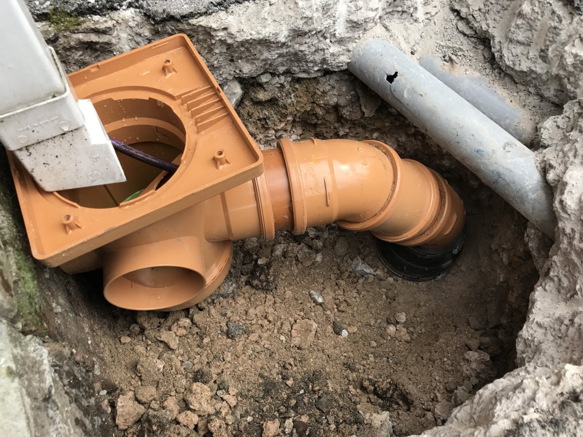

Yes, if you joint 2 pieces of pipe together with a socket you have 2 joints, 1facing each way.
I cannot imagine those adjustable bends have a direction of flow, if they did there would be an arrow on them.

Considering my new drainage run is connecting onto existing clay via an adapter, leaving the drainage at the front intact, I would regard the current work I'm doing as a repair.
Sorry Tozzy, but it's notifiable to make sure you've done is right, that's all. A repair would be replacing a piece or two, but you've gone just a little bit past the repair stage.

I'll make sure it's all correct then. So what I've decided to do is take the advice what Hugh already provided and redo the part from the IC and adaptor with the fixed parts he suggested which I bought today. But thing is I couldn't manage to get the 45 degree so I'm wondering whether to keep the adjustable there as is or not.

Certainly will. I've decided to replace the 45 degree also so I'm following his advice to the letter now.

If you need to buy more gullies, go for the bottle gullies. Easier to clean out in event of a problem, and only one joint on the outlet needed. ;)
What's wrong with it?
For rainwater it should be a Marley UG44 & UG47. What you've fitted will result in you cutting the plastic grate & the RW shoe is too low. These gullies are not designed for rainwater. You're clearly not a Plumber but a Grubber.
Always fit Marley & follow their design/installation instructions.
At least the OP has used the correct RW gully, that can be easily cleaned out by removing the plastic grate.
Bottle gullies are not designed for RW. You Grubbers shouldn't be laying drains.
