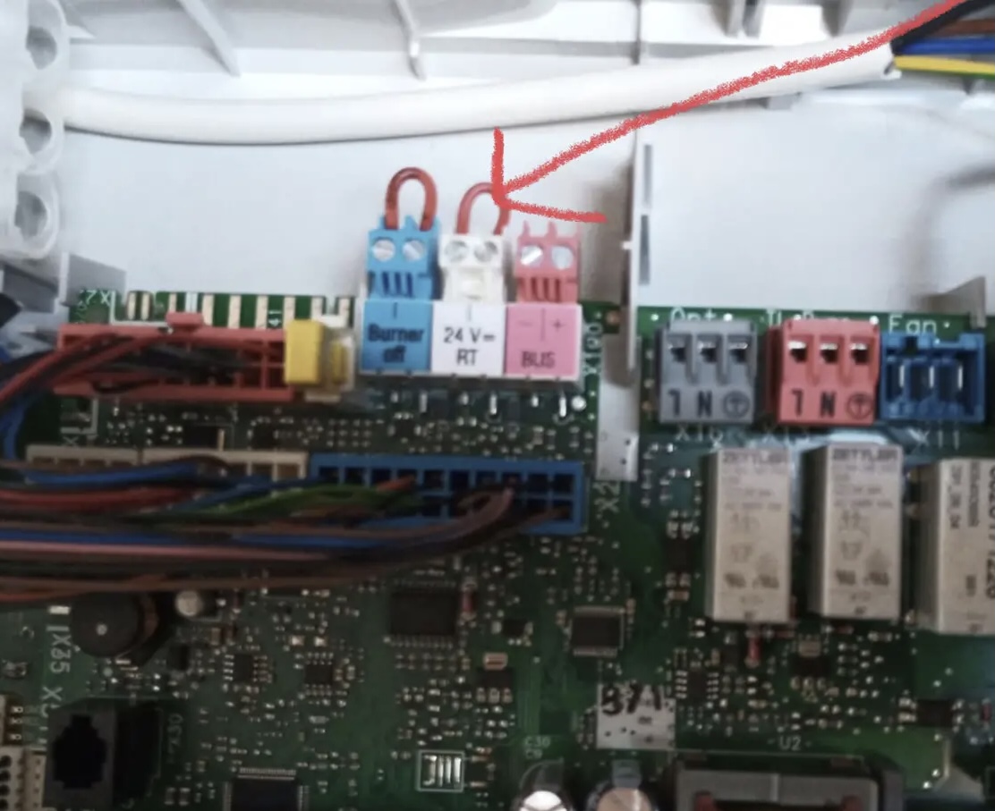

Don’t know if it’s anything like the problem I had with my Vaillant eco tec pro when first installed but if you are using anything other than the Vaillant controls (that work on 24v), you have to remove the 24v link from the circuit board. Apparently it’s one of the most common faults on a new Vaillant installation…..
