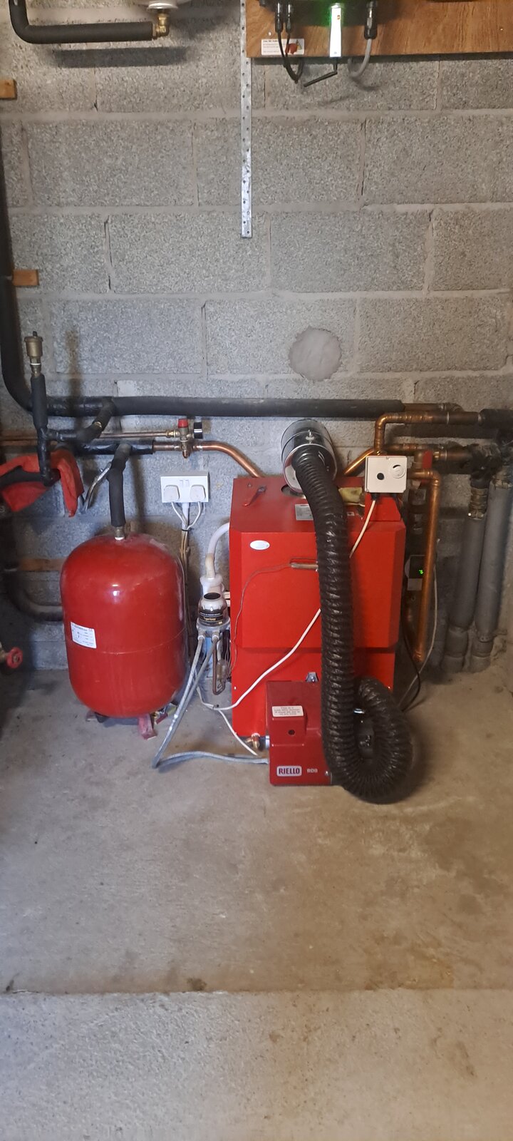

In view of the fact that there is 26/46kw stamped on your boiler you might ask Grant what is the actual lowest boiler output achievable, otherwise you just have to live with the 36kw when you change the nozzle.
As I said before you can get the 26/46 to run on a .75 nozzle you would also require a air restriction plate in burner Grant will supply this f o c.

I'm hoping that your boiler was installed by an OFTEC registered engineer and has been properly commissioned. If so give OFTEC a ring. They should be able to get an inspector out to check the installation. They can force the engineer to remove the boiler and fit the correctly sized boiler, or to get grants permission to fit a smaller output burner.
to reduce the burner output from the factory size of 41kw with the 1.1/60/es nozzle you need to fit an air adjuster disc (( part number Z20094349) although this was supplied with the boiler) and then you can fit a 0.75/60/es which will drop power down to 26kw. Any competent oil engineer though should be able to set it with the disc and use postion A and then should be able to use 0.6/60/es and drop the output down to 21kw.
otherwise you could purchase a brand new rdb2.2bx v15/26 which you can drop down to 15kw which will fit your boiler. they are about £375

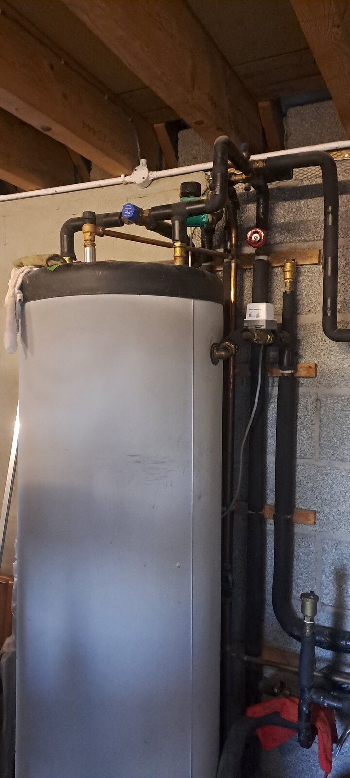

I've been looking all over the pipework but cannot see an abv! The blue valve at top of 200L hw cylinder just seems to be hot water circuit but no direct connection between flow and return! Still to do timings for hw.

Does your water meter reflect the apparently massive HW usage of (can't rememer now) something like 800 litres/day??.

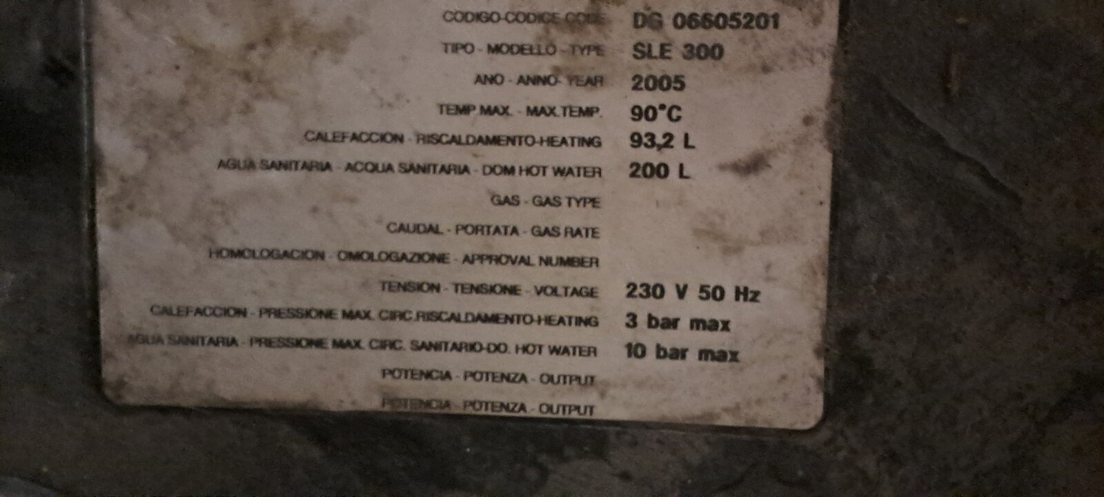

Can you post details of the HW cylinder or/and its capacity, it should be labelled.
Unvented hw cylinder with expansion vessel and is 200L capacity. Our hw usage isn't high - it's the circulating pump on hot water system that's needed as it's takes 3 minutes to get hot water if pump is off. No water meter installed.
