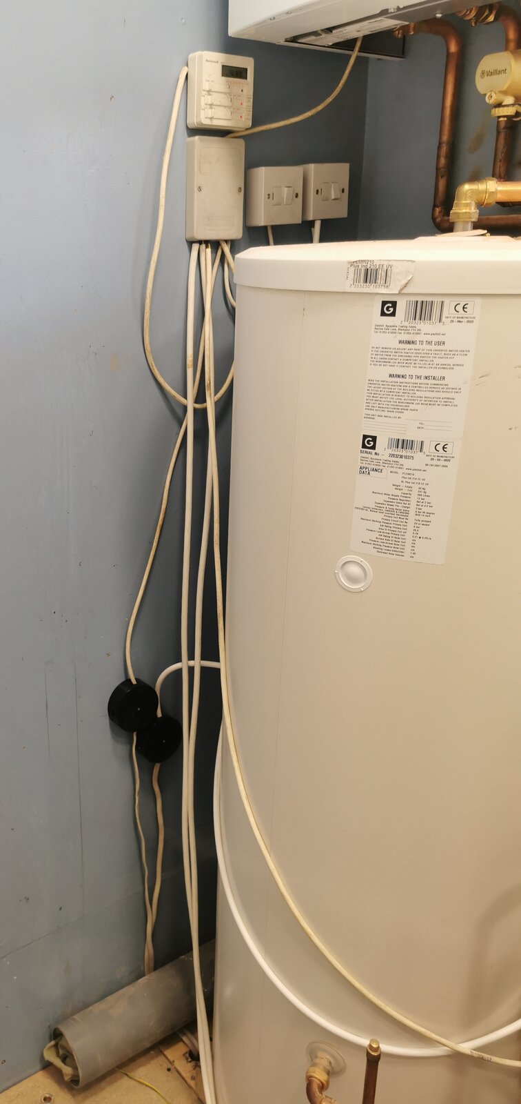

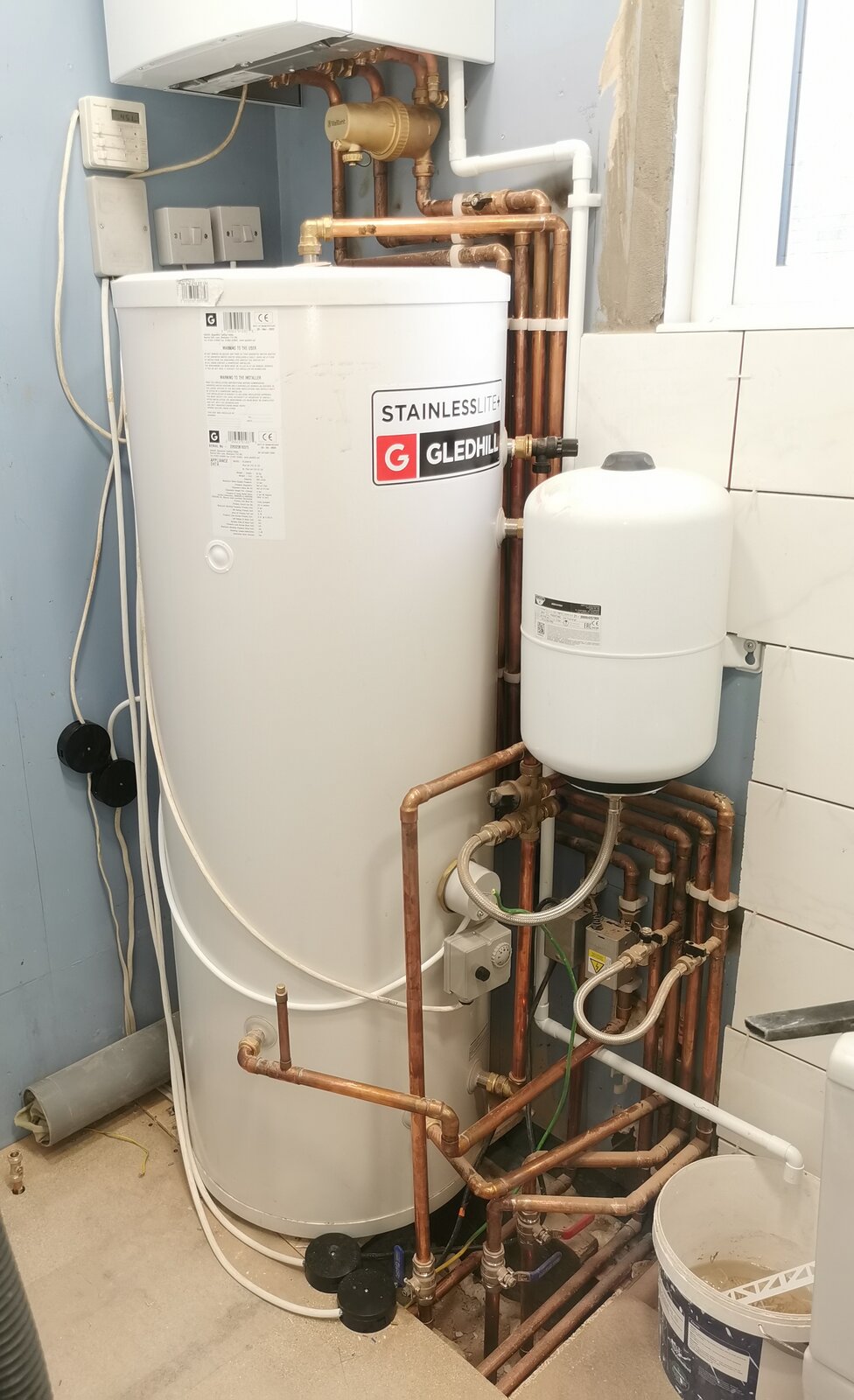

Check out my new system.
Really pleased with it.
Vaillant system boiler and Gledhill cylinder.
What do you pros think???

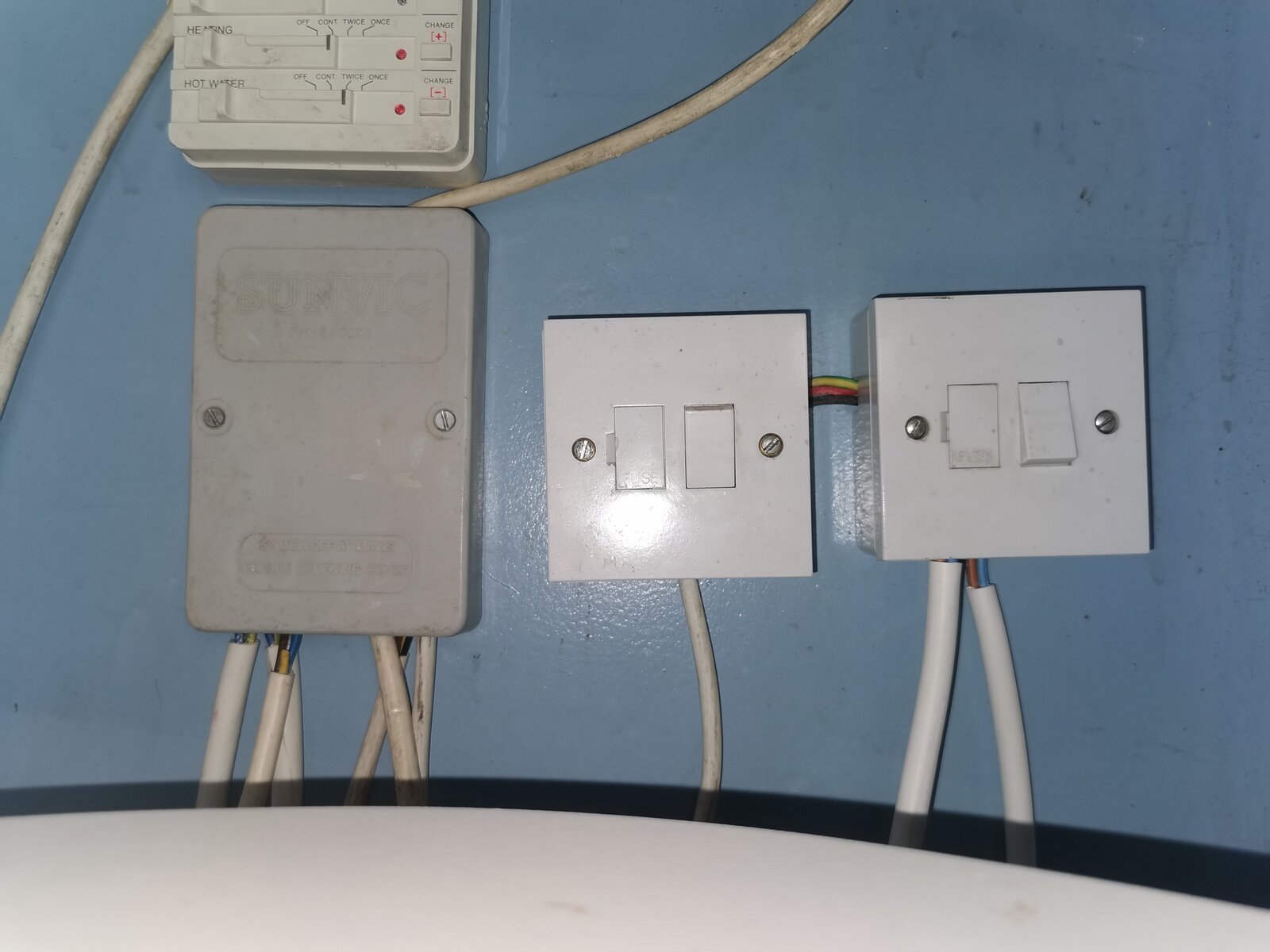

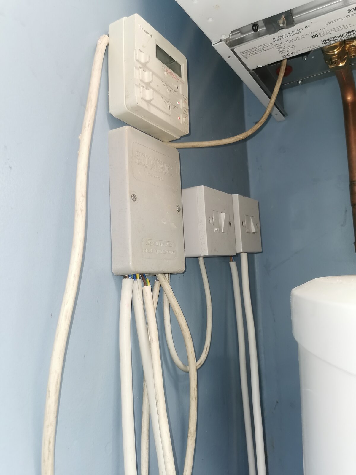

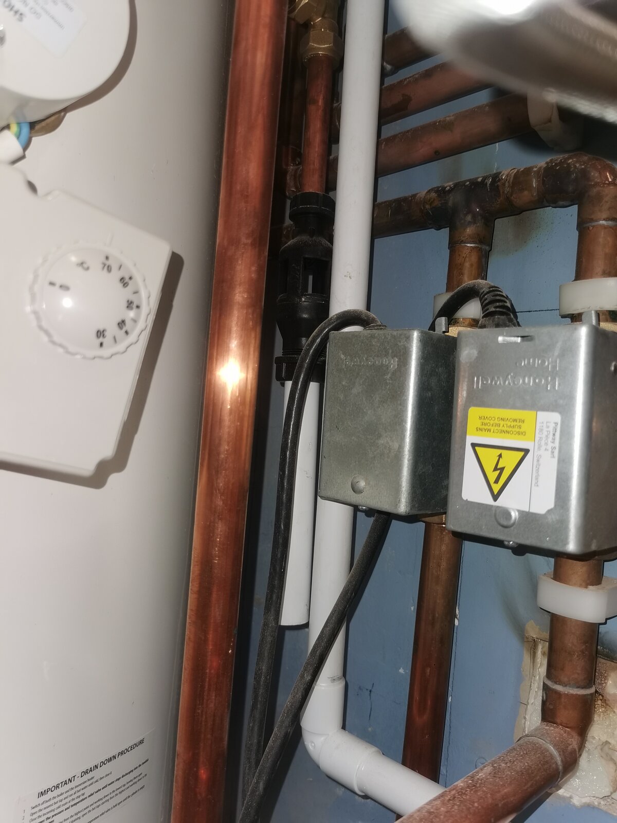

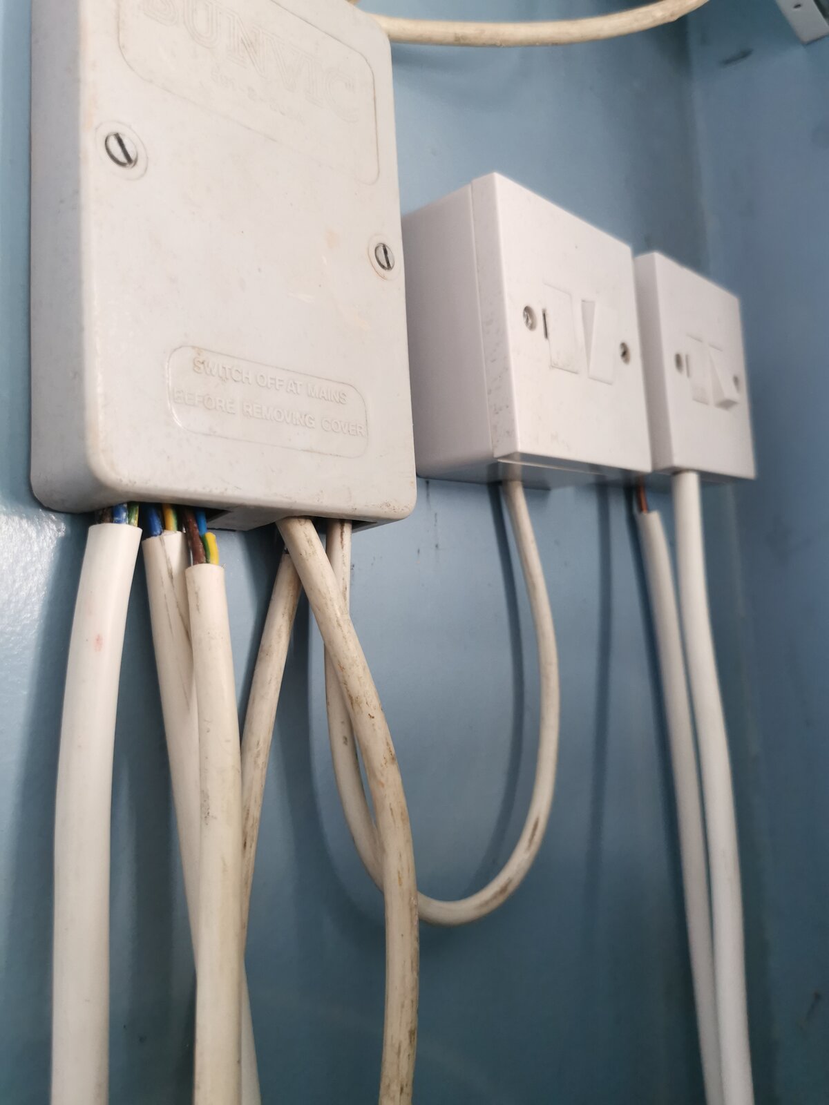

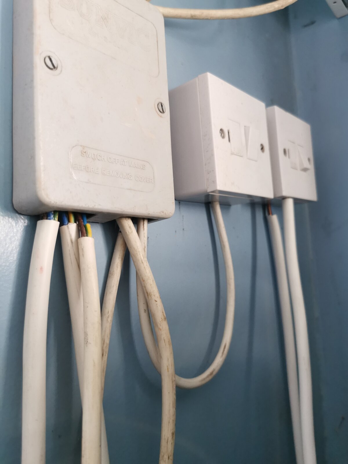

Wiring was done by a plumber not a sparky.
That is soooo pik ey.
If I had wired up a system like that as an apprentice, I would have been slapped round the head and told to do it properly!
What you talking about???
It's finished, just got his final bill.
Wiring is shocking (pun intended ;)), and wouldn’t be paying for it, or reduce money to neaten it up by a professional.

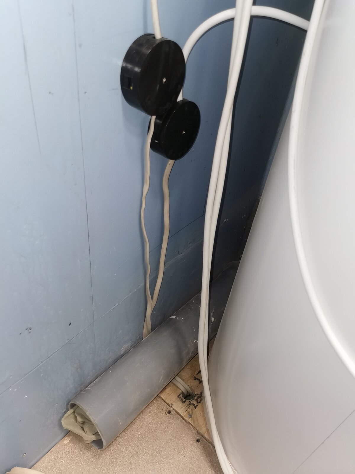

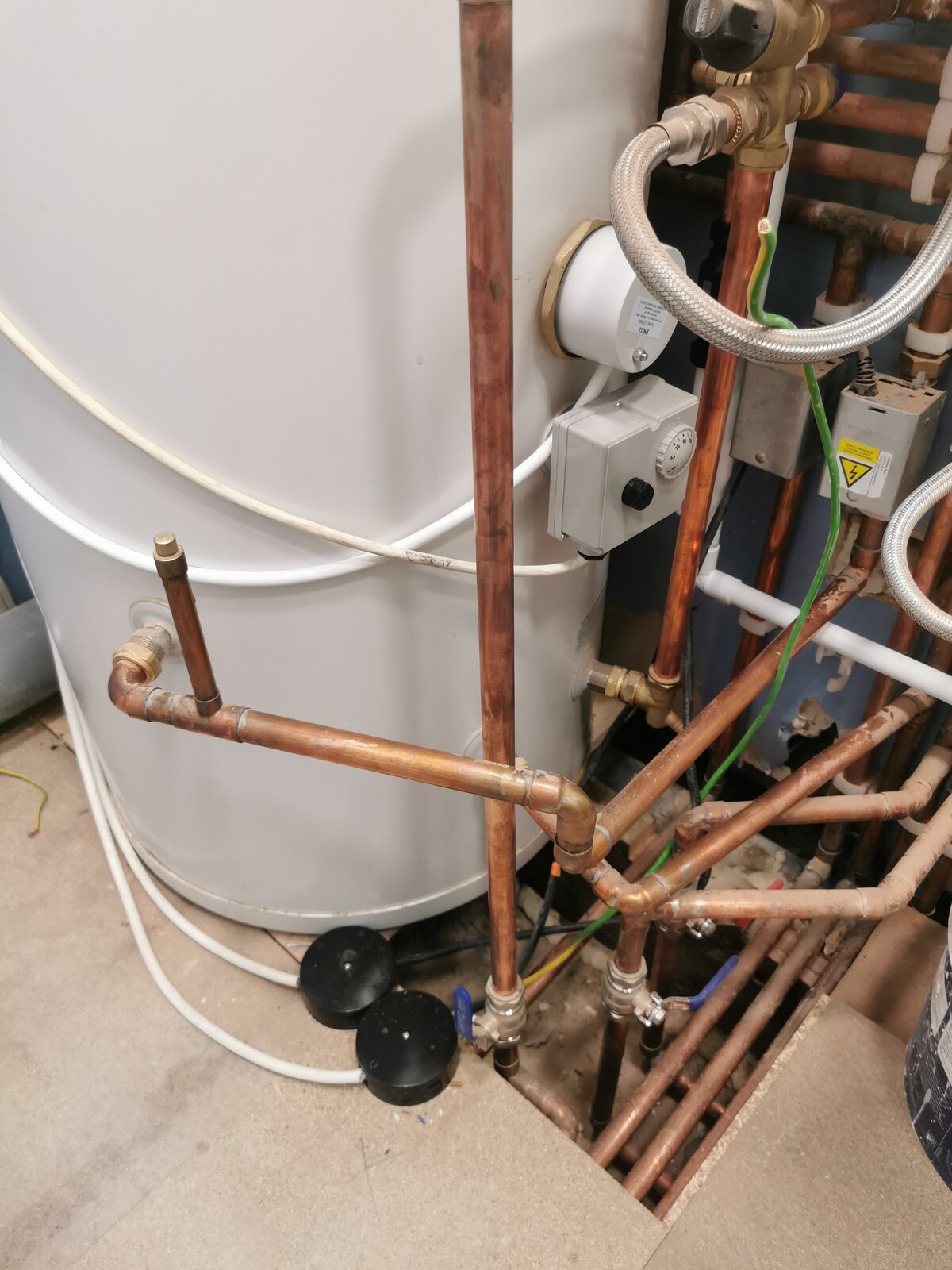

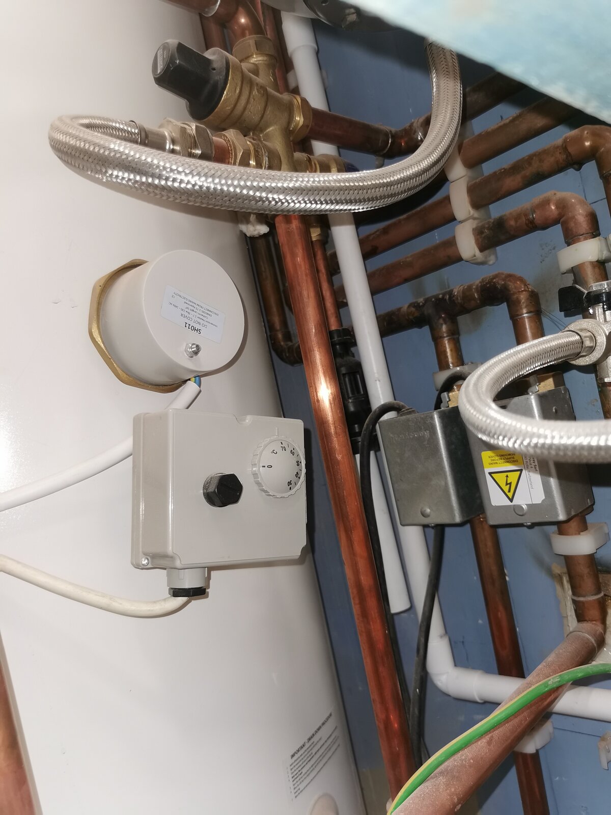

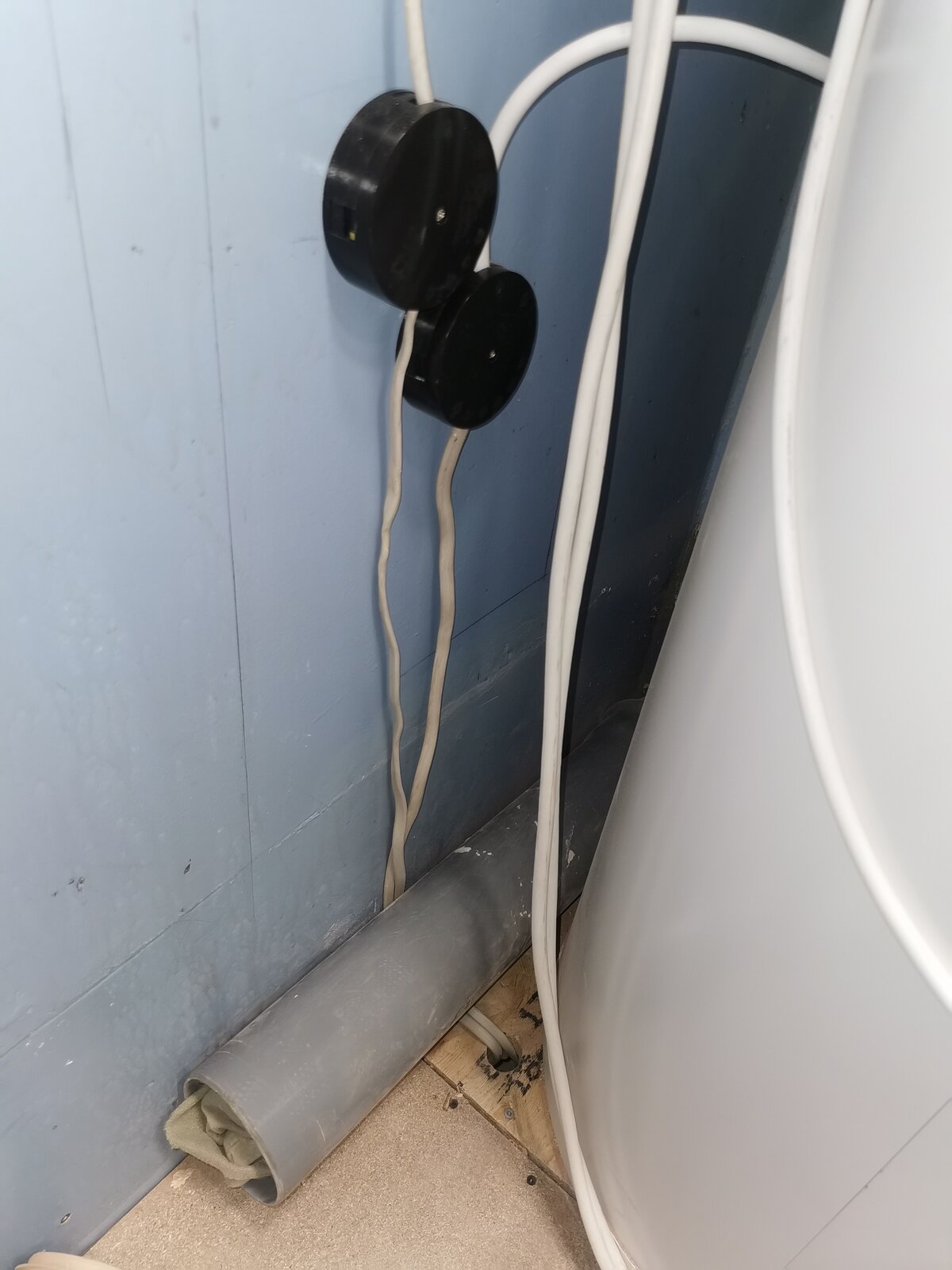

Combination valve I would put above cylinder, otherwise drain down to replace etc. wiring is crap. D2 pipe terminates where? Seen worse though.
I believe the d2 is tundish related, it terminates into thin air.
See picture, you can just see it.
