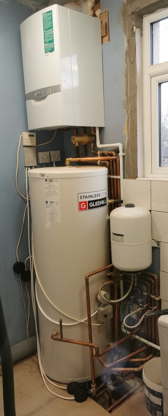

New Vaillant system boiler & cylinder installed
If it is fully completed, is safe and you are happy, then that is all that really matters to you. A lot on here don't like seeing shoddy work where the customer is paying top dollar, or shoddy work in general, and rightly so. I was never the tidiest of workers, but I did complete the work, and it was safe.
The work is complete and I was happy until some of comments here.
I have asked the plumber to make the wiring safe and have a look over all the pipes to make sure all is safe and reliable.
I really don't wanna be a tricky customer but that wiring is bad and the tundish d2 pipe left to potentially flood my house.
I cannot believe he's put me in this position

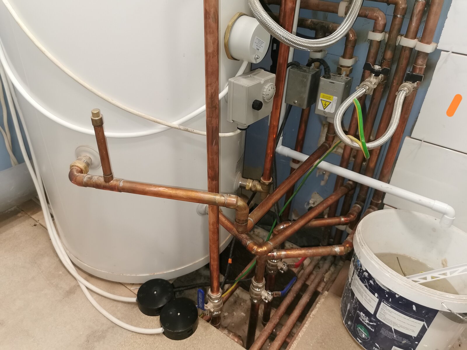

A very poor rough install.
cables exposed on electrics from junction boxes etc.
no insulation on pipework(1m min from cylinder)
combination valve on cylinder should be above tprv
cylinder data plate not completed
flexible hose on expansion vessel questionable as i think gledhill state it should be copper 22mm

Cold feed is well clipped !! . Guessing old cylinder cupboard and they have now spurred of the old dedicated immersion feed. If it was dedicated to the main fuse board that is. Be interesting how they terminate the d2. Foam around flue says it all really.

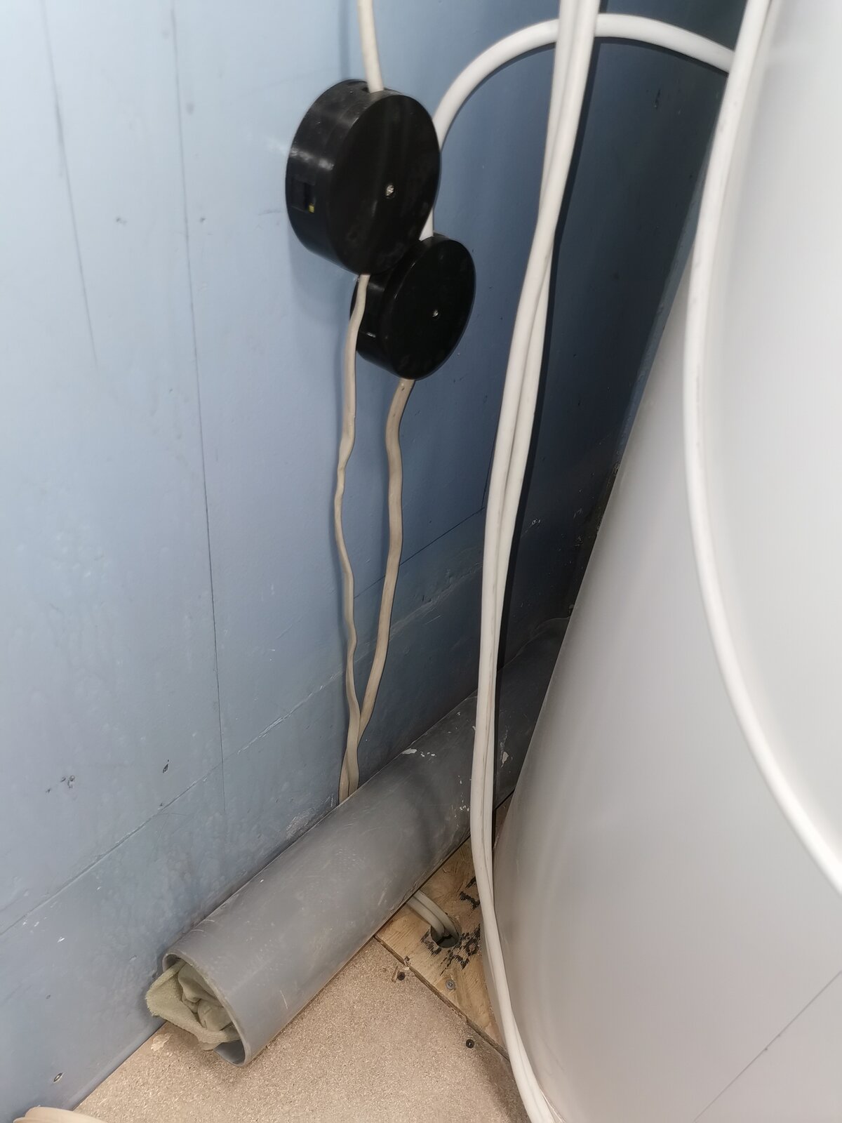

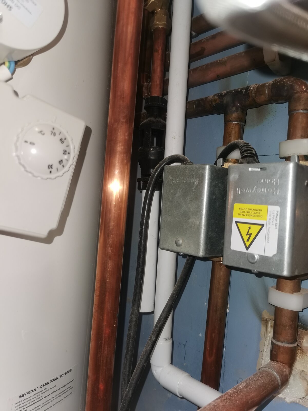

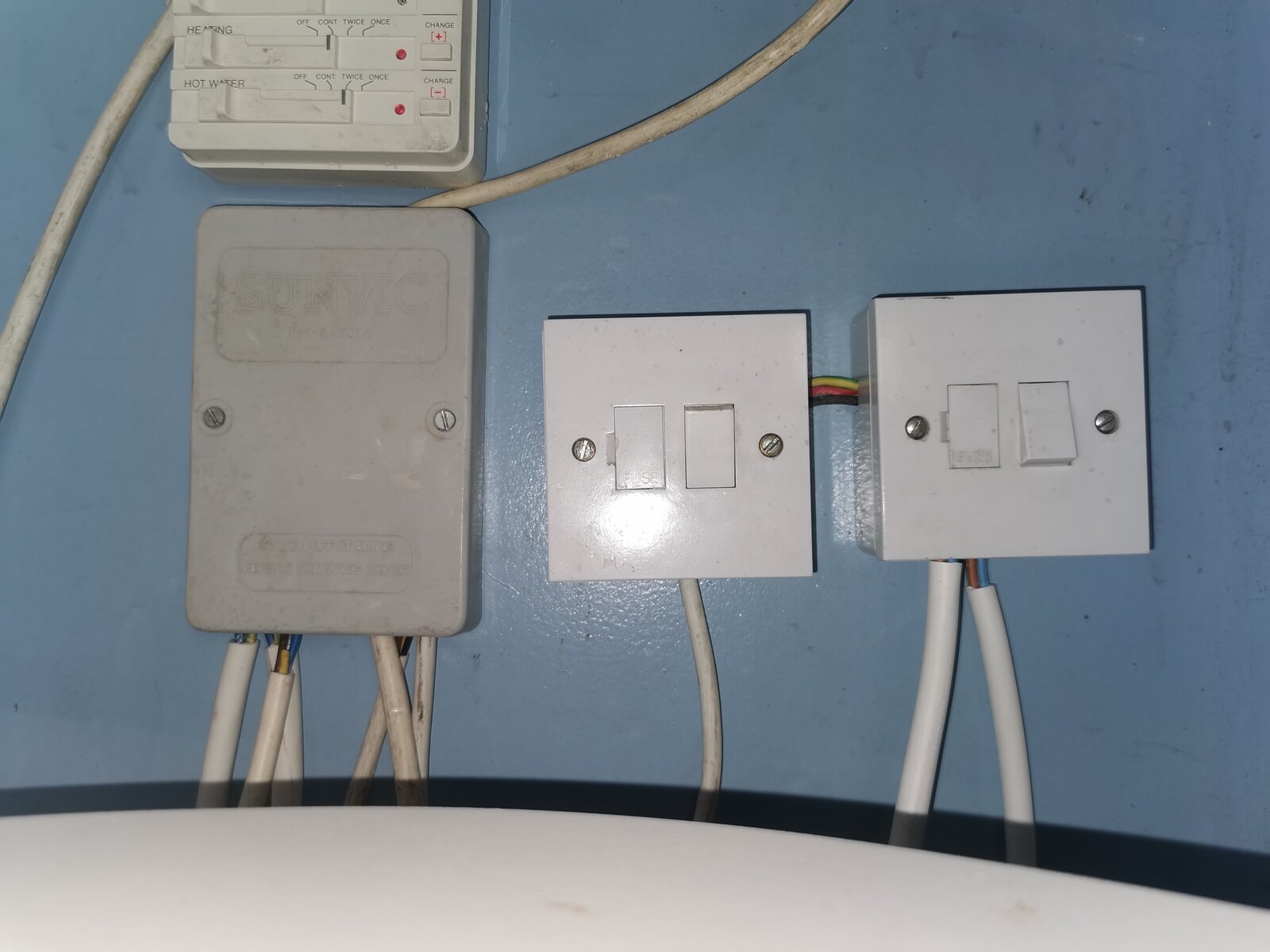

Wiring problems:
None of the cables are secured to anything
Most of them have inner coloured insulation exposed at the ends
There are single insulated coloured wires between the two FCUs
The brown round junction boxes should not be on the floor, or on the wall, or anywhere else - all are entirely unnecessary
Cable to the cylinder thermostat pulled too tight
The larger green/yellow earth wire isn't attached to anything
Cables at the back have a grey pipe resting on them, and they appear to go across the floor and into a hole, likely to be damaged if they aren't already.
Cables to the zone valves should not exit from the top, and if they absolutely had to, they need to be secured to something above, not left draped down the side.
Looks like they reused whatever parts were there and added a few other random pieces which were found in a nearby skip.
There is no reasonable way of fixing what's there - easier to just scrap the lot and do all of the wiring again.
Well looking at the pictures your right hand fused switch that does your immersion has LNE crossing to the spur for the heating. Yet you have a L&N that looks like it goes to the cylinder stat that controls a critical part of the safety group . Guess why your hot water ain’t working. Guess it’s doing it’s job though
