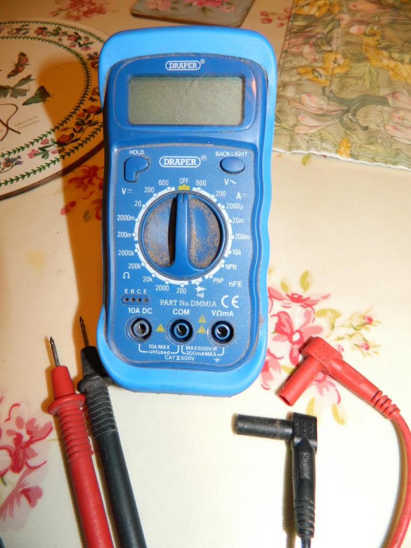

Well, at long last I've managed to borrow a multimeter from a work colleague. I'm now confused by Matt1e's guidance though, as the meter doesn't have a 500 setting:
Really need to get this problem sorted with winter fast approaching (and summer no great shakes anyway) and family clamouring for a bath instead of a shower :( [/url]
half past twelve?
The selection knob for 600v AC should be first position after off position going clockwise
