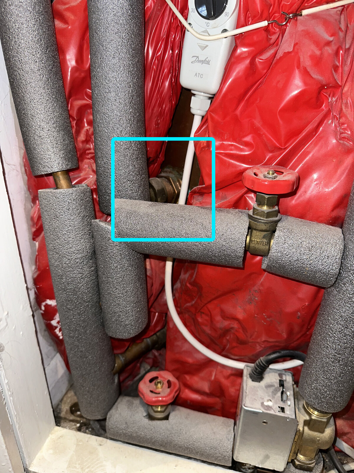

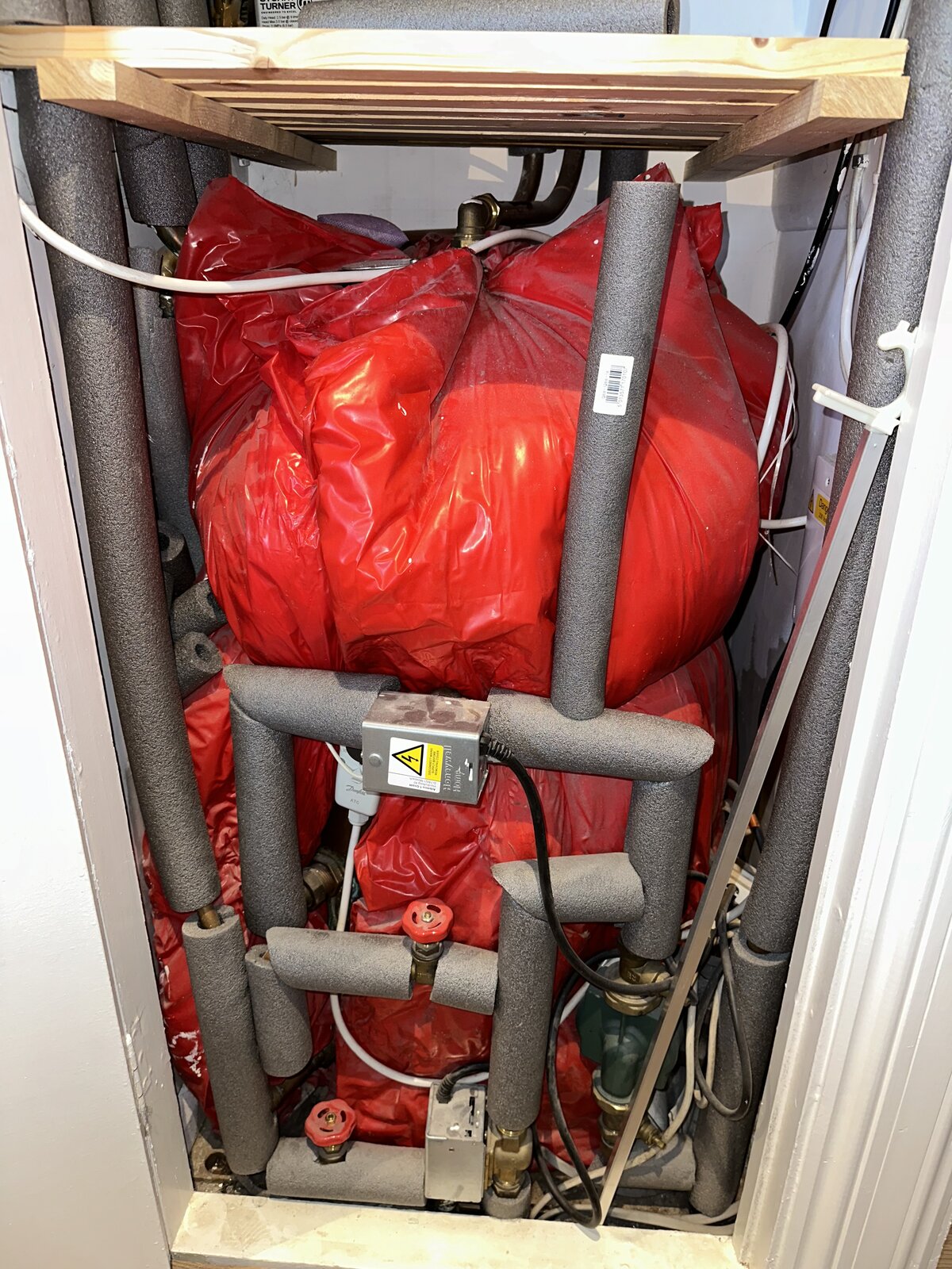

Hi @Madrab,
I hope you don't mind me piggybacking off this thread, as I think I'm experiencing the same issue.
I made a post a while ago about not having any hot water after changing a radiator. I followed the advice there, and before the plumber could come back to take a look at fixing it, the hot water sorted itself out.
However, shortly after, we had to remove a radiator again to allow for some plastering, and I think we had a faulty TRV valve as we ended up draining the entire system. So once again, we now have loot-warm water in our taps and shower that we have to boost using the immersion heater. The central heating & radiators are working perfectly and getting nice and hot.
Many people in the thread I created suggested that I might have a system full of airlocks, particularly in the cylinder coil.
I've tried repeating several suggested steps that I did last time, including:
- Opening the hot water zone valve and releasing air out of the manual air vent.
- Unscrewing the two silver caps at the pipes attached to the hot water pump and ensuring all air is removed / until water starts to spray out.
- Carefully opening and closing the HW zone valve a few times to ensure that it's not stuck.
This time, I'm left thinking I've got a blockage in the cylinder coil, much like @mcprinter had, and so I just wanted to check that the nut I've highlighted is blue in the picture is that one I can carefully release until a few small drips appear?
That would be the one to crack yes, does that pipe that the nut is on, after the 2 port valve, get hot at all?
Right after the port valve seems to be warm, but as you get to the bend where the nut starts is basically cold.
OK, certainly sounds like a air locked coil.
I tried loosening the top nut highlighted in the picture, and water started dripping immediately. Would this suggest that there isn't a lock?
Not necessarily, there as there will be water in the pipework from the valve direction too, have the system running too as the pump may help move things along. You may also have to crack the bottom one open as it may be airlocked further down and not in the coil specifically.
Thanks Rob, I'll give that a try this evening.
Re-checking after boosting the hot water for 30 minutes, I noticed that the part of the pipe that was previously cold is now getting warm, but the tank itself is stone cold.
As you suggest, it could also be an airlock further down. I will try that before coming back for more suggestions.
Thanks for all your help so far.
