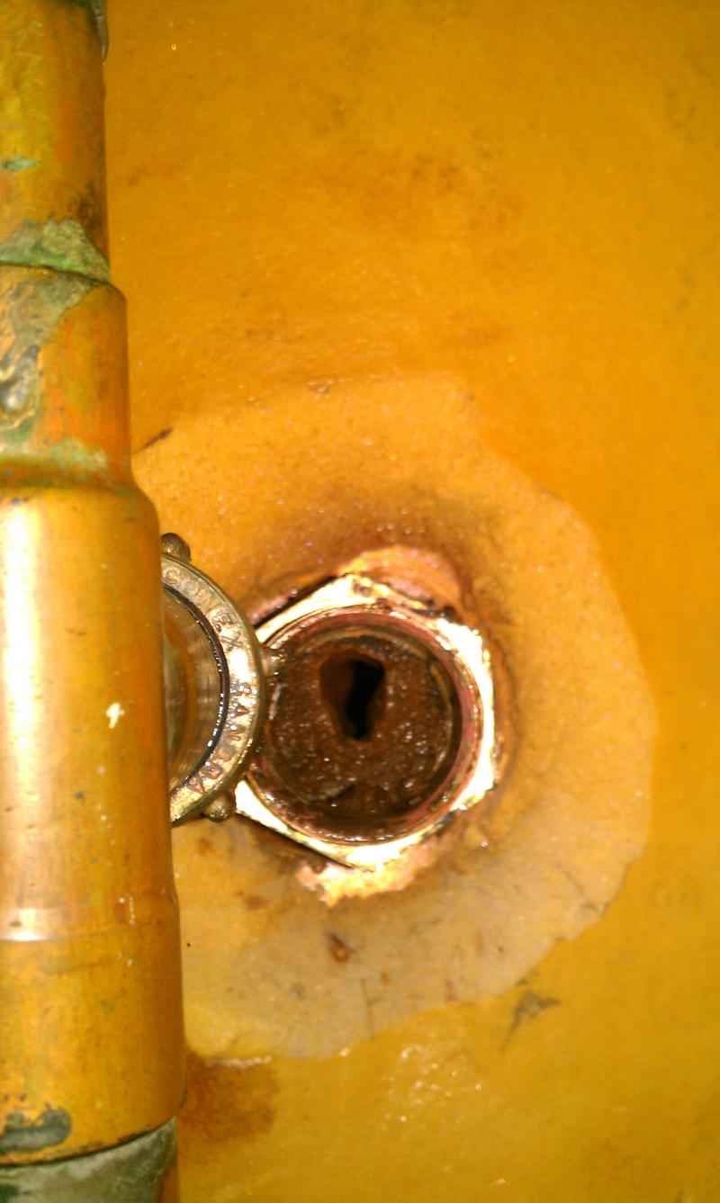

So I turned my attention to the gravity primary. I drained it down and ran mains pressure through the system from the header. That took care of the hot supply. Then I removed the pipe from the coil inlet (managed to take a photo, see attached), and blasted mains down there as well. Then I filled the system back up, pausing halfway through to add some Sentinel X400.

I'd stop wasting valuable time. CH System power flush with Sentinel X400. Save time and money. You've proven to have severe magnetite presence, so restriction on flow is there.
Whilst system is drained, fit yourself a magnaclean filter on.
