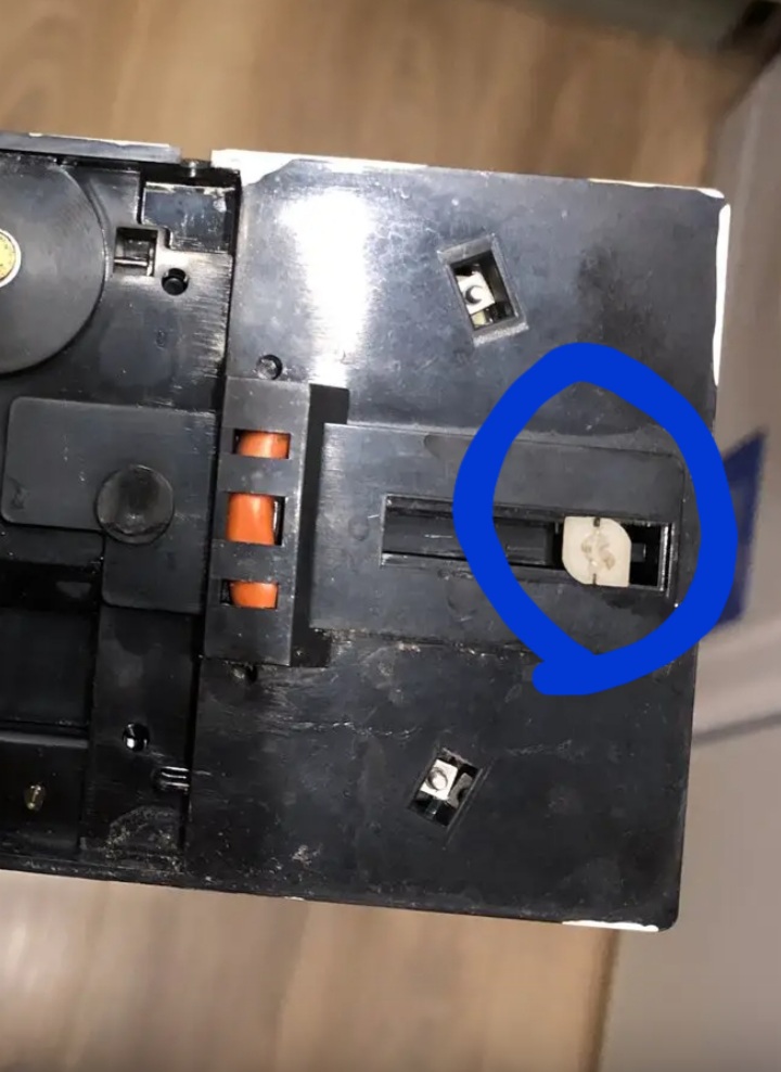

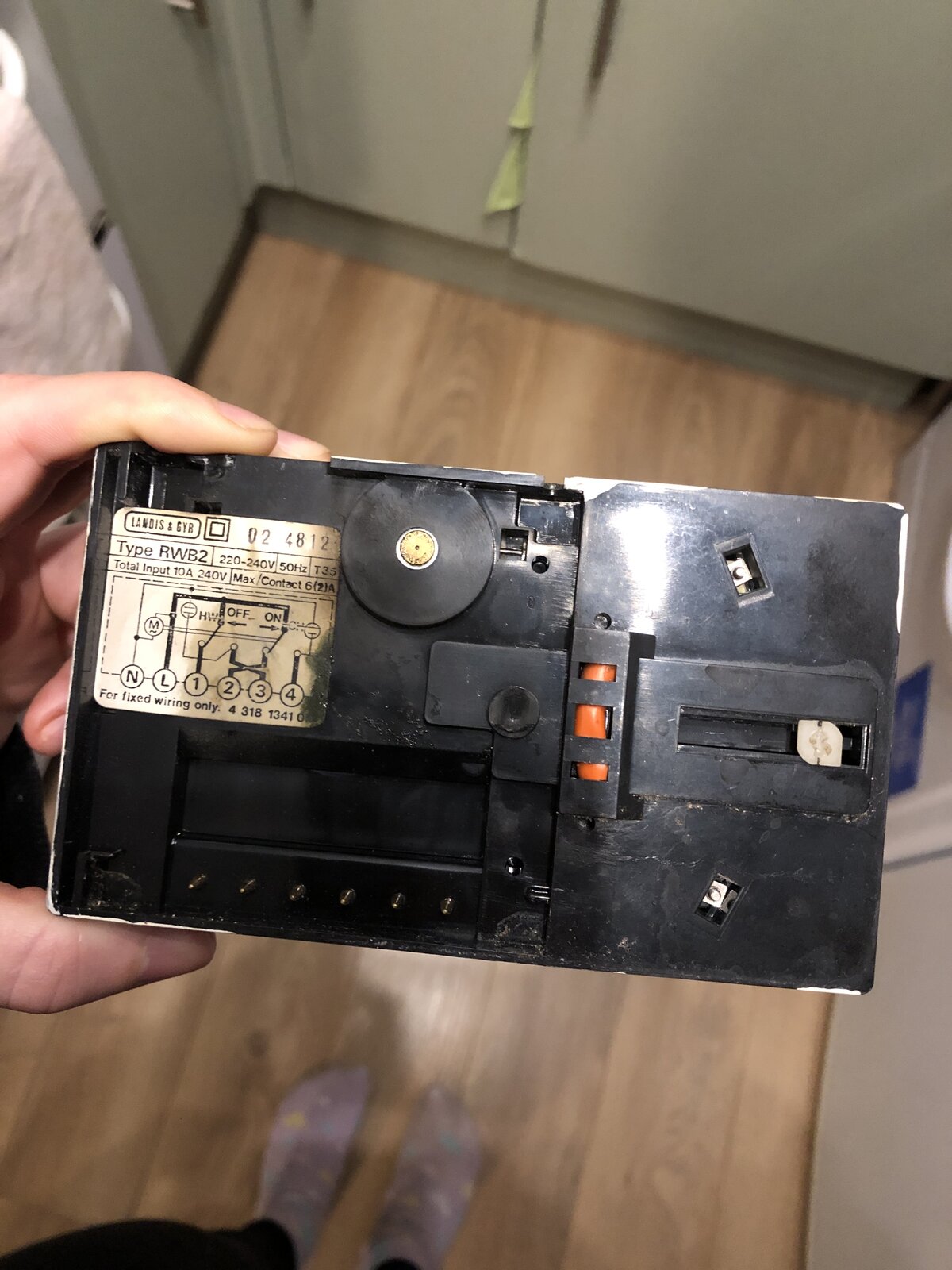

You say you have a mid position 3 port valve , so you have a fully pumped system, but your old programmer is set to Gravity, you need to remove the programmer and set it to pumped on the back then put it back on
I can’t seem to see a Gravity / Pumped switch on the back, could it be that this programmer is too old to have one?
Try turning this one 90 degrees anticlockwise...
Thank you I tried this this evening and it worked I can not turn on CH only and the boiler works and the heating comes on :)

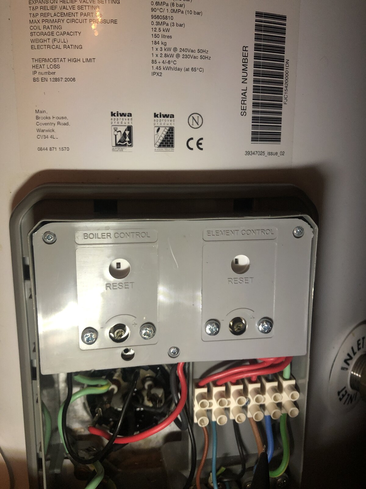

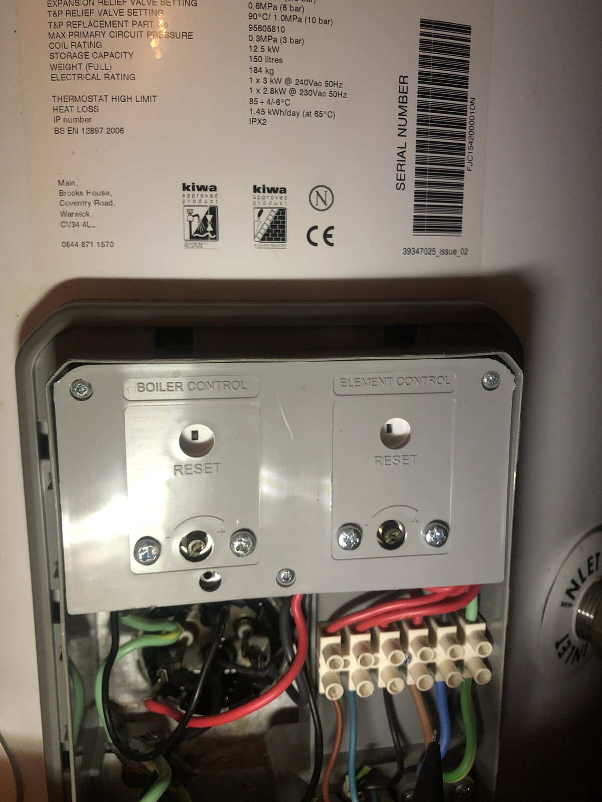

I’ve just noticed there’s a boiler control reset and an element control reset on the cylinder thermostat. Could either of these help?

You could try the boiler reset ,the other one is for immersion heater.
Have you had immersion on ,is the water in cylinder already heated ?
