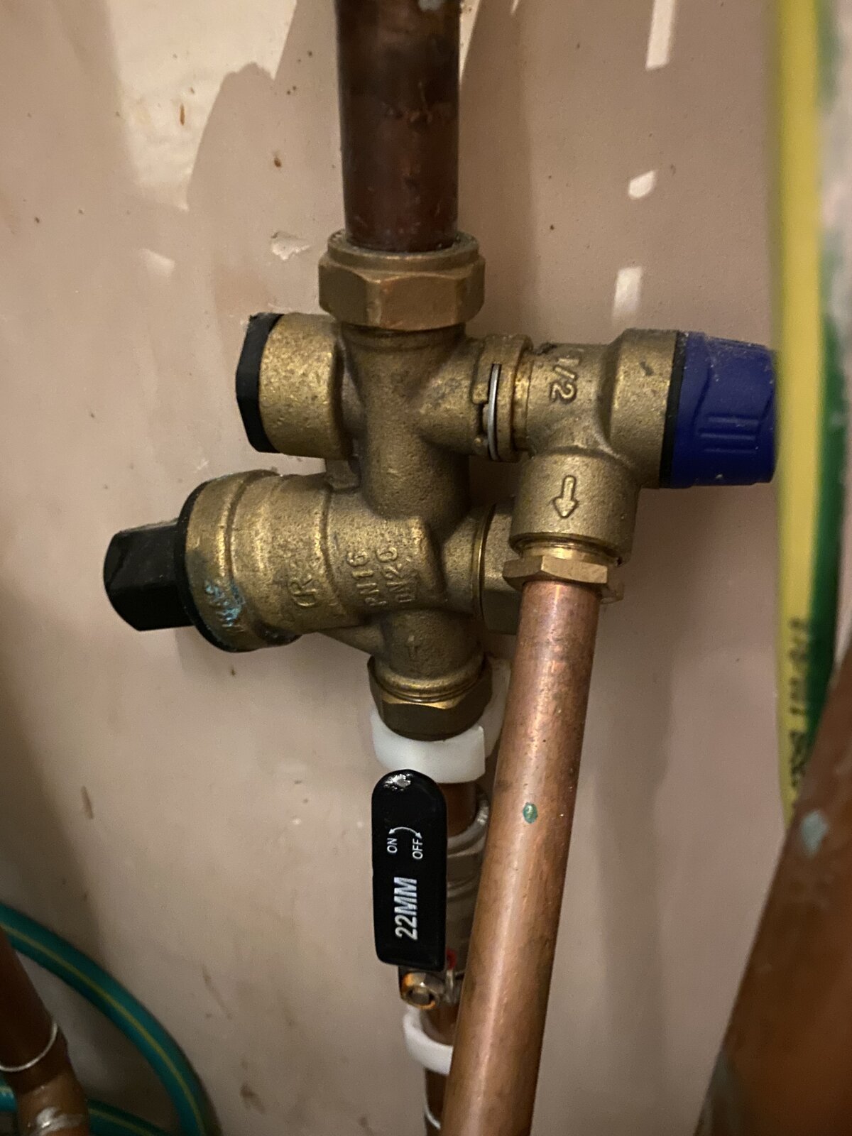

Post a pic of the inlet set...that's the lump above the blue isolating valve.
Thanks Gasguru, for getting back to me.
See the inlet set attached. What i have noticed in taking that photo is that i wasrunning the immersion heater to check and have noticed that a couple of the pipes have some water on them. Not a lot a few drops each but that only started happening when i turned the immersion heaters on... Don't know if that means anything.

That inlet set doesn't seem to match any Gledhill parts I can find on the web...it looks very old.
The blue expansion relief valve should be plumbed in BEFORE the tundish but since they've fitted the assembly too low they've bodged it in.

As above turn off the valve below the inlet set and see what happens after a few hours of heating.
1. The black plastic piece inserted into the pipework coming out of the Temperature and Pressure Relief Valve (TPRV) is called a tun dish. Its purpose is to show if any water is escaping from the TPRV thus indicating a fault.
2. The piece of pipe below the tun dish is called the "D2" pipe, and should be a minimum of 300 mm long after the tun dish before any bends or fittings.
3. There is a combination valve fitted which controls the incoming cold water. This:
3a. Also has a pressure relief valve (PRV). This valve should be connected to the D2 pipe or another separate pipe fulfilling the same function. The connection should be before the first tun dish, or a separate tun dish should be used.
3b. As it is, you will not have visible evidence if the combination valve's PRV operating.
3c. Because the combination valve has not been fitted above the level of the top of the cylinder, maintenance of the valve, which should be annual, will partial drain down of the cylinder.
4. The immersion heaters have two thermostats:
4a. The one with a dial which you use to set the temperature.
4b. An overheat thermostat, which turns the power off if the water overheats. This has to be reset by pressing in the red button which appears to be under the main thermostat setting disc. Your second immersion photograph shows this button.
5. Check that both overheat thermostat buttons have been reset.
6. I would also suggest you set the main thermostats to "5" rather than maximum, in case they are allowing the immersions to heat locally to a temperature at which they trigger the overheat thermostats.
7. Beyond that, as others have said, water is running away somewhere.
8. If all else fails, I'd be tempted to fit a full bore lever valve in the hot water outlet. Close it, turn the heaters on, and if the water then heats its an issue elsewhere in your water system. Possibly a mixer tap feeding cold back into the hot.
