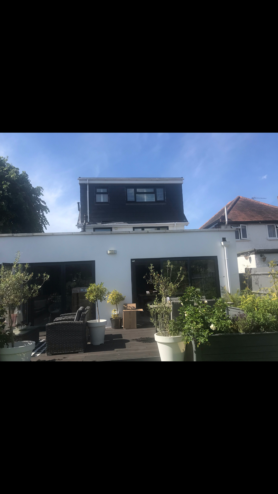

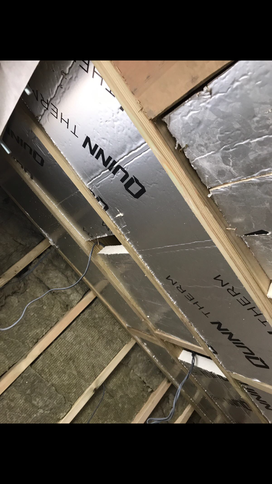

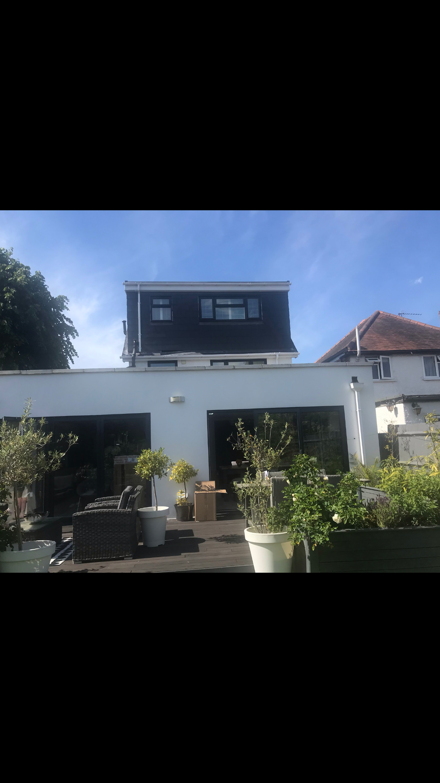

Hi, joining thread as wondered if anyone had an update had my flat roof installed nearly 3 years ago as part of a loft conversion. builder not really interested so have had three years of pretty much hell with the noise its relentless. and trying to find a reason as to why this is happening. i have read every thread but no one seems to have a solution yet?
I am not an expert and struggle to understand some of the terminology used.
my roof is grey and looks like a painted surface i have attached a picture.
Bangs / creaks day and night this noise is all over the roof not one place it can be a huge loud bang, lots of bangs or sometimes sounds like someone running along roof, sometimes there is a creak and then you know its going to start banging.
definitely contraction and expansion with less noise on cloudy mild days (thank god) not affected by the wind.
the builder has tried to remedy noise.
1. put 2 chimney air vents on top, this had no effect
2. changed the vented facia to non vented facia, this had no effect
a number of months ago he agreed to remove the roof and replace it i would need to pay for the parts and he would cover the labour, this has yet to materialise but my concern is if they/I don't understand the problem then the banging may just continue. i am having to get a loan out to cover this work and i'm just so worried it wont help

As you'll have seen, the main cause of banging/creaking is the deck not being secured to the joists and/or deck joints not properly made and/or joists not securely fixed (gravity is not sufficient).
Recommended deck for fibre glass is T & G 18mm OSB. If you use square edge boards you must support every join.
There needs to be at least 10mm clearance between deck and any walls.
If yours is insulated, fixing the deck through rigid insulation is unlikely to be successfull- insulate between and under the joists not above them.
There are loads of supplier videos and instruction sheets online, Cure-it is one major brand, there are others.
Thank you for your reply I’m going to look at the video and show your comments to the builder so when they take the roof off to replace each of these points can be checked

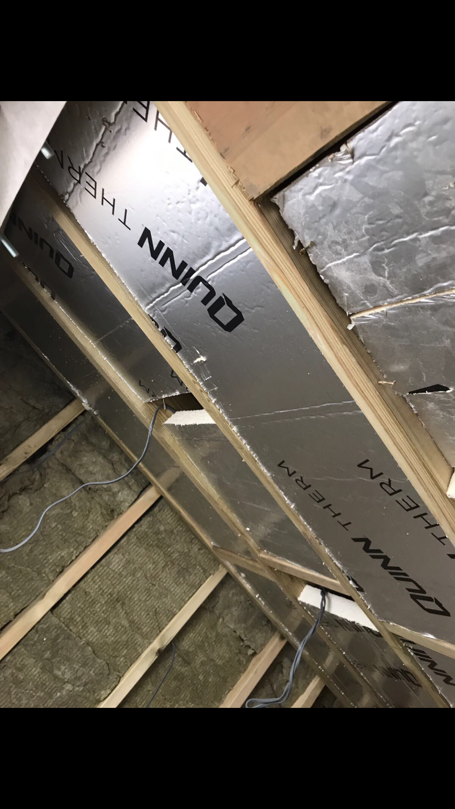

I think they insulated between joists and above but not 100% sure
I’m so over the whole thing and just don’t have anyone to help fight my corner so the banging and sleepless nights continue ‍♀️

also sorry me again did you see the pictures i posted what type of roof covering do I have ?

On a warm roof deck the screws should penetrate into the joists at least 40mm and it should be one continuous screw so on a 8x4 sheet around 24-26 fixings.The boards should be laid brickbond and supported on the edges.
Each board should have a 3mm gap and 20 mm upto a wall and in case of a wooden upstand for a roof light
Again a gap the timber fillet up against the timber upstand should be screwed into the upstand and not the deck allowing the deck to expand and contract.
A vapour barrier should also be installed.
And also worth putting noggins in between joists for extra stability.
