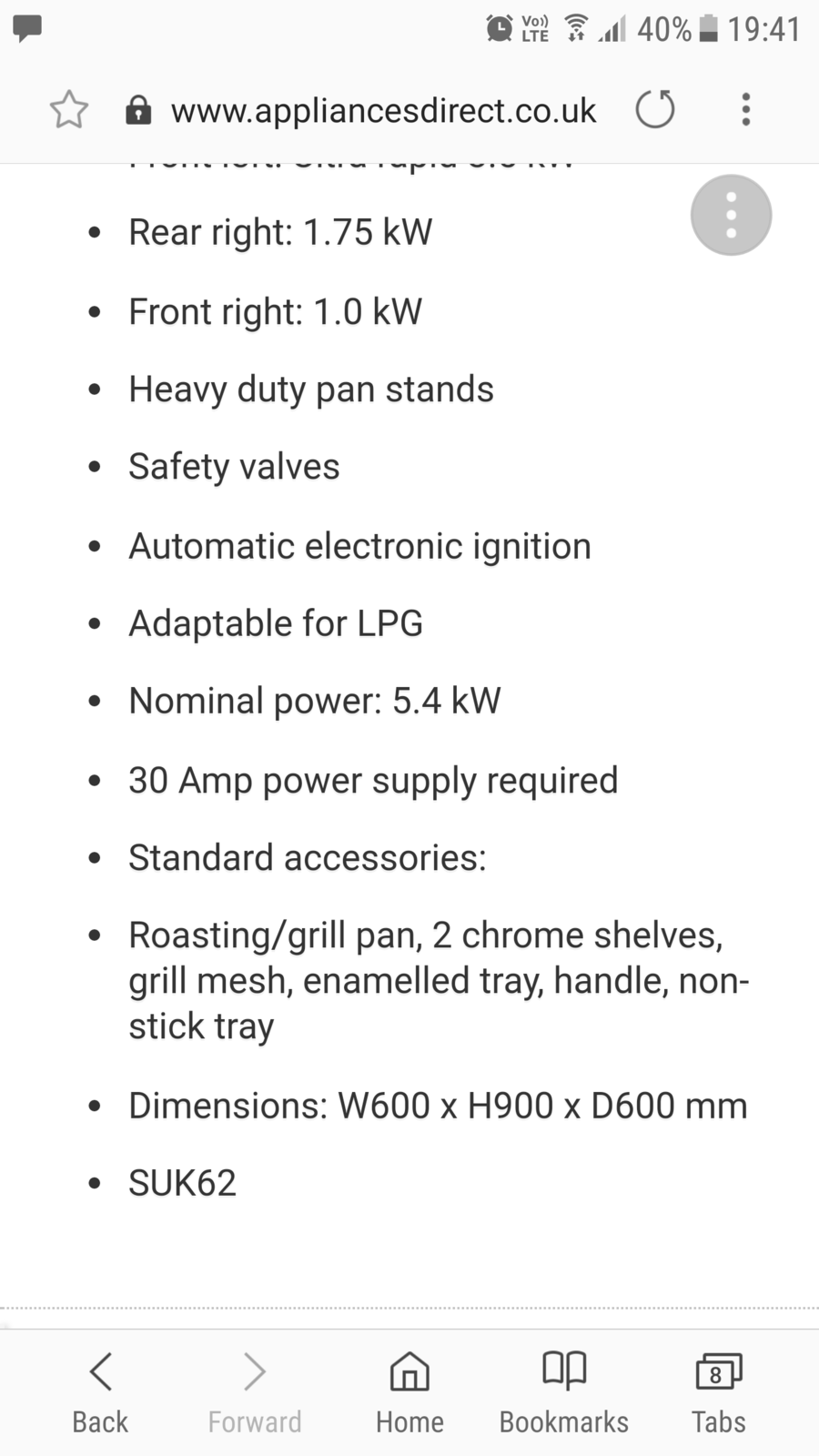

Hi, would this be the value used when calculating the cable size.
Could this be connected to the kitchen circuit
Or a is a dedicated supply required?
"Nominal Power: 5.4 kW
Supply can vary depending on usage, please consult a qualified electrician for ampere requirement"

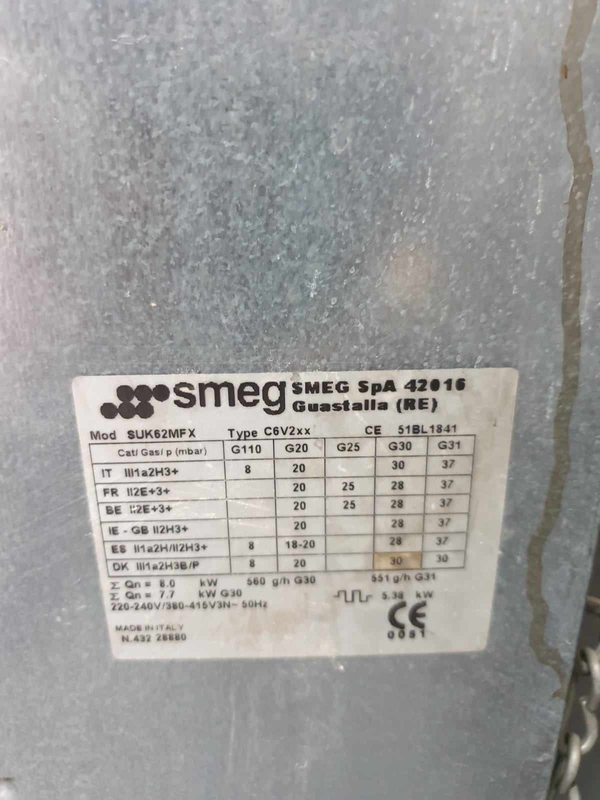

smeg suk62mfx

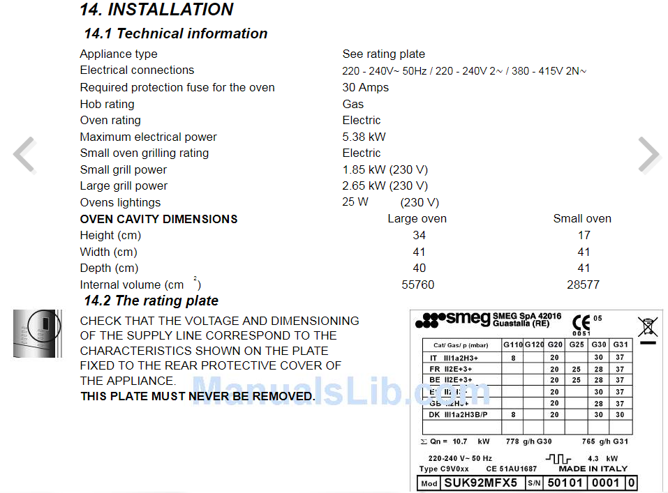

I got the wattage from a manual I found online, but I don't thinks its the exact model having just checked again

Well, to be accurate 5.4kW is 22.5A but they may as well install a standard cooker circuit.

Free standing cooker with Gas hop, i thought the power consumption was the main info.
Any how what do you recommend?

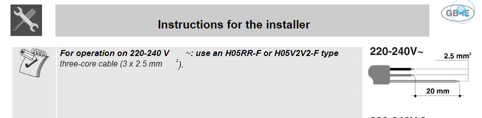

Just found this on the next page -
so it can't have a 30A/32A fuse/MCB with that cable (well it could, but...).

Is there another rating plate or sticker anywhere - sometimes inside the door surround?
If it's a dual-fuel cooker with a gas hob, and a large and a small electric oven, it probably needs a 20A supply, but I don't see the figures for the actual cooker you have in mind.
13A is insufficient for a double oven.
