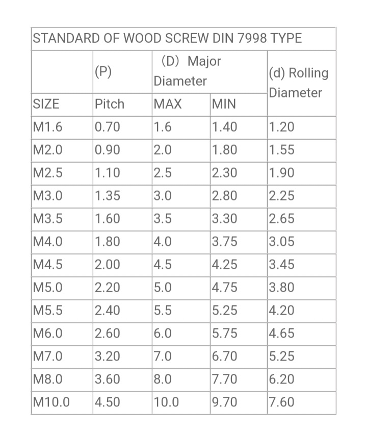

Mean = 3.888mm
Standard deviation = 0.0365
With a 99.9% confidence level, the srew shaft diameter will be between 3.8501mm and 3.9259mm
A tolerance of around ±1%
(4-3.8501) / 4 = 3.75%.
Not quite, although yes, I should have been more specific.
saying that these screws have a manufacturing variance of ±1%, may have been more appropriate.
There will always be manufacturing tolerances when creating screws.
As a 4mm thread diameter is the absolute maximum allowable width, for a 4mm screw - accounting for this tolerance will mean the thread diameter (in this case) will be at least 1% smaller, plus a safety margin.
Standards for wood screws are a bit difficult to find :) - But, just for example, here are some standards under DIN 7998:
With an allowable thread diameter of 3.75 to 4mm for a 4mm screw.
....so, I am guessing my screws have a manufacturing tolerance of ±1% with a design offset of 0.112mm (or 2.8%,
....or 1.8% safety margin with 1% manufacturing variance).
