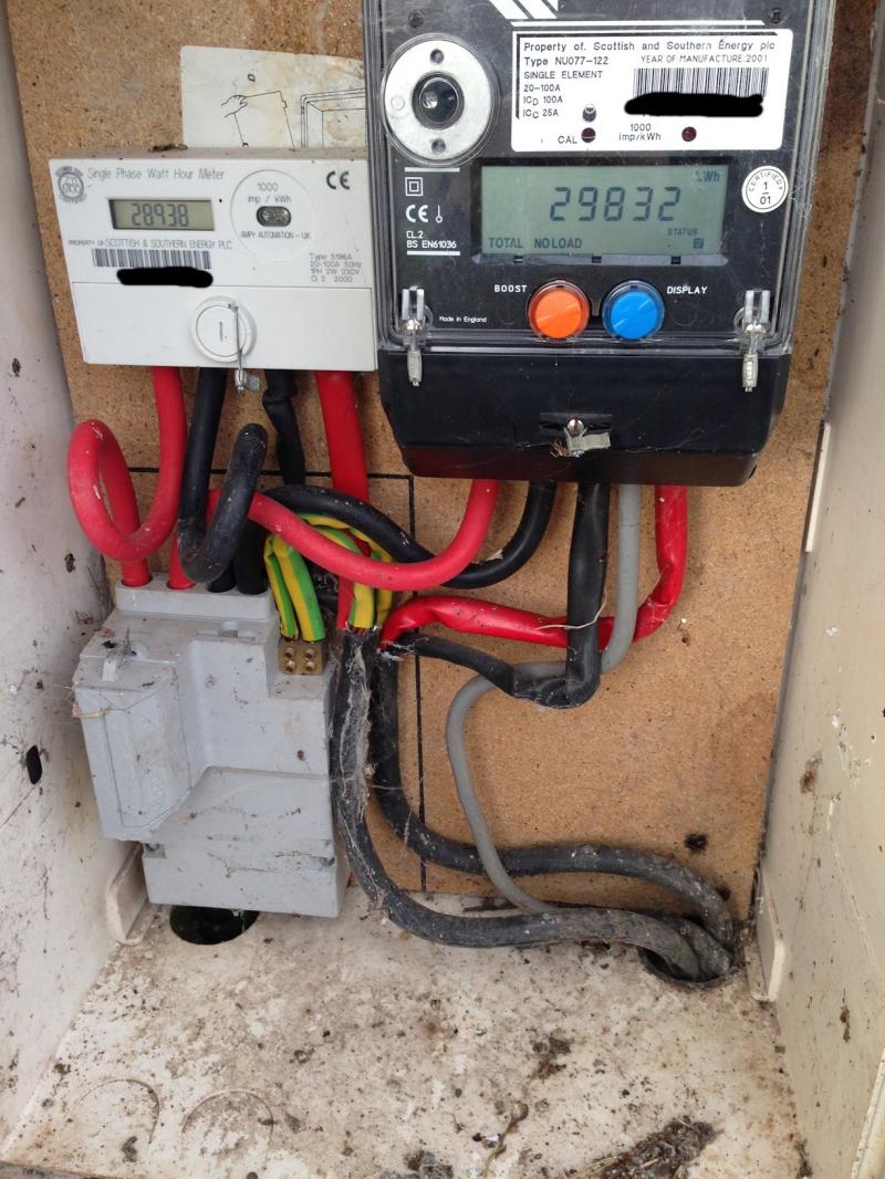

Hi All,
So I am doing a large renovation project on a 1890's cottage up here in Scotland. I have been gutting the place, going to be installing central heating, and having a full rewire, etc.
Now I am installing Internal Wall insulation, and before I cover the wall that backs onto the meter cab, I wondered if it is worth popping in some new meter tails, before sealing. Looking in the cab, I see two black cables going out, I guess one is for the E7 and one for standard rate. I plan to get the E7 removed, and I have removed all the storage heaters already.
Now last time I did a sim project I just popped in some 25mm takes, ready for connection later. These back cables seem smaller than what I am used to.
Also any idea what type of supply this is? is it TNCS?
Looks like TNC-S with split con going away to the two boards. Unusual to have split con after the meter. What is the distance to the consumer unit(s)?
The current boards are directly behind this cab, about 3m in total I would say, 2m up the wall and about 600mm solid stone wall, they run up the wall inside the house, I found them when removing plaster and old lap.

I think it is something like Total Heat Total Control, hence two meters, one for general use, and a dual-tariff meter for the heating and hot water circuits.
We have split concentric not quite from the meter but from a fuse-switch (or is it switch-fuse?) in the meter cabinet. Ours goes separate tails from cut-out to to meter, separate tails from meter to switch then concentric to make it's way to the CU in the house.
Maybe normal practice in rural NE Scotland? Is this cottage served by it's own transformer from overhead 11kV?

a read of this thread would suggest that in this case with similar circumstances earthing is TN-S
So is it ok to leave the current concentric in for connection to new CU?
Main fuse is 100A they just seem rather thin compared to 25mm tails I usually use.
Thanks, they seem to have sleeved the concentric cable at the meter, is that normal? I guess it is split concentric cable then? Equ to 25mm tails?
