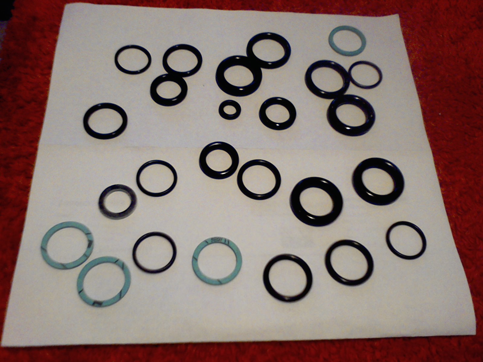

In my experience the seals and washers supplied with boilers are not the thickness and diameter you find in standard high street packs. Really the guy should have sourced genuine washers and o- rings specifically for the boiler rather than just buy a pack of assorted ones
Also agree that if he uses the right size washers there will be no need for ptfe or other things. However if it's an old boiler he should deffo clean the thread and nut of the joint with steel wool or similar before tightening
The boiler man was unable to buy just the two o rings needed and had to get a complete set for the boiler, the pack clearly states that they are for a Ferroli boiler. The boiler is only five years old and I watched while he cleaned the o rings but they still wouldn't seal. Only at this point did he use sealant so that I could use the boiler.

pic one sample of the o rings

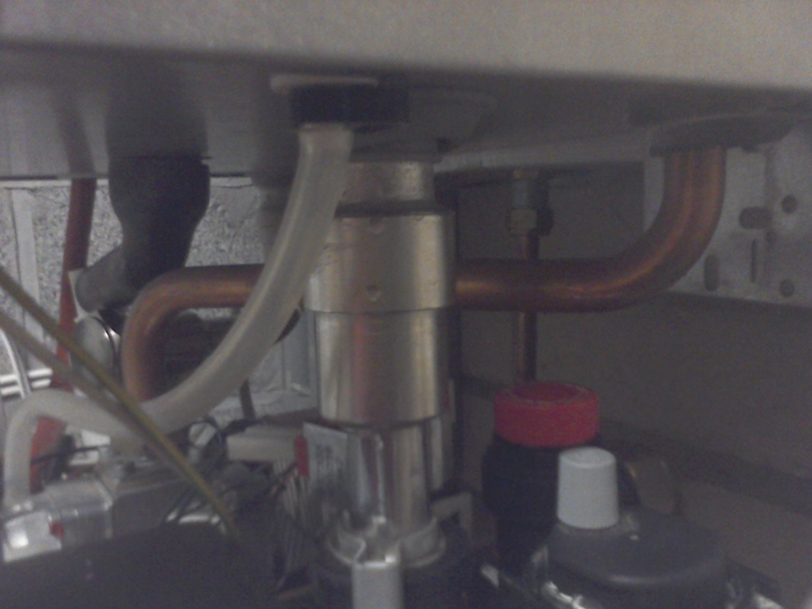

pic two leak area is on the silver cylinder behind the black pipe this is the one covered with the opaque rubbery tape

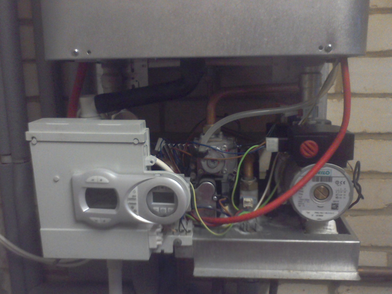

pic three the silver cylinder in front of the copper pipe leak is from the visible o ring above the section directly in front of the copper pipe

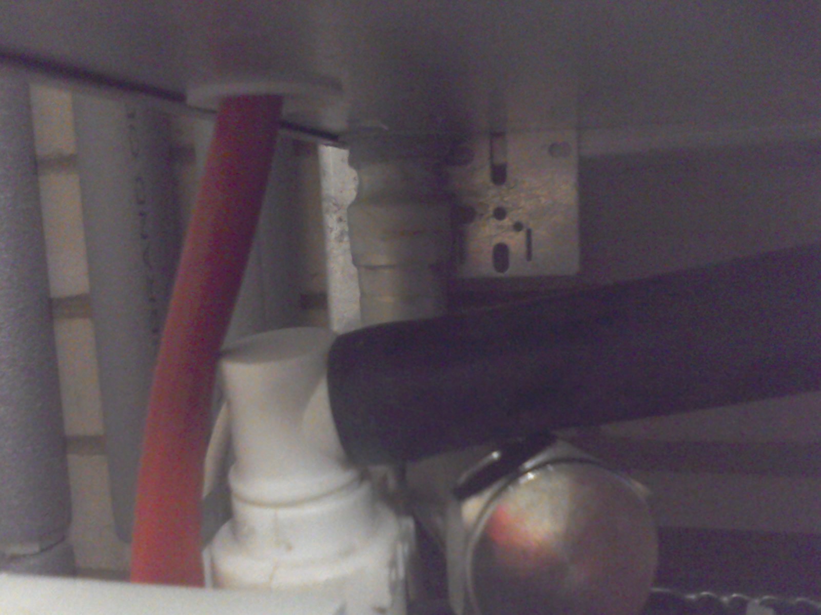

pic four is boiler from the front

Pic two shows where the leak is as I am not qualified to go near a boiler I would not tamper with it but I do know that is the problem on pic three you can see the water drops clearly below the black o ring there are two both in the middle of the centre silver cylinder one just under the o ring and the other a couple of centimetres below
Well I think one of the joints in the sealed chamber is leaking (the pipework in there are usually joined by clips)... the leak is dropping down and appearing on the silver pipe (but that's not the source of the leak).

The area above the two o rings in both cases is dry
If your gas engineer had taken that silver cover off the front of the boiler then he would have spotted the leak (assuming the system hadn't been drained). Wait to see what Dan says... because although he can be a bit rude, he does know his stuff probably moreso than anyone else on the forum.
