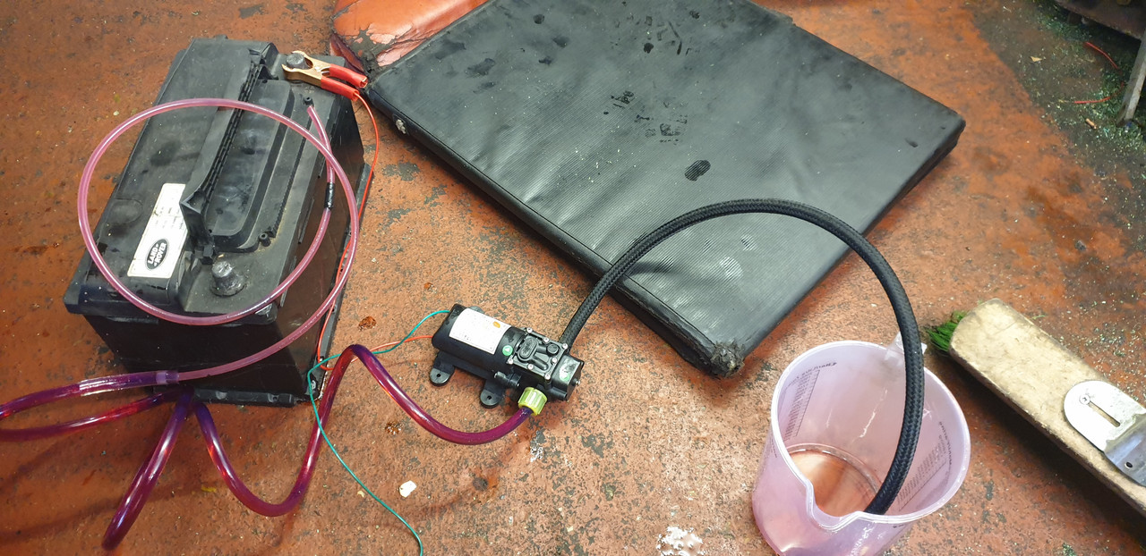

I use a manual vacuum suction pump if the car has a muck cover fitted and the oil filter is also accessible from the top. I bought a 12v pump to fill the auto gearbox oil on my Evoque from underneath when I did a partial drain and flush. Got through 20 litres of auto fluid.
