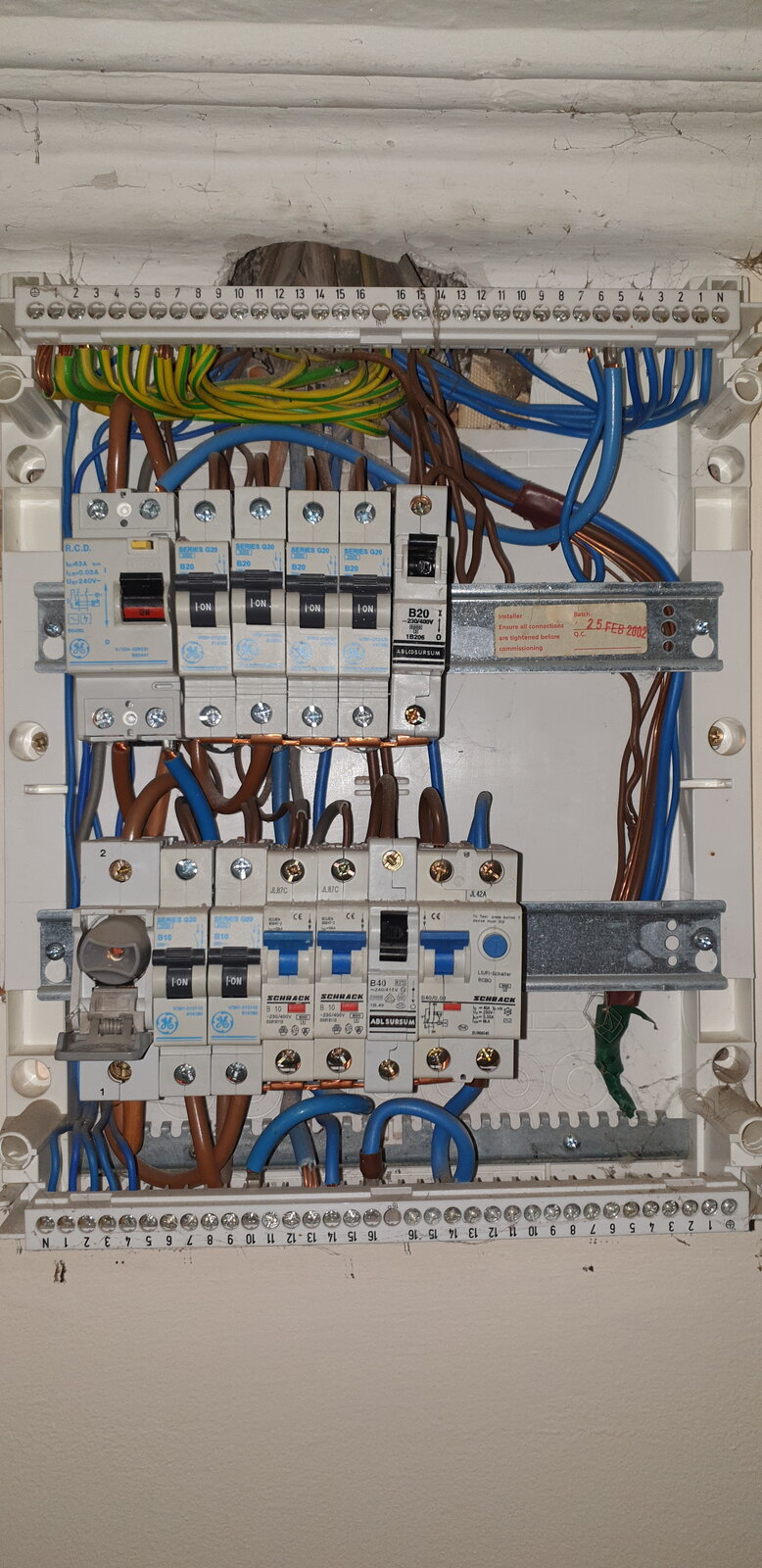

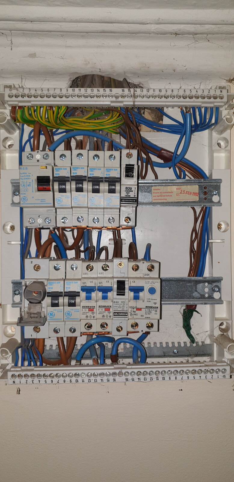

As promised. There's no room for another B20 on the top rail unless the busbar was extended.

So it looks like some of the appliances could be moved on to a new 20A there, hopefully stress free. FrodoOne, are you sure it would need to be a RCBO? Wouldn't a usual Type B single pole suffice.

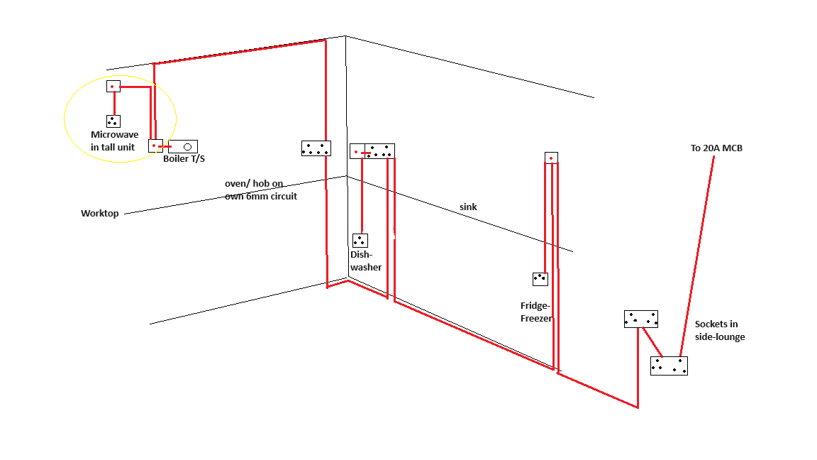

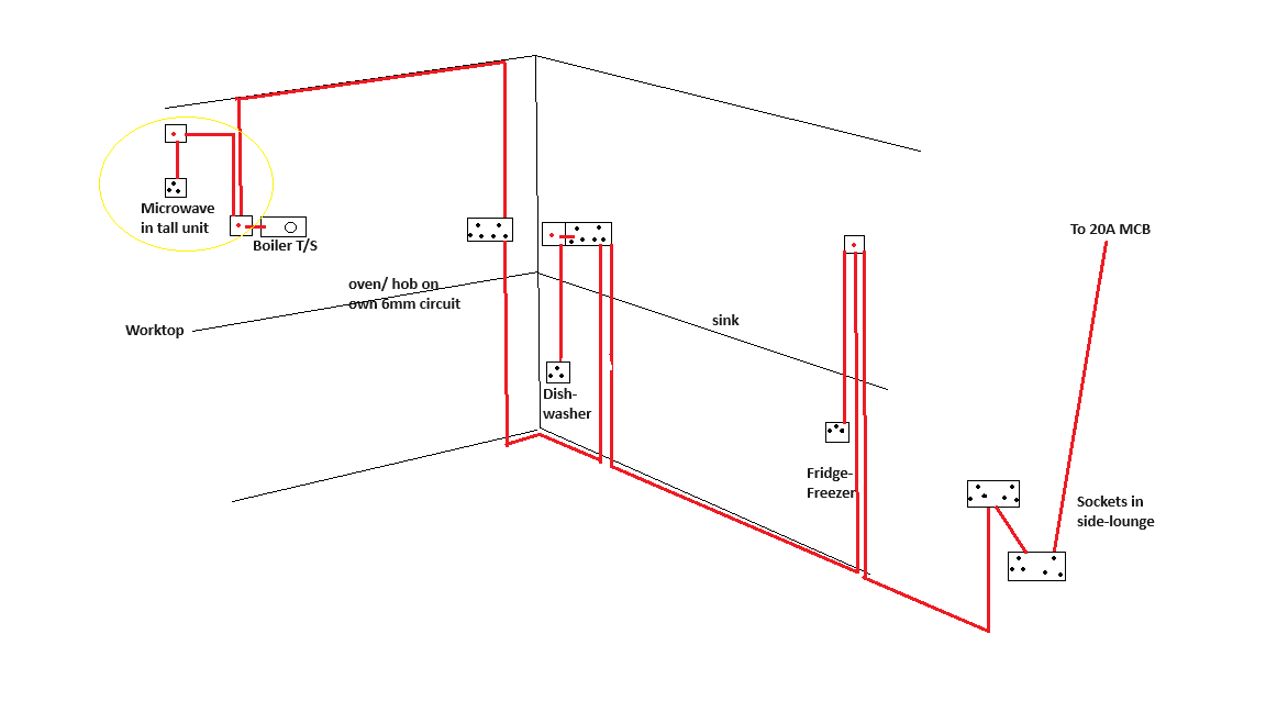

Hello Everyone,
I just want to make sure I'm ok adding this new socket for a microwave.
I plan on putting in a single socket on a 13A fused switch and linking it as a spur from the existing radial circuit. It will be in 2.5mm2 T+E, running from a circuit which is protected by a 20A circuit breaker. The cable will be run in surface trunking over tiles vertically and across in to a cabinet, all sealed safely. On the board, it shares a 63A RCD with four other 20A fuses.
I have attached a diagram showing what is already on it.
Thanks for the good sketch and pic.
To my mind the most obvious thing to do is run a 2.5mm² cable from your new Microwave FCU back to the consumer unit and convert it into a ring.
Install a new 32A RCBO in the vast spare space which is not on either of the existing RCD's. It wouldn't matter too much what make as there is already a selection of devices in there.
That will also reduce anxiety about the size of the RCD.
However I'm not there and cannot see the routes or difficulties involved.

Future proofing in mind two radials would be best I think, but splitting it is another matter. I'd say keeping the fixed appliances on one circuit is best as you wouldn't want a kettle tripping the boiler! Probably fridge, boiler, dishwasher, internet router, extractor hood, and maybe microwave on one 20A, and then worktop sockets would be on their own 20A. I guess we could pull out the units from under the worktop to access that cabling when the time comes.
Are you actually in the UK? That‘s definitely not a typical UK consumer unit.
I‘d strongly recommend replacing all the non-matching MCBs, the bus bars don‘t fit and that could definitely cause overheating.
