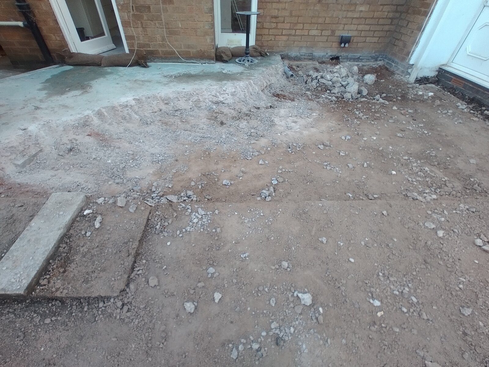

Old conservatory base built nearly to damp course

Made more progress on removing the base today.
Switched to the sharp tool (for the heavy duty breaker) and generally it does seem more effective. Although in places the concrete containing shingle is literally so hard that the breaker just drills a deep chisel shaped hole in it without it cracking.
Can anyone advise which bit fitting for the breaker will be best when I get close to the house?
Also could the vibrations of the breaker affect the rear house wall when I get near or will it only impact the concrete slab which the breaker is in contact with?
Have only been up near the house wall in one tiny area so far and to be fair the concrete did seem to just drop away fairly neatly.

I was using the wide chisel on day one which is when the last photo was which explains the dust mentioned. Switched to the point today, day two. Hope to post another photo tomorrow.
I estimate this concrete in the middle of the base to be 400mm deep I reckon so it's quite grueling.
The patio slabs underneath, which this conservatory was laid on, do not go all the way to the house. There is approx 600mn closest to the house which seems to have been poured onto hardcore over soil, and this is where white bits are found in the base (look like pieces of plaster of Paris or china cley!).
You need to try and break down to the bottom. If you can undermine - even better. We tend to chomp a chunk off from above, then drop the point onto the chomp and angle the breaker inwards and split a chunk off the bottom.
Been doing just that today. The job is a killer though, it's just so deep it's unreal. Nearer to finishing than starting but if can't get it done for end of play Tuesday when breaker is due back will have to carry on with it the following week for a couple of days. The stacks of rubble alone seem to be about 4 times the volume of the actual conservatory, probably because there's air between the boulders. And when breaking to the bottom, after about a depth of 5 inches has been removed from the working line, you have to rake and remove the rubble to have space for new breakage to go and to make sure you're down to the bottom. It is quite possibly deeper than a road in the worst part of it I believe.
When I'm sitting on the sofa late evening I literally feel like my whole body is still vibrating from hours and hours of it and taking so long!

Carrying on today....
I have actually found some large rocks under here within the concrete.

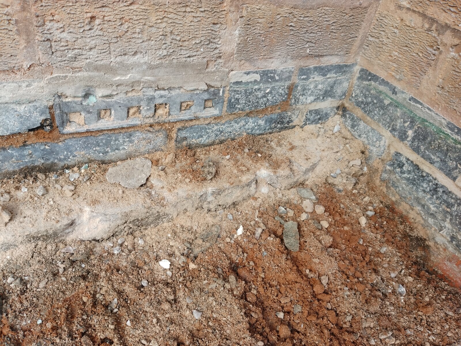

Can anyone tell if this is a row of bricks laid up flush to the rear wall of the house and what it might be for? Are the bricks structural to the house or are they likely to have been put there when this conservatory base was constructed and is it safe to remove them?
Note: there is also what seems to be another row of bricks set against the row you can see, just under the soil towards the camera. Again, not sure why?

No seriously, have a dig with a trowel and see what's what. There's probably just soil under them and they're not attached to anything. They're unlikely to be part of the house.

Where the airbrick was cut though for an air pipe, you will see underneath the damp proof bricks that the bricks are red. Should these be exposed or is it best to keep the new ground level above the red bricks?
Ground level should be six inches/two brick courses below the DPC. More is better. In your case it looks like the blue bricks will be enough, I think the cheaper red bricks were not intended to be seen. Are you near Staffordshire, or a canal? Staffy blues are a very fine brick.
The six inches prevents rainwater splashing up and wetting the wall.
Also, in good clean brickwork, damp will not easily climb more than two courses, due to pore size difference between brick and cement mortar obstructing capillarity. This is why "rising damp" does not usually happen.

The bricks beside the house look to my eye like brick footings. Scrape around and under them with your trowel before smashing them out. Usually found in older houses, or old builders, brick footings extend wider in the ground to spread the load of the wall and should not be removed. If they are loose, they might have been an edging for original paving, and are at the right level.
So is the key that if the trowel goes under them then they can be removed? If it won't they should stay? The house is from the 60s and canals not too far away.
