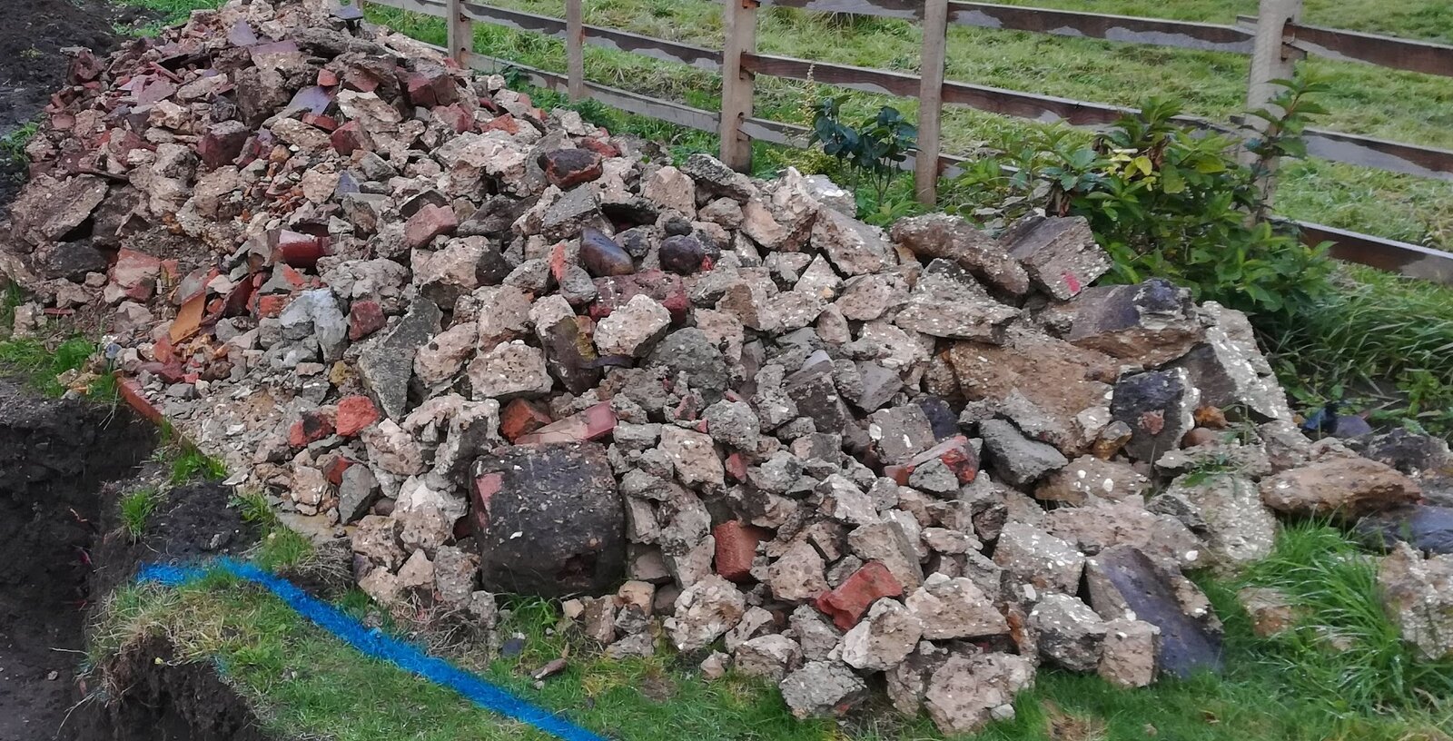

Bit of a small batch the last time, this took less than half a day but still worthwhile...
Before (only some of)...

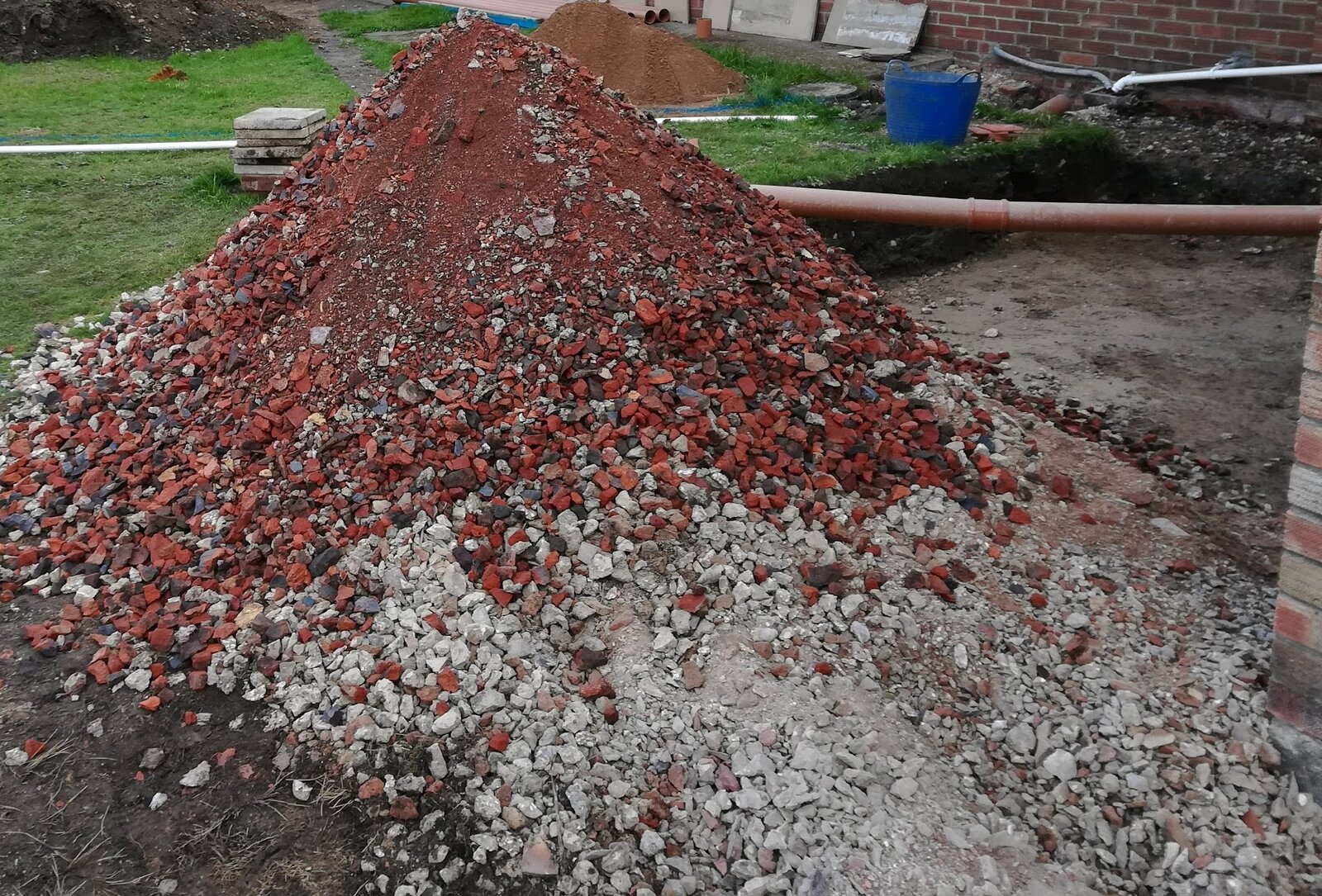

After...
Made dry mix concrete with this lot for under paving. Mixed with a bit of cement in the mixer (with ear defenders!) then compacted in. You can also wet mix with sharp sand/cement or just use as-is in compacted in like MOT Type 1 or whatever. Not frostproof, especially if there are bricks in it, but absolutely fine for use under something else.

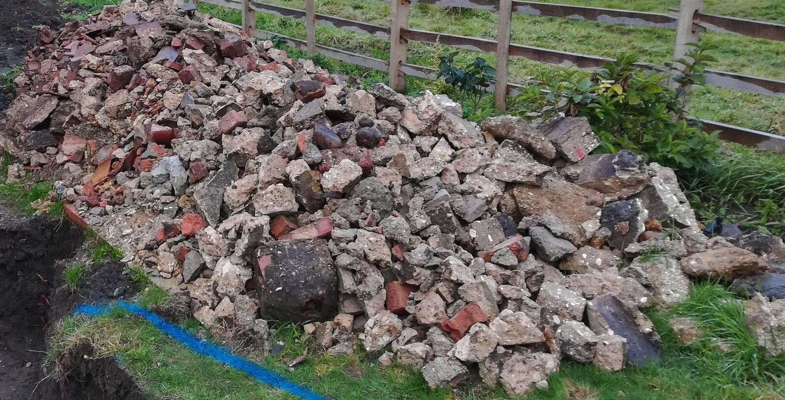

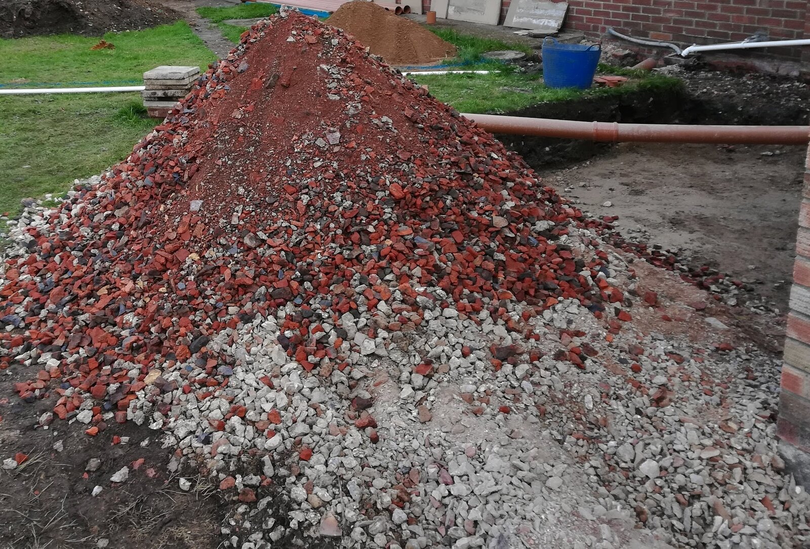

After...
